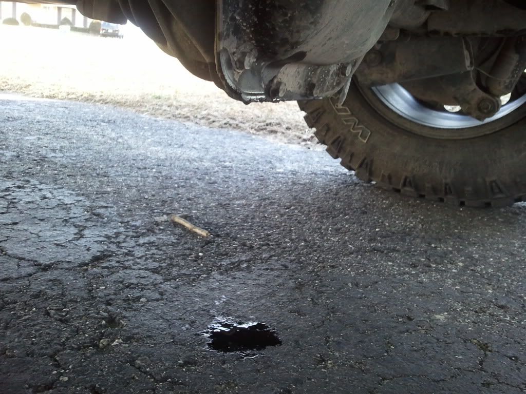

I used to jack from the bottom of the pumpkin but now I have a 4xguard brace on it and won't be doing that again. When I changed out the diff fluid, I could tell that repeatedly jacking from the pumpkin will definitely lead to a leak of some sort. Sure maybe if your careful, but I definitely ended up seeing some red rtv after jacking it fr there a bunch of times. I'm staying clear of there from now on.
