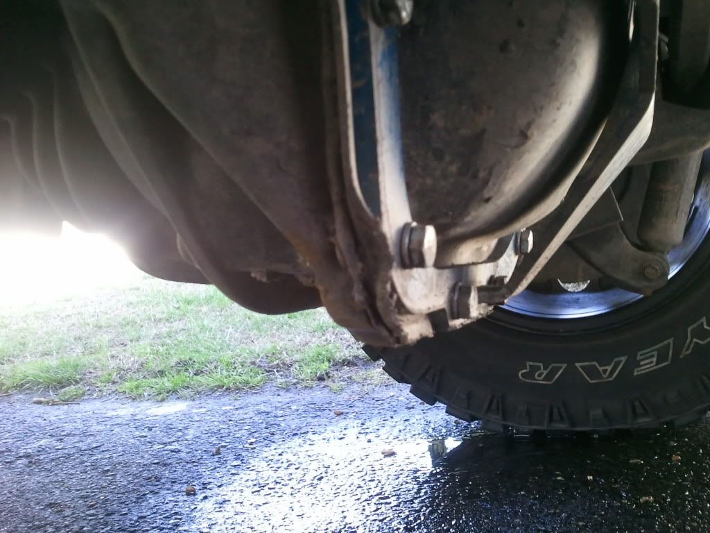

The stock WK/XK differential cover is thin & weak and protrudes about 1/8" below the case. If you're not careful you'll end up with a leak.
Jack from wherever your heart desires. I dont mind spending an extra 20 seconds and just using the shock mounts.

Those who generally ask for basic maintenance advice don't always have a lot of wrenching experience and may not realize there's other precautions that need to be taken before just throwing a jack under the differential.
It doesn't take much for these covers to leak.
Now that I see it I agree, in Stock for I wouldn't jack from the differential, not because of it hurting the axle but that cover
Exactly.
And just an FYI, that was a rock
I'm much better protected now
Still waiting for someone to make a complete 12-bolt diff cover. Right now theres only guards on the market; but a few good options for the 10-bolt guys
Even in stock form -
The lip of that cover doesn't really overlap the housing flange. If it does just file it back - especially if you're gonna wheel it.
Trust me - the pad of a 3+ ton floorjack fits under the 8.25 just fine w/o even contacting the diff cover.
Exactly.
That spot is what got me and I replaced the rear cover with a Solid.
