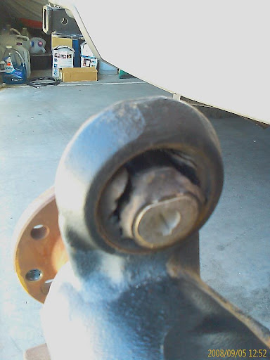

I'd crawl under there and take a look around. This thread describes my issue and has a picture for reference. As I said, I know many times a bad bushing will result in a hard shift. Maybe it's not too far gone???
http://www.jeepforum.com/forum/f67/h...ft-r-n-824555/
My bushing was on top of the diff. Number 14
