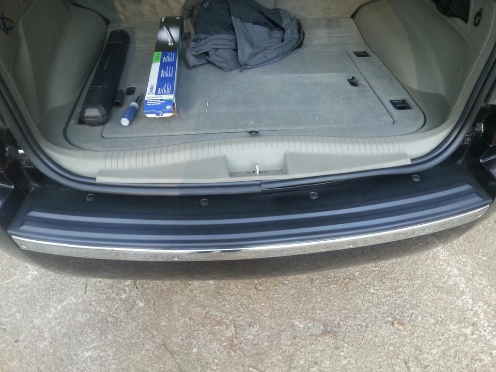

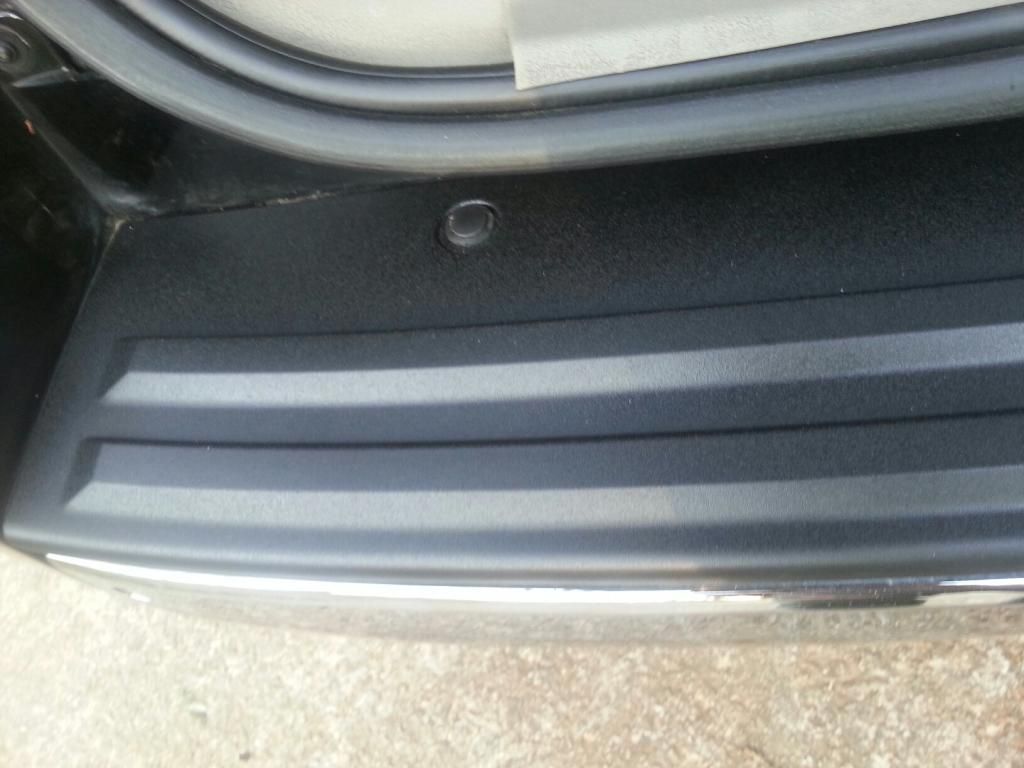

My rear step was blotchy so I bedlined it.
No after shot. It's black and looks the same.

Looks good, Im gonna have to do that soon. Mine is looking a bit faded.
Your interior color is nice. I like the black look on all the plastics. My limited is mostly the light tan on all the plastics.

Also bedlined my rear step, Was pretty sun dried and nasty.

^^^^great idea for the rear step pad! I might have to do that!!!!

It's extremely easy, just pop the push pins out with a flat head and pull it from the pins in the bumper. Wipe it down and spray two even coats of bedliner. Only drawback is the cost $7.47 for the can.
