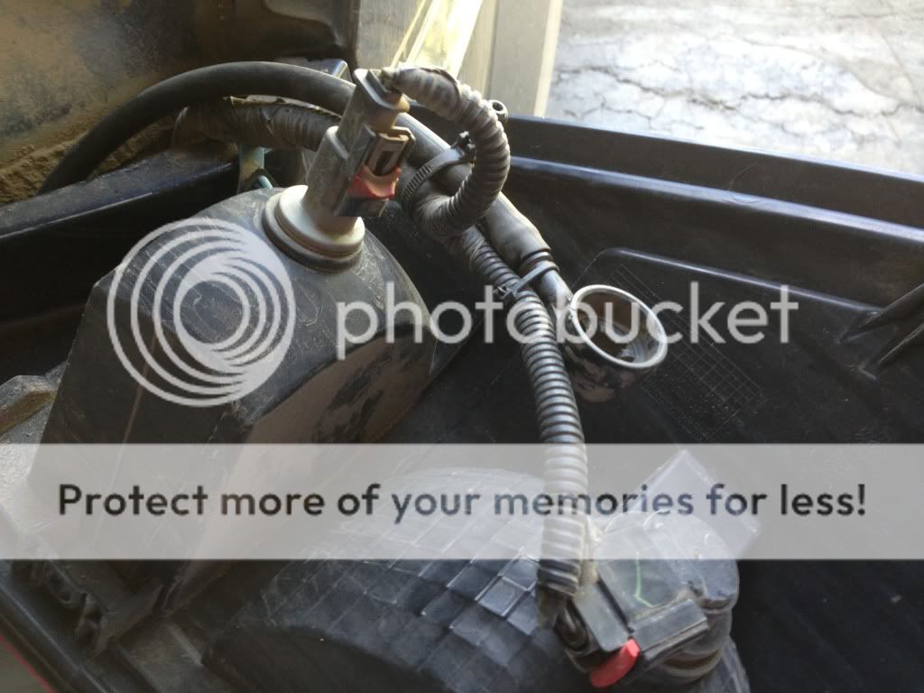

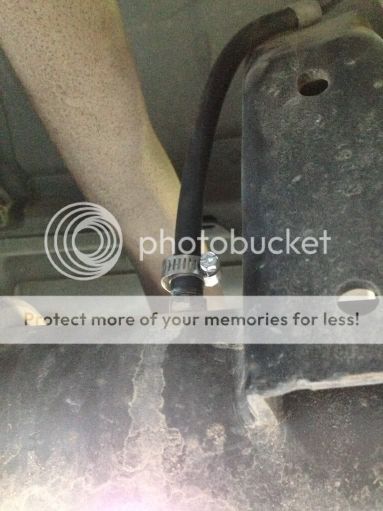

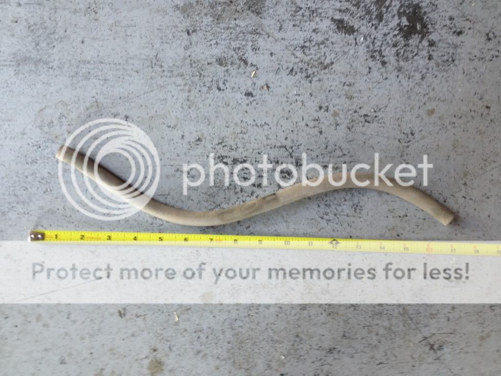

Extended my rear diff breather. 6' of hose and a hose clamp.

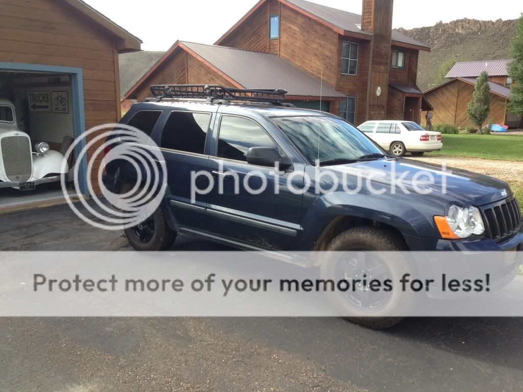

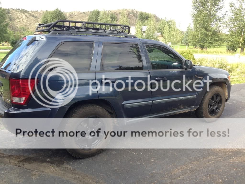

I also plast-dipped my rims.
Put the old cap on the new hose. Ziptied into the right rear tailight housing.
Here is the old hose. It only runs up to the rear floor level. Seems like a bad spot to me.
Pretty simple project with more peace of mind off road.

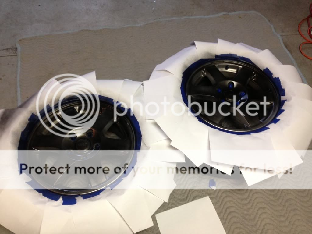

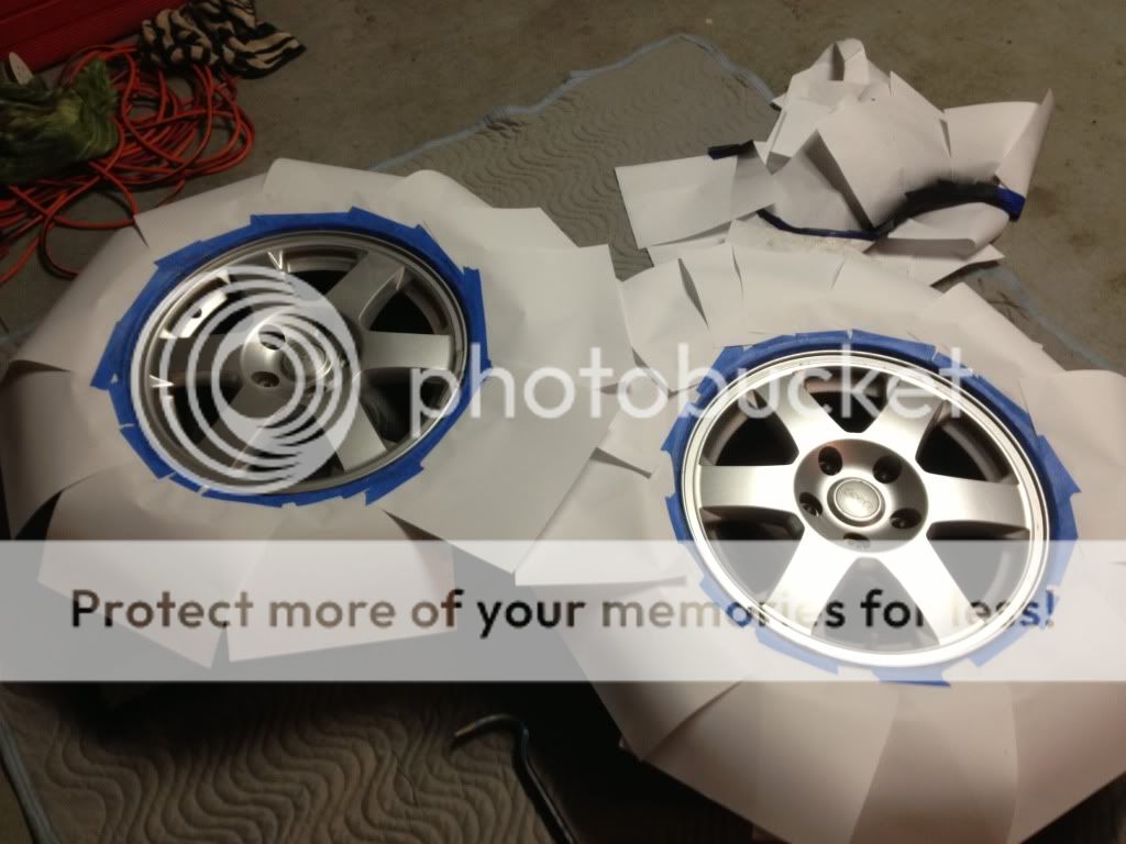

Plasti dip prep. I used copy paper and blue tape.
I did 3 coats 2 hours apart. It dries really fast and smooth. Great stuff.
Turned out good!
Black trim will be plast-dipped next. Maybe next days off. The manning brothers are playing today.
