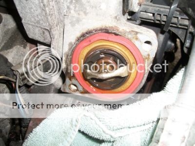

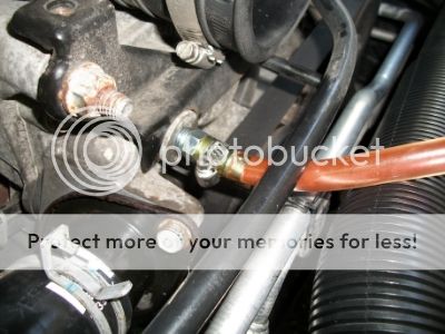

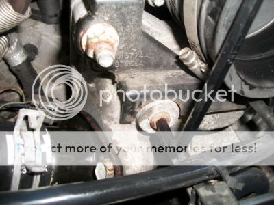

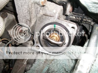

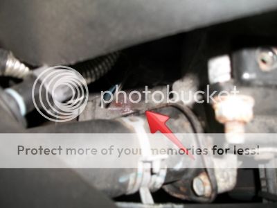

Repaired coolant leak.
There appeared to be a slight coolant leak at the thermostat housing area.
Gaskets on the original t-stat were chewed up a bit.
I replaced the thermostat and upper radiator hose.
Found the coolant bleed hole and bled the system per instructions in FSM.
No more leak!!
(Sorry these photo's are so big.)
