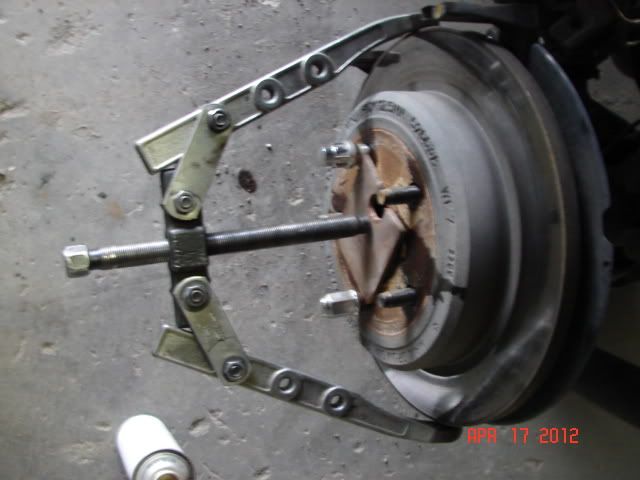

Hey jeepers and jeepets I recently purchased rotors and pad from Kolak and I know lots of you have too so my questions are has anyone done a quick write up on the install and I'm sure it's pretty sure it's a straight forward instal. Thanks for any help provided

Should be like a normal brake job

There is a little rubber plug in the back of your rear brakes, pop that out and there is an adjustment dial you can get at with a flat head screwdriver to release the tension on the e-brakes.
Then I had to get my rotors off with one of these:
