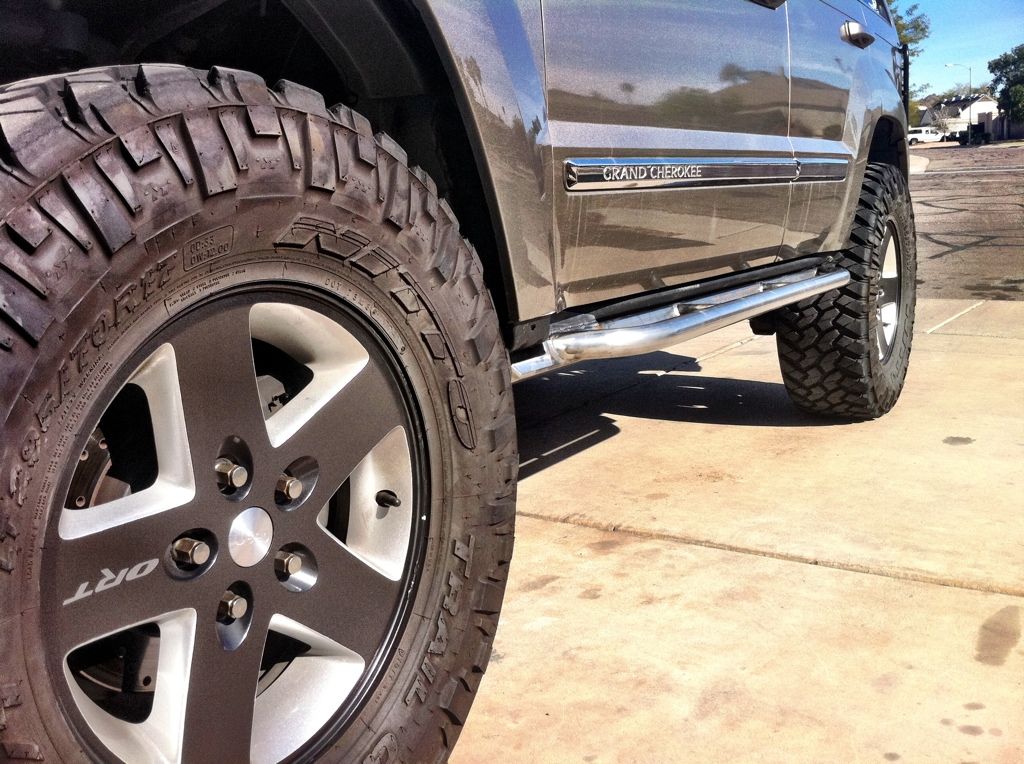

Omlet - what is the upside vs the 4xguard sliders other than a step I guess?
Basically just the tubing. The 4xG are great rails and they definitely look cleaner than these, but they do not provide any door protection. They are super strong and provide excellent ground clearance and rocker protection, but when you are on a side slant with a rock or some kind of obstacle at your side, they don't quite cut it. These SA sliders have the tubing that protrudes out an additional couple inches that will help repel obstacles a lot better and give much better door (side) protection. Kind of like this:

I see what your saying Nathan. I guess the clean look is what I'm after. At least for now......

Ya I love the look of the 4xG rails and they were great for a while, but the more I push this thing the more protection I need.

Why not just weld a tube on the side? Do you think it wouldn't be able to handle the angular force if a rock hit it?

That was my plan until I got a deal on these! If someone already has the 4xG rails then that is the best solution, but if they don't then their option are open to either or.

Yeah they look really good - I cannot wait for mine to arrive. I will end up painting mine. Haven't decided on black or Graphite.

Nice! The only problem I was having with the idea was the tube size and how far they would stick out. The rails already protrude a little farther than the doors, so to have a 1.5" or 1.75" tube bend out from it without protruding any farther than the tires, would be interesting. The SA rails have the 2x4 underneath the doors so the tube can come out a good couple inches before it has to bend down the side and come back in to the 2x4.

Ya baby!!! I with they were aluminum so I didn't even have to paint them, but I am bedlining mine just like my rockers.
