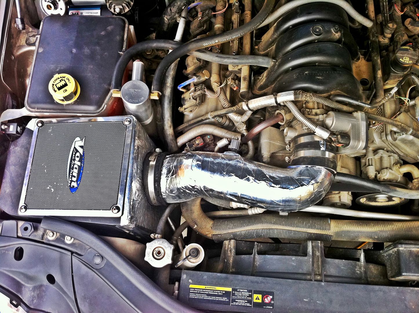

Your build thread was the reason I went with the volant...do you remember what length of tubing you had to buy? Or did you just buy a couple feet and cut it to proper length when you put it on?

I bought about 3' and cut it to fit once I got home. You could measure before hand. Measure from the intake manifold port to about 4" past the TB (that is where the new intake port will be). You can see it here:
