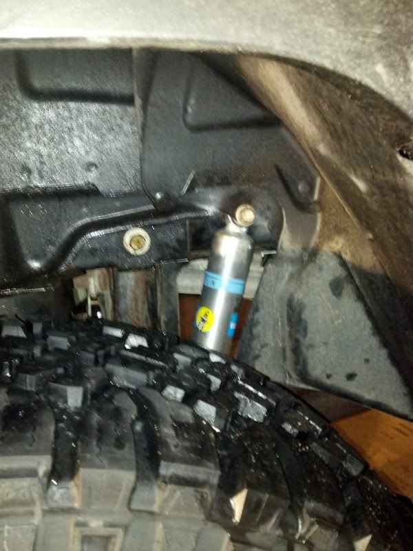

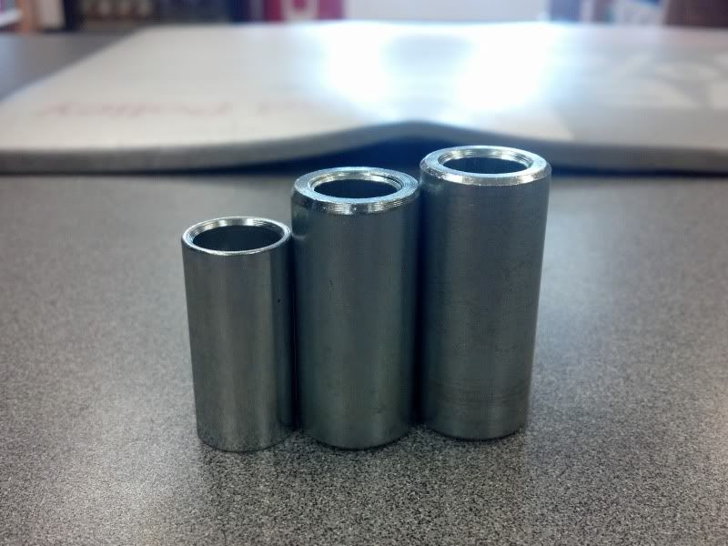

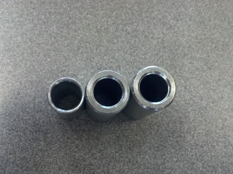

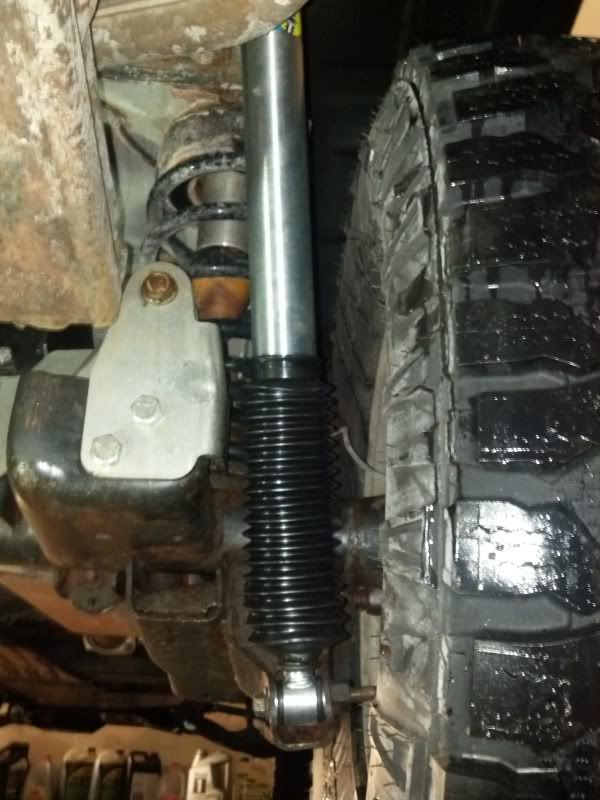

Haven't done too much lately but did get some nice 29.7" long Bilstein 5125's for the rear. The bushings sleeves are considerably more narrow than the SL/stock shocks. Solution -2 washer on the bottom bushing, 3 washers on the top, and a good impact to drive them home. They ride super nice!
Bilstein/SL/odd SL sleeve

Ohhhhh...look how shiny they are....
