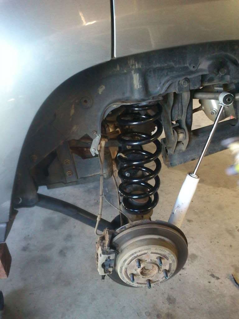

Also go the new rear springs into the Jeep, they are thick, hand rolled and tapered. Couldnt get the progressive, but these seem to be good so far. Coil free height is 500mm.
We also removed the SL preload plates from the struts and replaced the isolators. Flexed it around a bit, still have to get some limit straps for the front, and some 14" travel rear shocks. Max ext length on the new shocks is around 820-830mm (33")

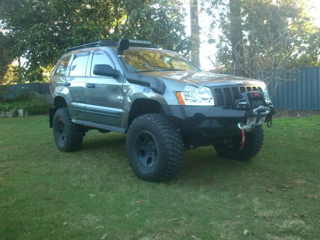

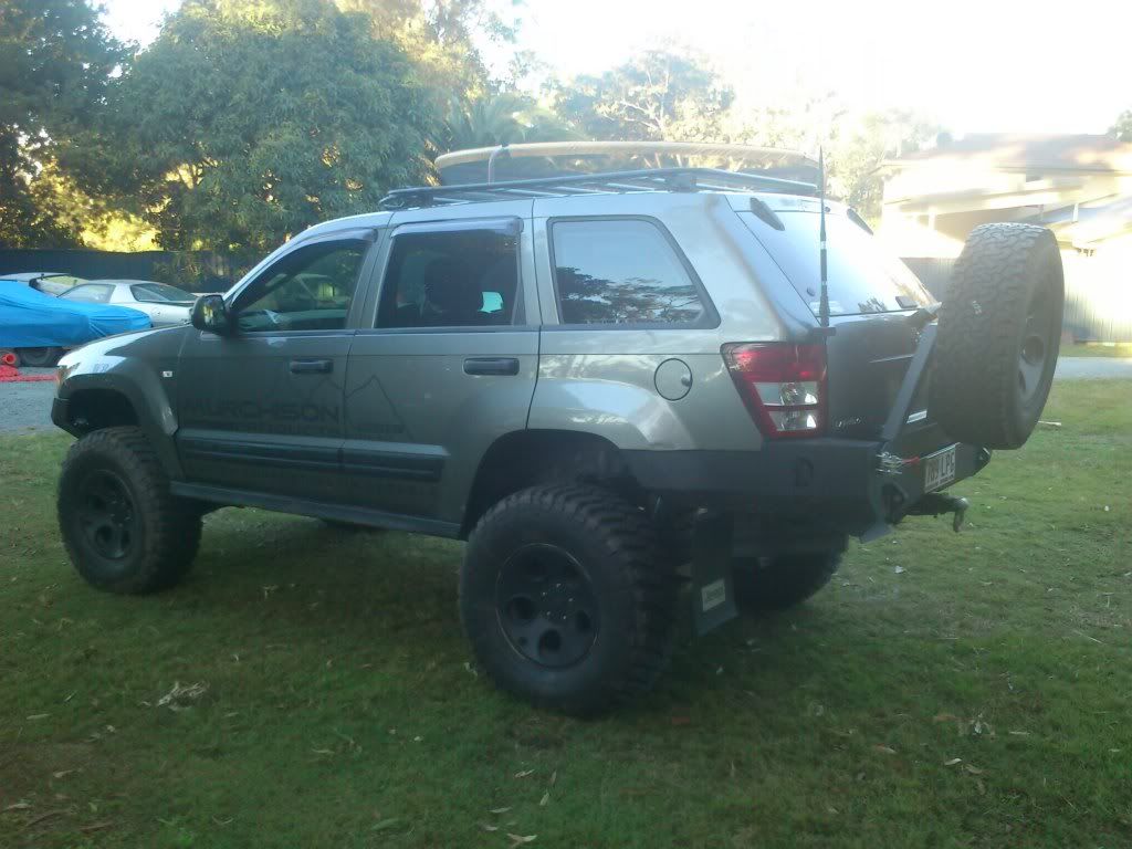

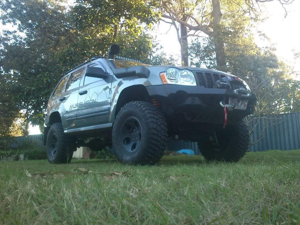

Couple of craptastic photos from this afternoon (lost the camera, these are phone shots). Have put around 200kms on it to settle the springs.
Now the wait for the shocks, they are 14" travel (830mm extended to 475mm compressed), remote cannister, adjustable shims for valving, 200psi nitrogen charged, 360 deg swivel end. And put the bumpstops in, which worked out to be cutting the SL ones almost in half and then mounting the cups and rubbers.

Damn Dave that thing is nuts what are the overall lift and tire specs as it sits
2006 Black wk overland HEMI QDII. OME HD bilstein struts with 58643 monroe load levelers RRO uca, afe cold air intake,hella 500FF behind grille, RC 1.5 wheel spacers s4xc cb antenna mount with 5ft firestik and midland 1001wx CB,265/70-17 falken rockymountain ats, pinch weld mod, door lock mod, Rola basket with 2 Hella 500 FF`s.
06WKHEMI is offline
post #55 of 305 Old 06-25-2012, 05:19 PM Thread Starter
Valpacer
2007 WK
Location: Qld, Australia
Posts: 601
Overall lift came in at 6" front and 7" rear. 35" KM2's for tyres.

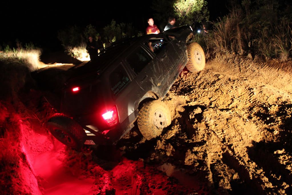

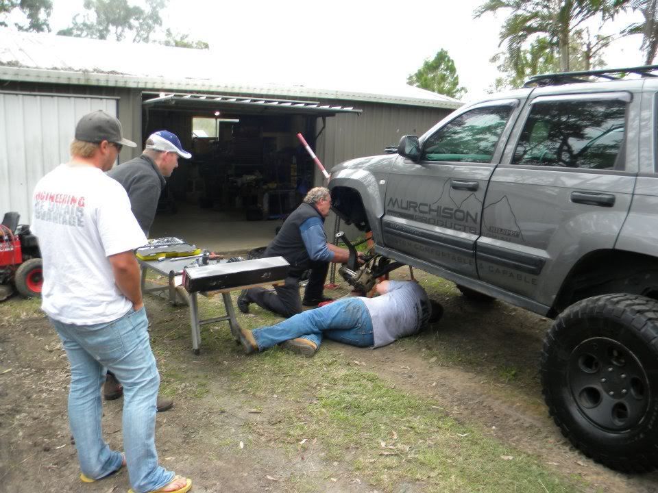

So what happened here:
Or was that before the trip?

Originally Posted by Omelet View Post
Very nice Dave! Nothing like taking the easy trails, but the hard lines
Ah, yeah had to change out the cv, had a split boot. Lucky i carry spare CV's for each side! Was before at the toolbox day. Im even wearing my Ultimate Jeep shirt!
