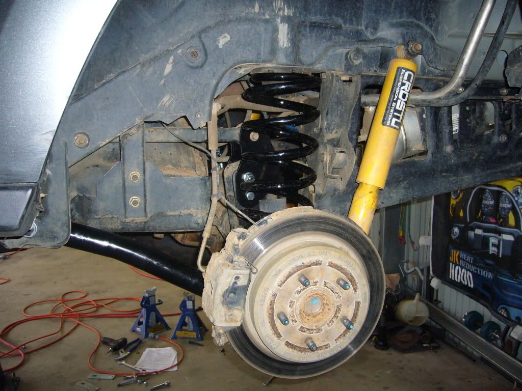

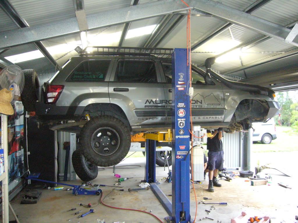

Got the rear fully boilted up, using the SL springs and old shocks. The old shocks (whcih are already longer then the OME) were perfect to mock up the new ride height level
ANd no, the shocks in the last post were not for this, they are off a prerunner style JK being built. And cost more than the whole kit each!
Removed the 31" bighorns, and got a hold of a set of 35" BFGoodrich KM2's. Thats better!
Out for its first flexing.
SO we made up some 70mm spacers for the rear, to get the height correct. These are being replaced with some custom springs to take the weight and with a progressive rate to give some extra coils for down travel.
The front already had some extra HD springs, but with the SL strut preload spacer it put too much strain on them. The Preload spacers will come back out, which will also reduce the angle on the tierods.
Measurements ended up at around 6.5" of total lift. Once the new coils are in and the front is set it will end up being around 6.25".

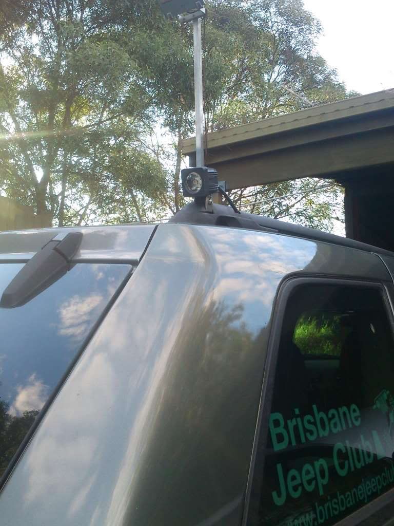

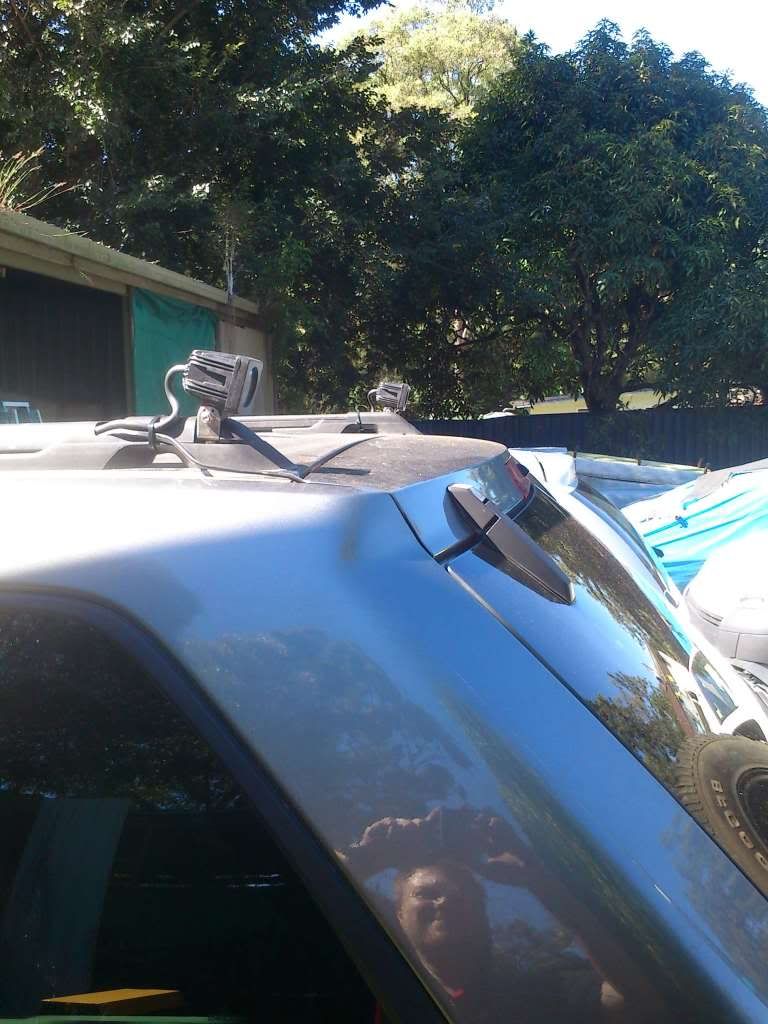

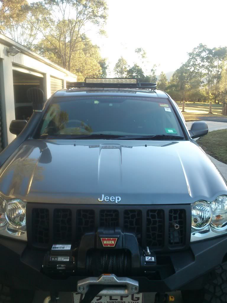

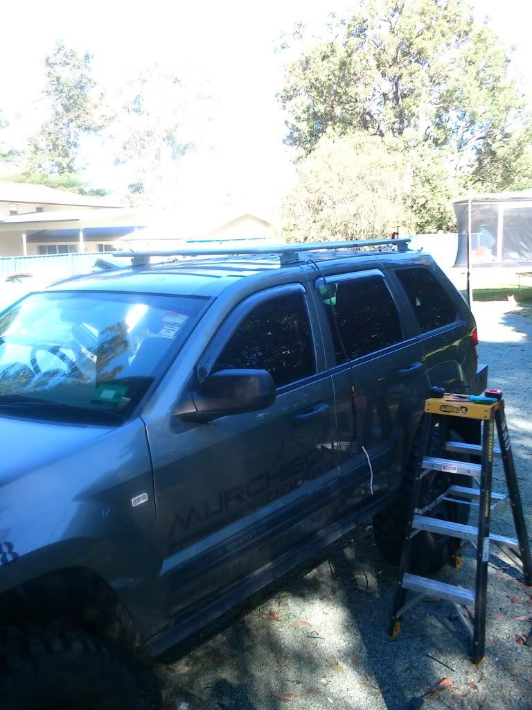

I decided to remove the roof rack at this stage, mainly to clean the look up a bit and also to not make it look TOO high. Thats only for the locol police, as where I am we cant lift a 4wd by more than 2" or increase tyre size by more then 1/2" diameter. Which luckily the Jeep came factory running 34.5" tyres .
Fitted the factory rails back on, and a couple of single 10W Cree LED fittings to the rear instead of the large ones the rack had.

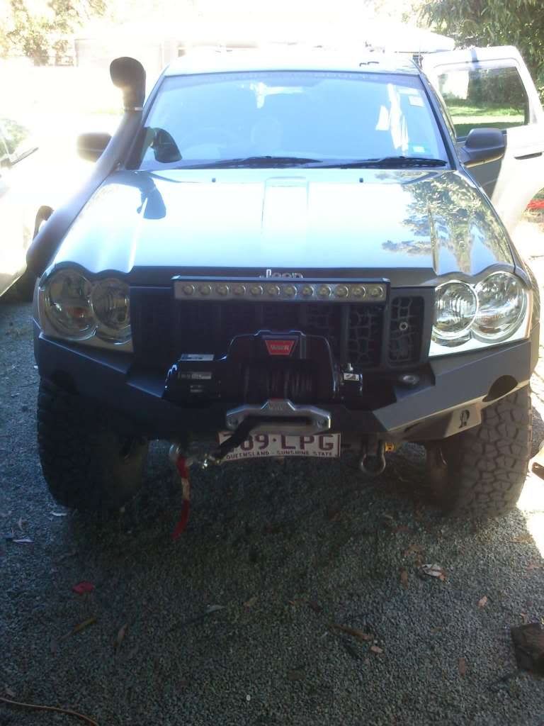

Relocated the Light bar to the front grille.

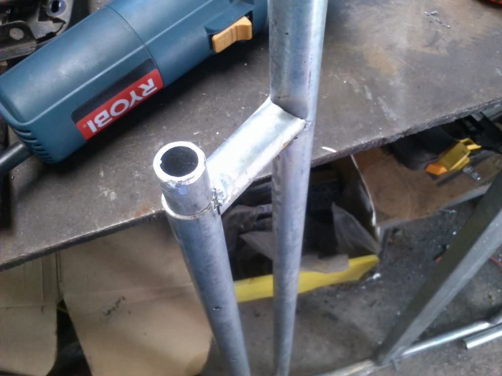

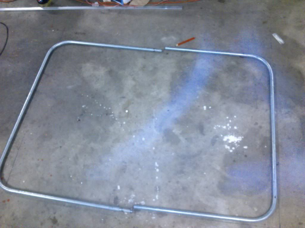

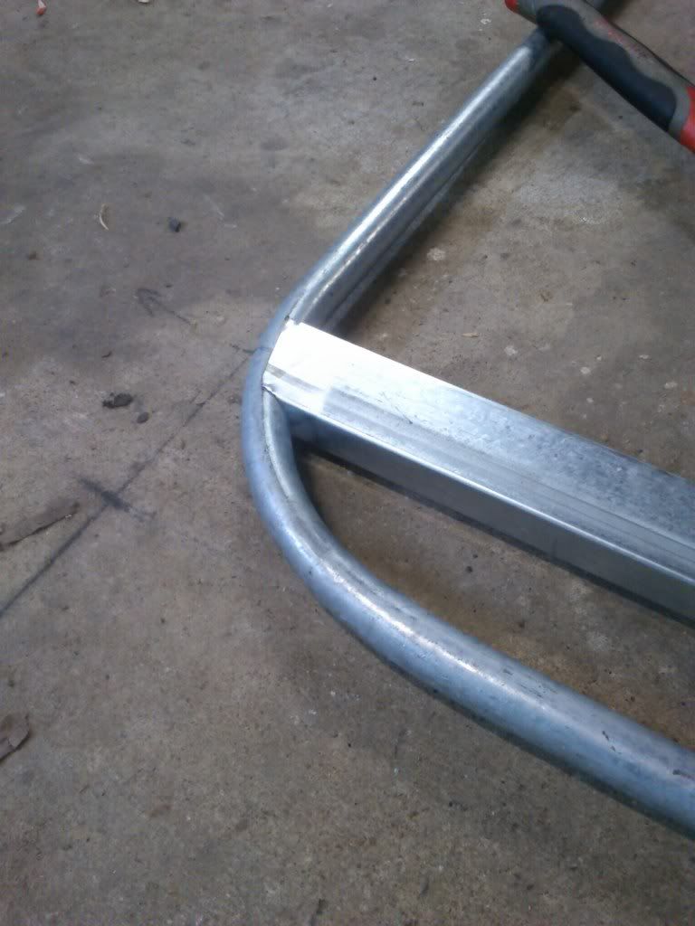

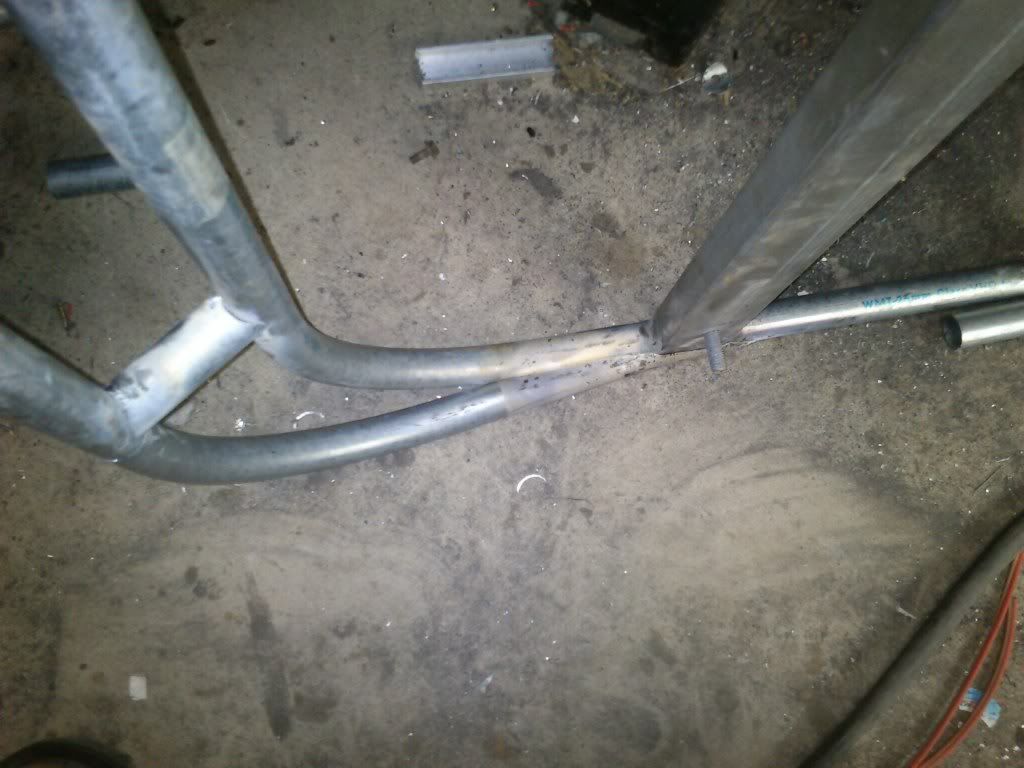

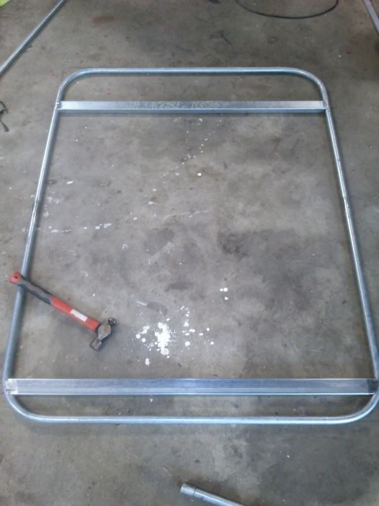

And in the meantime I have been working on a new rack, which will be a single layer with low mounts (no higher than the factory side rails) and let me get the light bar back on the roof, and be there in case I need to carry anything.
Using some 25mm (1") tube, and some 25x50mm rectangle for the mount sections.
There are more pics of this on my 'Time for a new rack' thread.
And now i just need to complete the mounts for the lights, and some smaller tube for the wiring to run in. At the moment it weighs just 6kg, instead of the 24kg the old rack did.

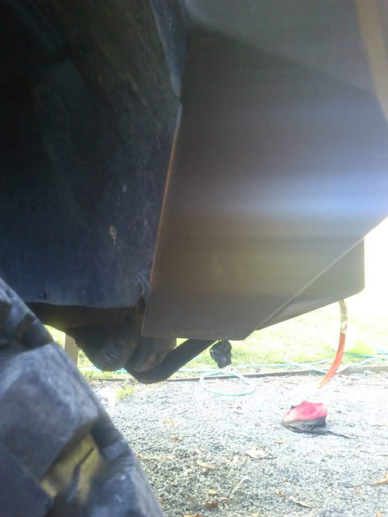

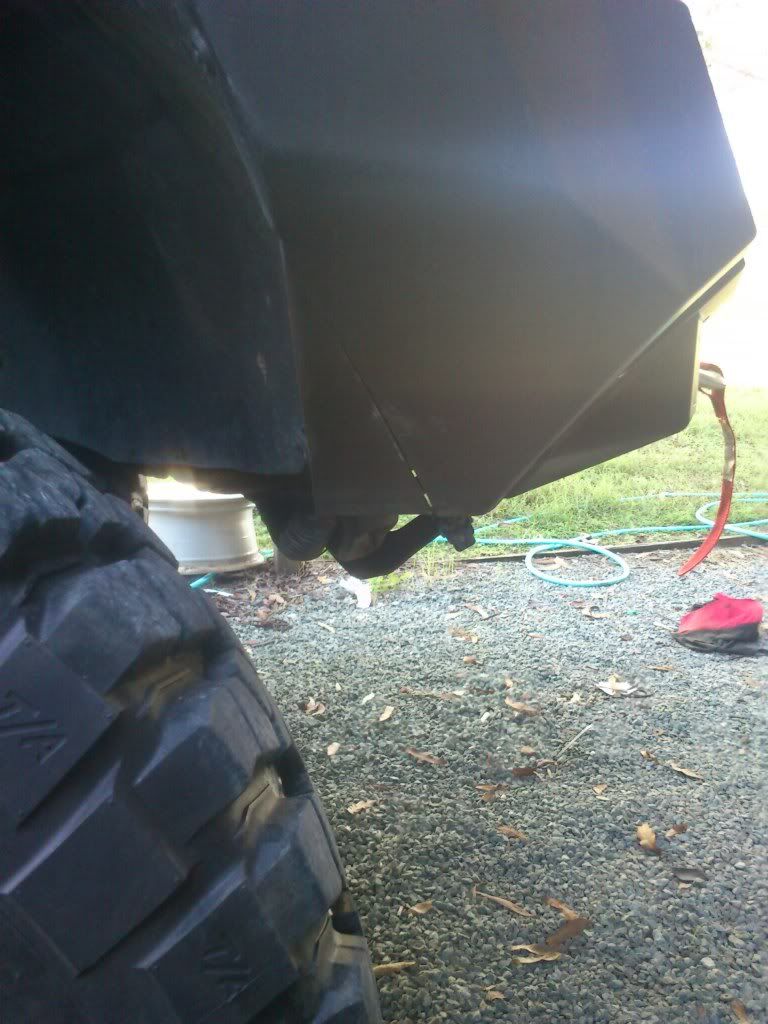

I had to also make up some rear mudflaps, as combined with the lift and the saguaro bar, you can see almost the whole tyre from the rear . Another thing the local police dont like.....
6mm rubber, and a couple of pieces of 15mm sq tube. Also had some Stickers left over, so while the paint was drying I cut up some ally plate and made the logos. And some socket head stainless bolts. Bit blingy but Nathan will be proud!
And 2 pins with R clips for quick removal.
Once i have the extra rubber on the guards sorted to cover the extra tyre width, i may re-jig these to match.

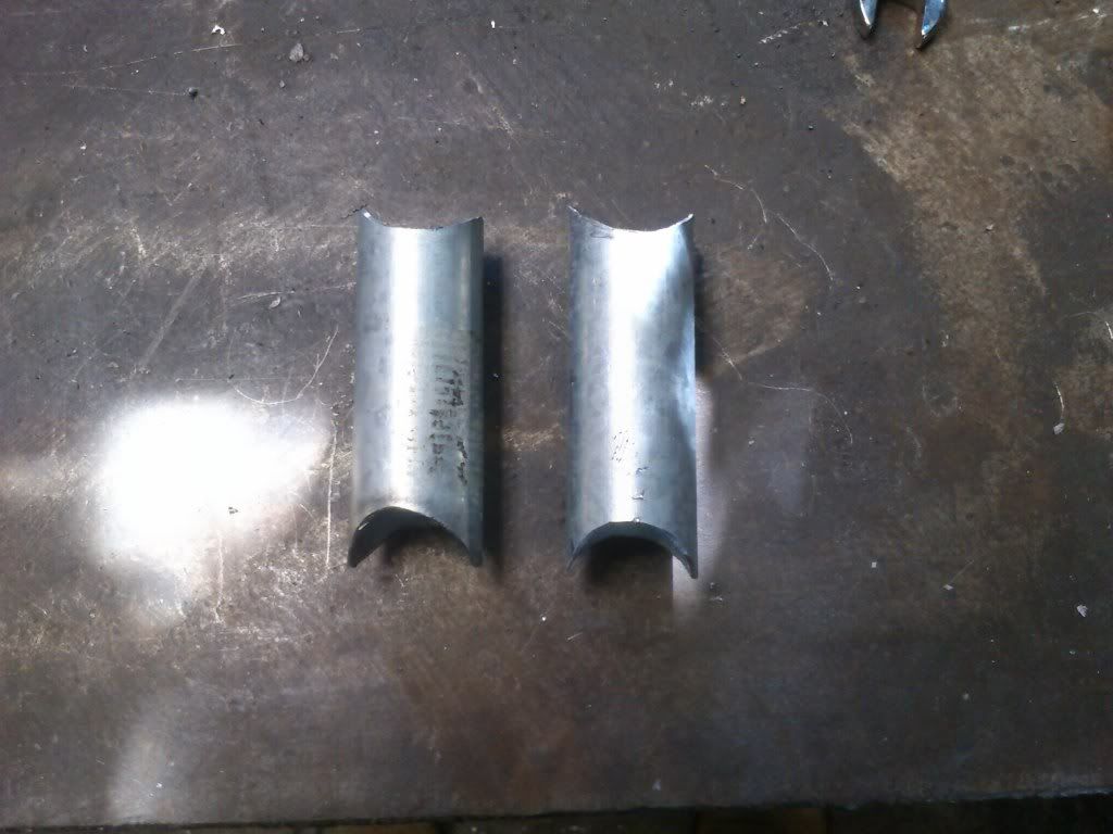

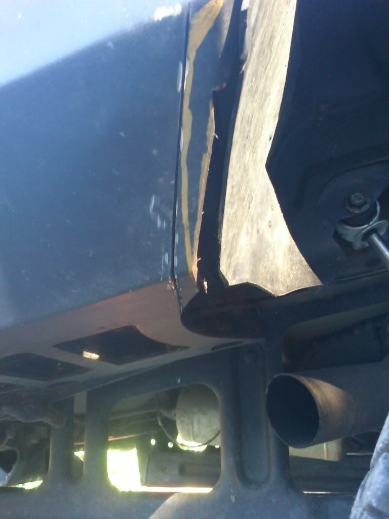

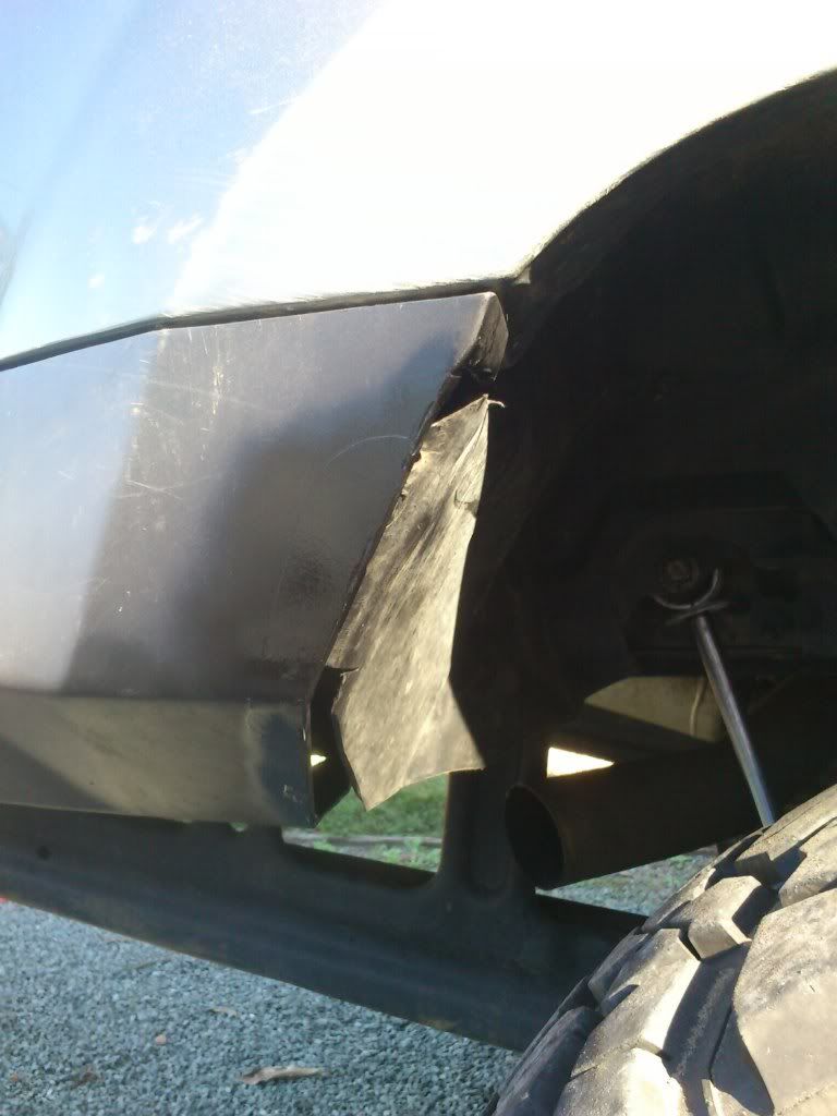

In order to get the full flex out of the 35's, i had to do a little 'trimming' of the Saguaro bars. The paint is just to keep the rust away, once its all finished they will get re-powdercoated.
Before - Front Bar (sorry about the exposure, phone camera)
During
After.
Rear Bar. During.
After.
There is still a few bits of the actual Jeep to trim in behind, but with this i can get the 35 all the way into the guards, well as far as i could the 31's .

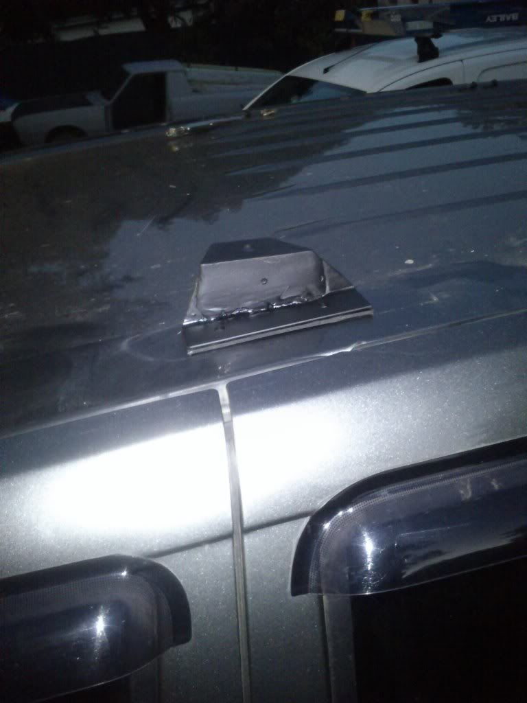

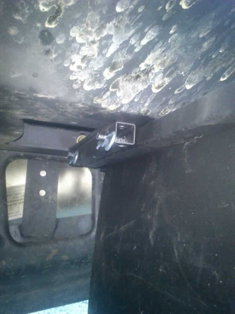

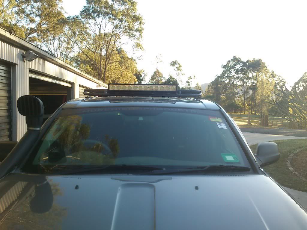

Did some more work on the new roof rack today.

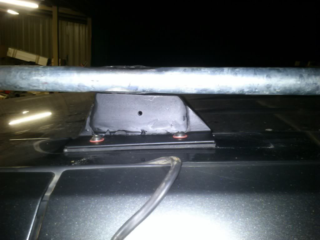

Got the bracket bits on the roof, sat the rack on top to mark out.
So got the brackets welded up at the right angle, trimmed and painted. Of course the wire feeder started doing its ferarri impersonations again so the welding is very average. It will do for now.
Used some 3mm rubber under the mounts (trimmed holes the size of the nutserts in the roof) and some black socket head capscrews with fibre washers to try and keep the waterproofing of the roof.
This is the new location of the rear LED's, off the mounting brackets.

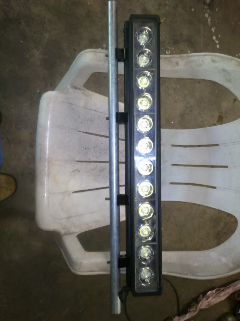

Then it was time for the front light mount. Unfortunately my cheap light bar has an average mounting design, but this should be able to suit whatever i go to next.
Hopefully ill have it all welded up and painted by tonight.

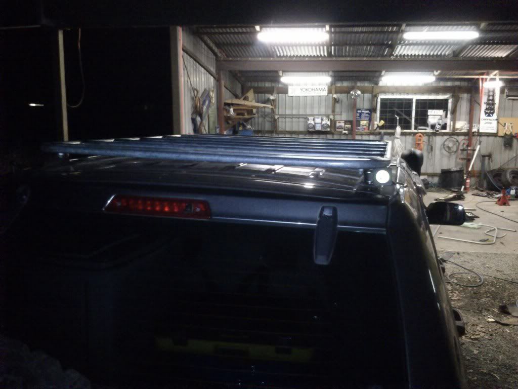

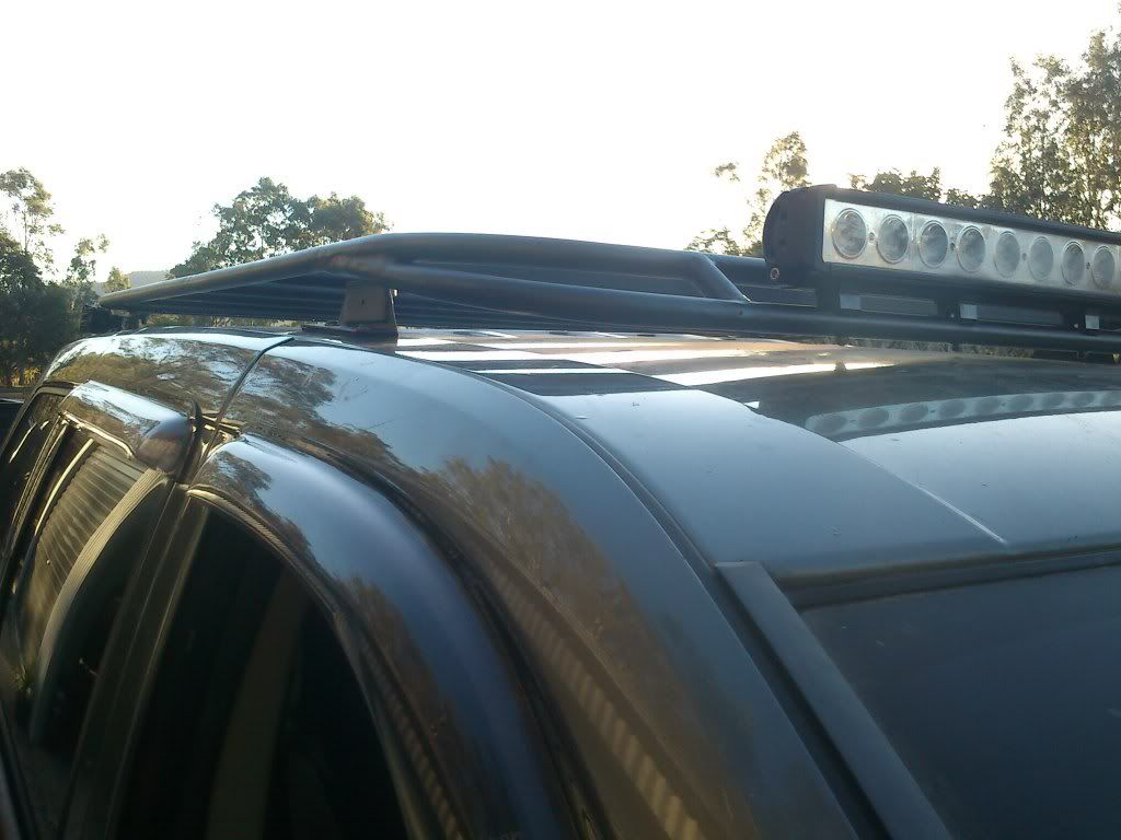

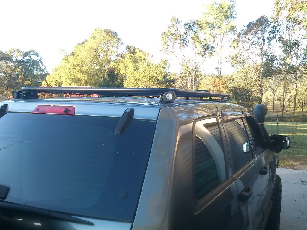

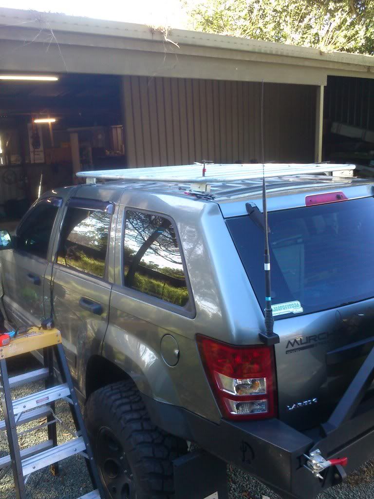

Well, stage 1 of the 'AJ' roof rack is complete, and in true fashion, its all painted, on the roof! And these are the only photos :-) Lights are also on, but the wiring has just been slapped on till I can get time to rerun the cables inside the cab for the rear lights.
Its nice and close to the roof, I have no wind noise from it at all, and it doesnt stick out. Still gives me something to hang on to on the trails (and put a strap over if needed!) and the light bar is back on the roof where it should be!
SO now the remaining works are to fix the cabling, and eventually get a single row Rigid light bar to replace the current one.
