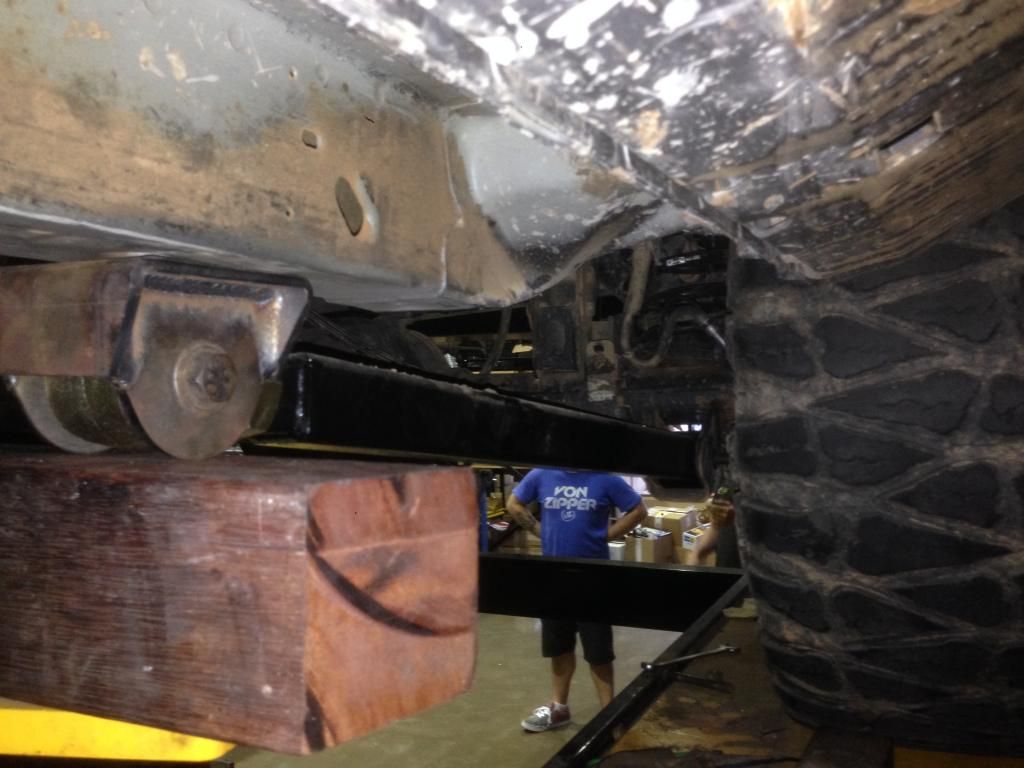

Some progress!
Will be keeping the factory LCA mount on the diff, angles work well with the arms.
Still have to remove the trackbar and upper mounts to mock up the truss and set its angle to retain the pinion angle through flex.
Steel shop hasnt finished the frame rails sleeves yet, hopefully soon!
