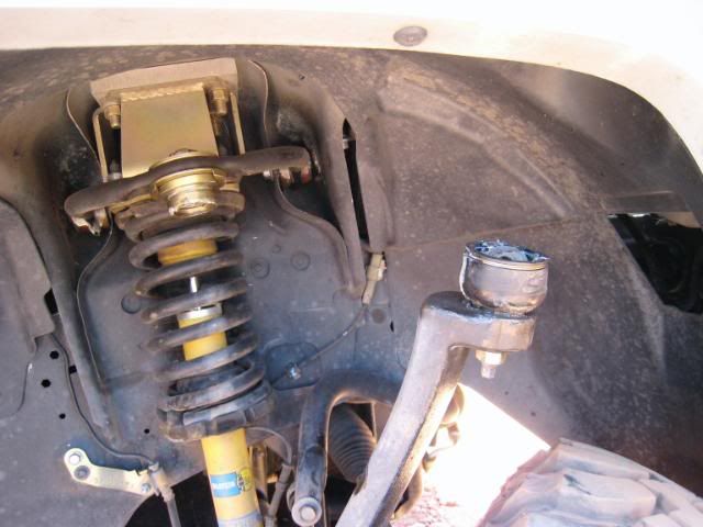

Guys used to replace them all the time before any aftermarket UCAs came out. Since the JBA and RRO arms came out it seems most guys just use that as a reason to upgrade instead of replace the joint. I haven't seen anyone post about replacing their upper ball joint for some time now. The even make adjustable ball joints.
Here's a pic i have saved of an aftermarket adjustable joint that Funkydude snapped years back:
Also, a helpful hint with the upper strut bolt. I like to torque mine down by hand and then double nut it so I know it won't loosen up on me.
