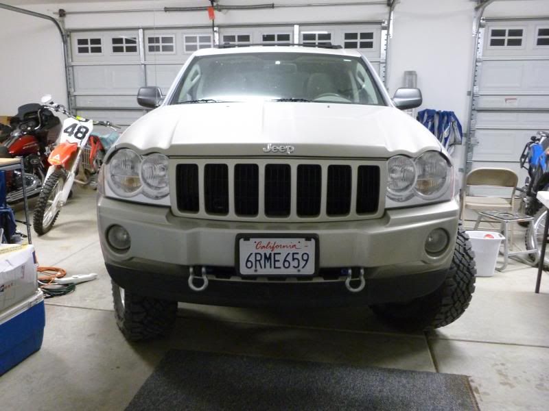

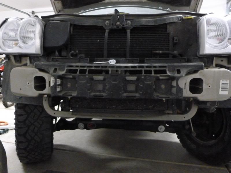

Latest additions! WHen I heard Aspen Creek was closing it's doors I immediately ordered the Front Recovery Shackle kit. Got it installed last night.

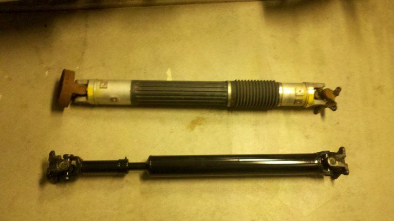

Also am having a new Rear prop shaft built. Should be ready for pick up Monday. Going with the 1310 u-joints because they have discontinued the 1330 mount flanges, so in case something implodes, I can still get parts. More to come on that!

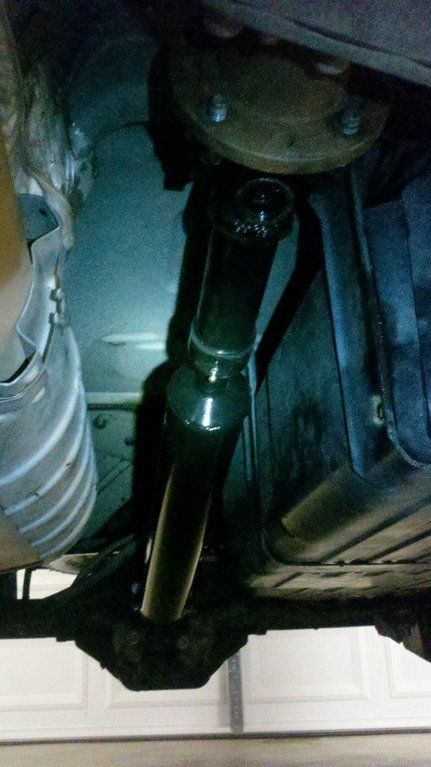

Got a new driveshaft today! Unfortunately, replacing the rear was only half the problem. The driveline vibrations are much better, but without the rear shaking the front made itself known.
Built by High Desert Driveline. It uses Spicer 1310 u-joints and everything is serviceable!

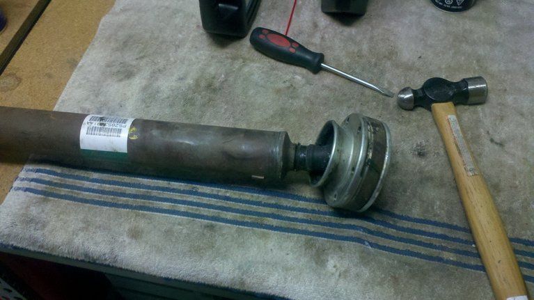

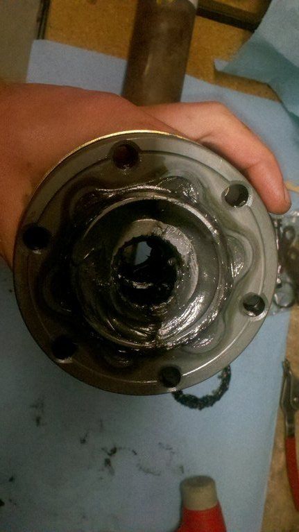

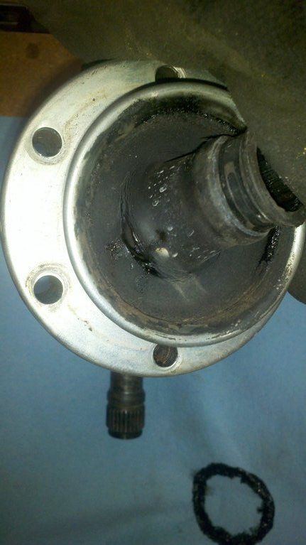

Got a few more things done a few days ago. The biggest was the front prop shaft CV rebuild. Here is how it went.
-First had to get the thing out. To get the shaft out I had to undo the rear front diff hangar and swing the link out of the way (super lift) then was able to get the shaft forward enough to clear the cross member.

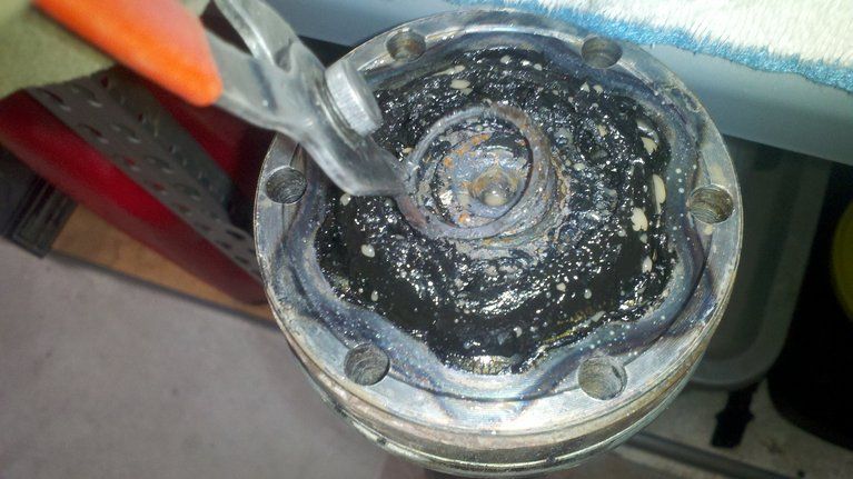

-Once out, I just used a flat screwdriver and a hammer to pry off the end cap of the CV joint. When I popped it off a bunch of water and sand came gushing out. It was pretty much destroyed.
-Next remove the C-clip and the strap on the rubber boot.

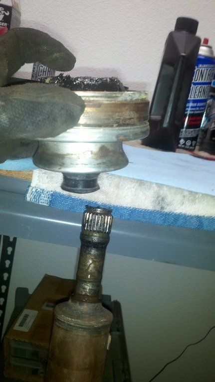

-Then the CV joint slips right off.
Here is the culprit to the failure, torn boot.
The new kit all laid out. It is the Dorman rebuild kit and ordered from Napa. It was $164, I know it is online for cheaper, but I was in a pinch for time.

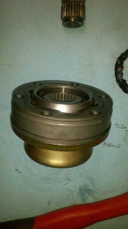

-When rebuilding, the first step is to attach rubber boot side to the bearing unit.
-You must make sure the bearing unit is facing right, the face of the T-case side is machined down for a paper gasket, flat surface is forward.
-They instruct to use a liquid sealant on the flat surface. I didn't have any, but I did have RTV sealant, so laid a small bead of RTV and pressed on the cap.
I didn't use any guides to keep the holes lined up, but it might not be a bad idea.
-It fits snug and had to use a rubber mallet to get it to sit down all the way.
-Once that was on, I packed the bearings with the provided grease.
Picture after packed, also note the machined detent on the face for the paper gasket.

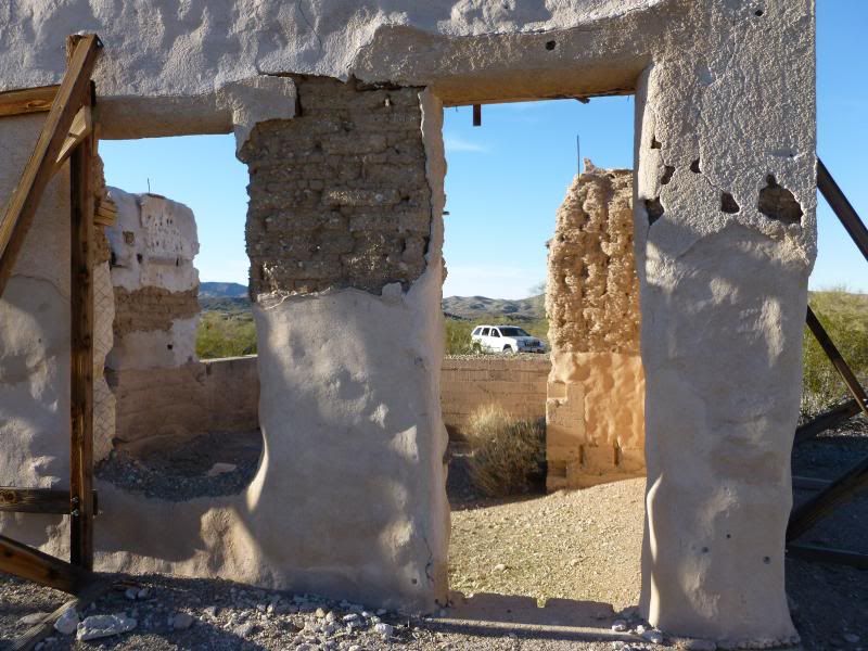

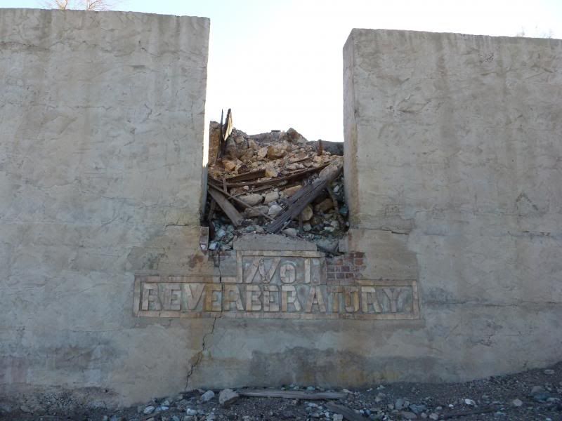

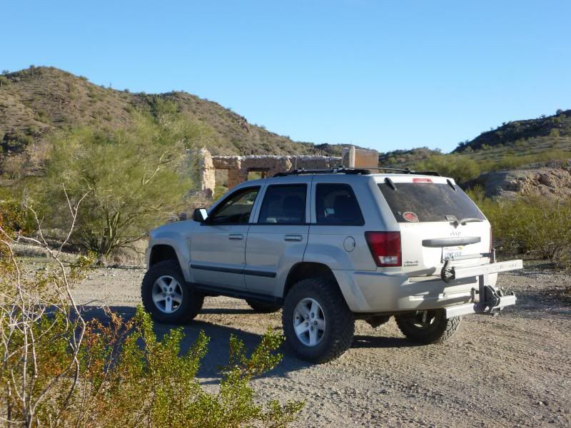

Got the Jeep out into the hills over the weekend. Went and checkout out the Swansea Township site outside of Parker, AZ. Roads were all pretty well maintained. Lots of cool stuff back in there.
Arriving to the site
The Smelter

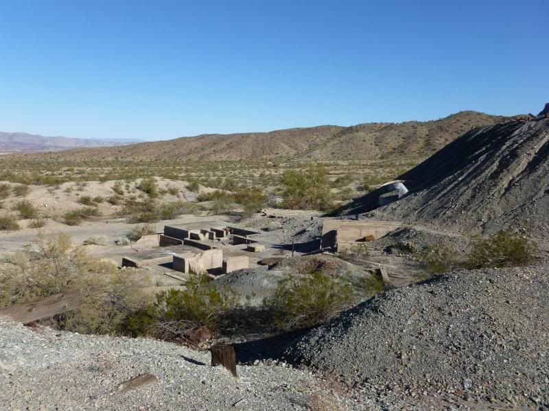

Some foundations from part of the smelting process.
Train Depot
Back side of the slag pile and some of the collection/cooling pools.
