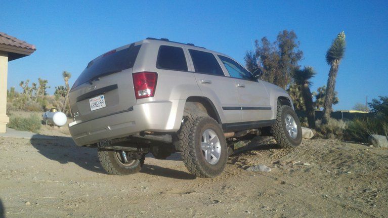

Hey man great build the Superlift looks great. You got any pictures of your rig from the rear? I am installing a Superlift this summer and I think I'm limited to the 285 size because I have the 3.7L. I want to make sure that the 33's won't look to small.

Here you go

Awesome man, looks good. You like the 33" size with the superlift?

I think the 33's are the perfect size for this lift. Looks like a Jeep should.

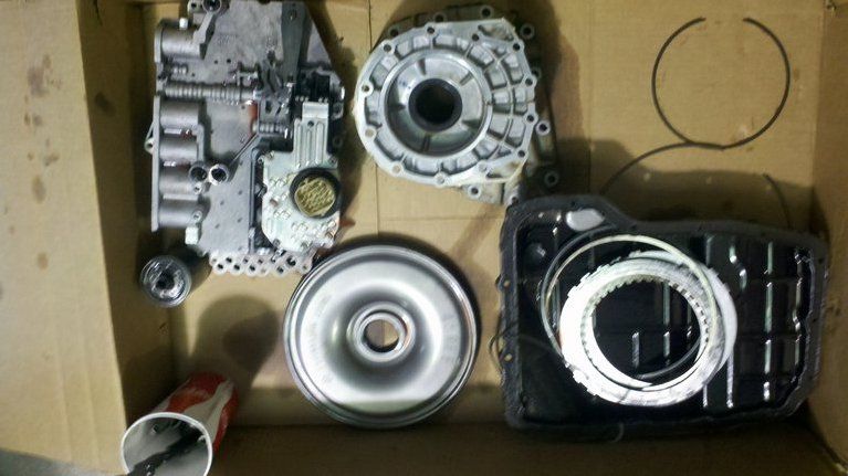

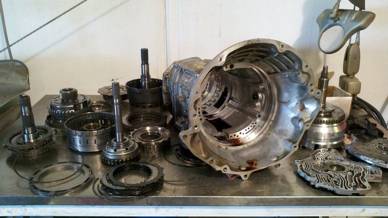

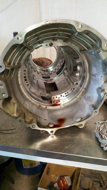

Update on the transmission issues. I limped it around for a while only driving it when I needed to. I was able to make it work without it being too jumpy, but essentially took the joy out of having a V8....even if it is the anemic 4.7L.
After much research, I had convinced myself I blew the accumulator plate off the shift solenoids. Took it to the shop that installed my lift and they tore into it. It wasn't long before they discovered that wasn't the issue. They dropped it out of the Jeep and began opening her up.
First thing they noted, the dealer who rebuilt the trans 18 months ago did a shotty job in rebuilding it. It was supposed to be a full rebuild, but evidence shows they pieced it together. The work was done under warranty, so I imagine they were cutting corners to gain more $$.
The most notable damage was the low gear clutch pack. The clutches had ZERO clutch material left!
The rundown they gave me was most likely the low gear clutches didn't have much left and when I got the High LIne Pressure code, it was because the trans was adding pressure until it maxed out and was continuing to slip....or something along those lines.
At the moment, I'm $1500 into parts and everything is getting replaced with new stuff. Clutches, solenoids, sensors, and I'm having a Trans-go shift kit put in. I am stoked to get the WK back. I've been driving my roommates JK (gray one in previous photos) and its driving me crazy. Street manners are terrible.
Here is the good stuff:
All the internals laid out.
Parts from the pan side.
Closer up on the internals.
The Empty case.
