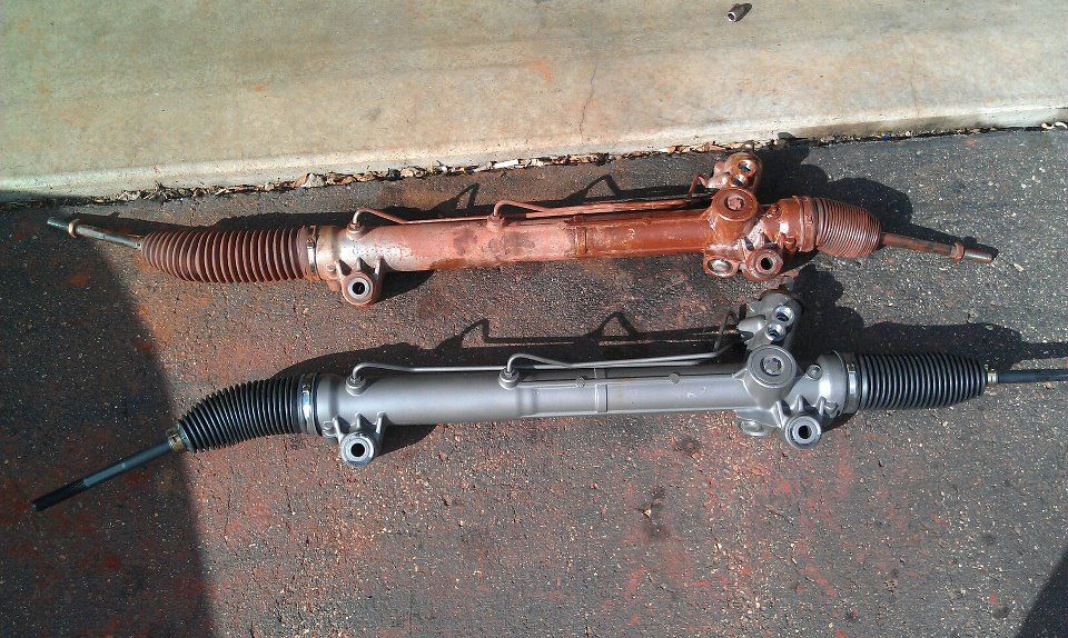

Is this the actual part?
Yep! That's the one. The star (inverted torx??? who knew there was such a thing) bolt is the one to turn.
