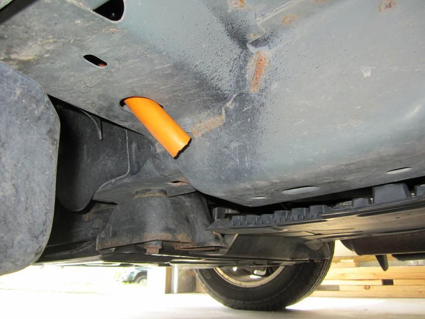

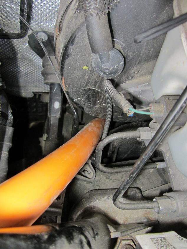

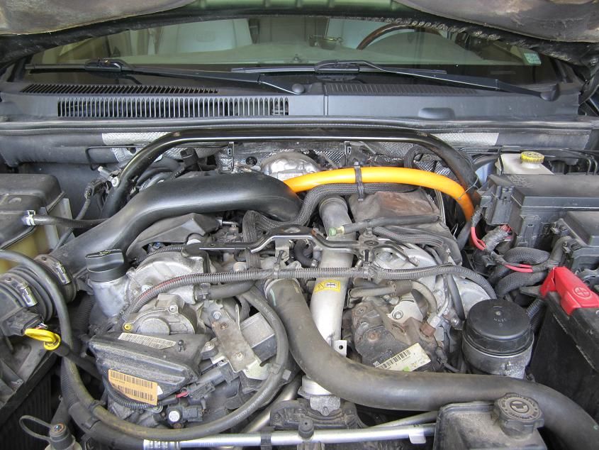

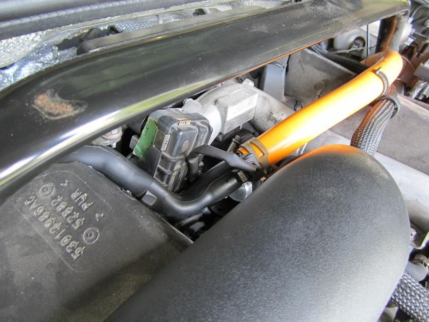

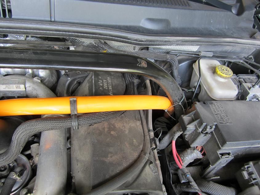

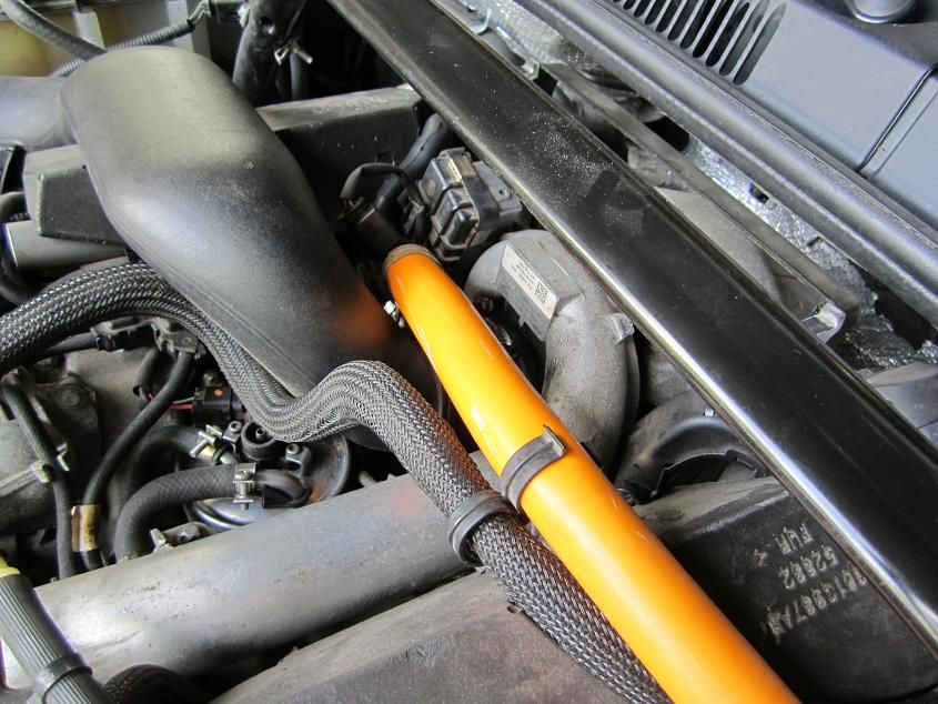

10 Minute Elephant Hose Installation
Parts list ($36.00 total):
1. $18.00 + shipping - CB Engineering CCV plug: http://cb-engineer.com/products/ccv-plug
2. $12.00 - 4 feet of 22mm or 7/8" ID silicone hose from eBay
1. Remove engine cover
2. Unplug CCV hose and remove red gasket.
3. Install CBE plug
4. Install silicone hose onto barbed end of the CCV hose heater. Find a hose clamp in garage and secure it.
5. Secure hose to something, route it into the frame and out of the frame, takes 3 seconds. You'll see what I mean, raising the car is not necessary. I will stuff it back into that hole for yearly inspections.
Notes: I have not trimmed the hose yet. Silicone hose gums up with heat and oil. I will update if too many fumes come into the windows.
Update: the amount of smoke that billows out of this hose is really funny. It doesn't smell horrible but I think my wife will eventually complain. I need to plan for plumbing to the exhaust.
Pictures:
