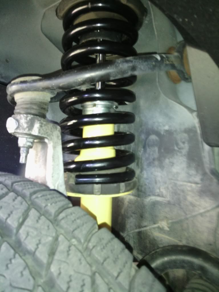

What happened to your lower strut clevis? Looks damaged in the picture.

Thats just dirt/sand/muck was going to put it up on a hoist and jet wash everything - been too busy modding, I know no excuses
Originally Posted by WieSeL View Post
I don't think there is an adjustment for the upper arms. The camber is adjusted by the lowers. Maybe a different angle on the top would allow more adjustment? The alignment shop I went to said the camber was as "good" as they could get it without making the caster go out of spec
Yea we also had some wheel allignment issues (took hours to complete), mainly in the angle change of the Caster. The Toe and Camber where within the range. Due to difference in caster left to right, the ride high was out from left to right. after some changes managed to get this down to 4mm, which is nothing considering the dimensions of the truck and the suspension length, ride height. It drives in a straight line perfect now.
On another note, I will definitely be changing the UCA for the JBAs with uniball joint in them. This is something that will give in after considerable wheeling. also, I noticed when the truck is lifted on hoist, the UCA drops and touches the bracket that the UCA is mounted to, and the strut lower cup touches the wheel knuckle (both marked with red arrows in below pic). This is what I believe is causing a slight 'clank' noise when I go over a steep speedbump quickly (when the wheel travels down the bump (maximum articulation on the suspension). The JBAs should change these angles and move the knuckle away from the strut, and hopefully clear the mount bracket, also relieving the angle on the joint.

Damn my angles aren't that extreme. What lift combo do you have?

Mine aren't like that. I have a different lift though. The spacer kit must change the angle more than the OME due to the change in location of the strut plate
Yup, that picture is with the truck hoisted with all four wheels in the air, hence the extreme angles. Its a 2" RC with Bilsteins. This is what would happen when wheeling or when going over a steep speedbump, when the wheel drops down momentarily before the body catches up and the shocks kick in.
I would expect both BB and OME to change the location of the strut plate, but it seems in this case perhaps more so? where does the strut plate sit in relation to the wheel knuckle when jacked up, would be interested to see a photo of that ... I will be going down the OME route much later, but for the purpose of the wheeling I am intending to do (Sand dunes), it is not necessary at all. Once the truck is no longer a daily driver it will probably get an SL lift for the rocks
The strut plate stays in the factory location with the OME kit because it uses springs to lift instead of plates.
This is with the vehicle on the ground but doesn't change the angle that much when lifted

It would be when lifted, my angles look the same when on the ground ...
