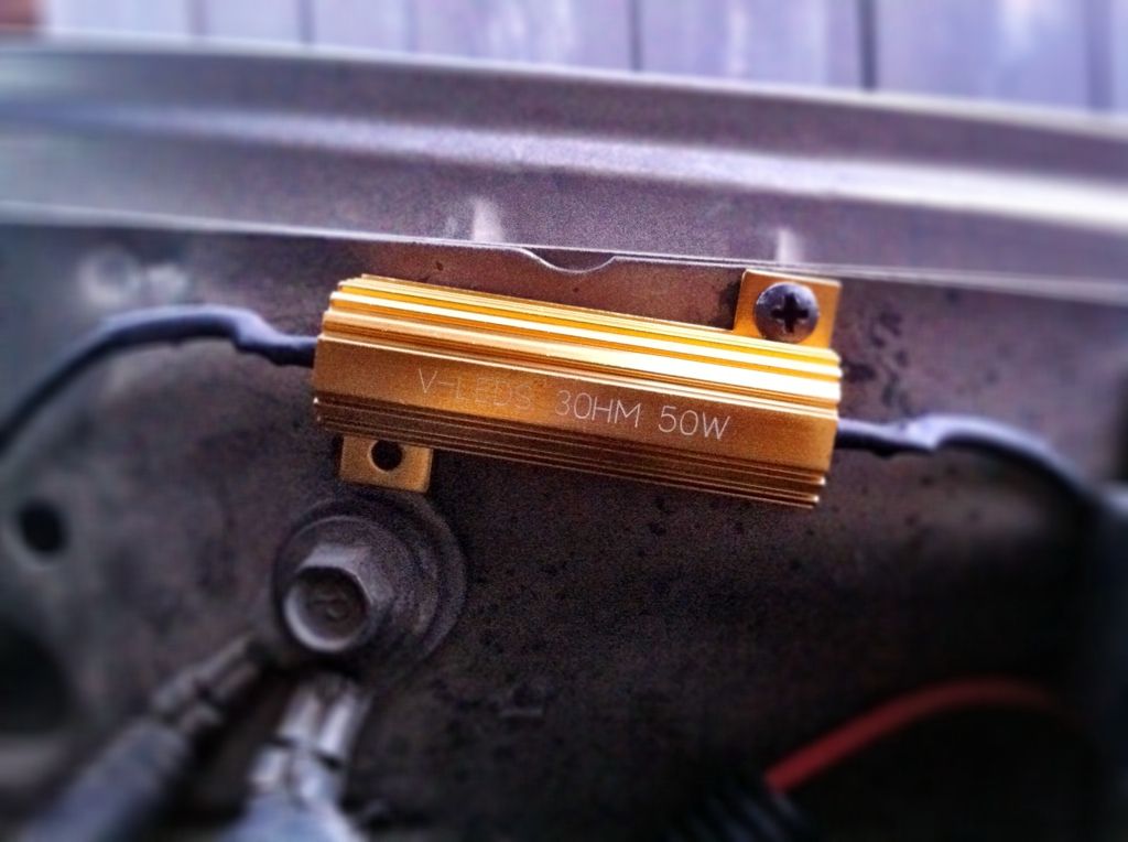

I had LED tails and revers lights and only needed resistors for the front once I installed the LEDs up there. Try a pair of 6ohm resistors and if that doesn't work try 3ohm.
I have 6 ohm ones that I'm going to install tomorrow. How did you mount them? I imagine they get pretty hot?

Yes they get hot. I mounted mine on the inside lip of the engine compartment just aft of the headlights.

I guess you wired in some longer wires?

Yes I extended the wires on each end to have plenty of wiggle room. Otherwise mounting locations are very limited.

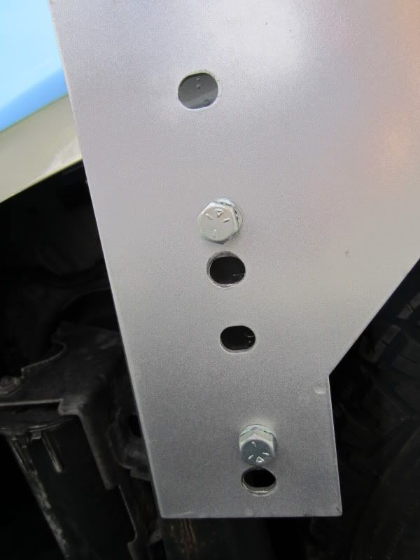

installed my 4xguard rear guard 2 the other day...it didn't line up the way i wanted with either set of holes so i drilled my own holes exactly 1" from the one set of holes (center to center) as seen below:

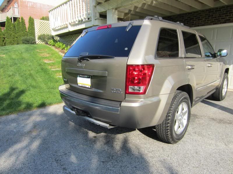

installed my 4xGuard Matrix a little while ago and finally took pics with my camera instead of my phone:
