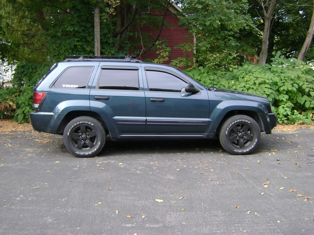

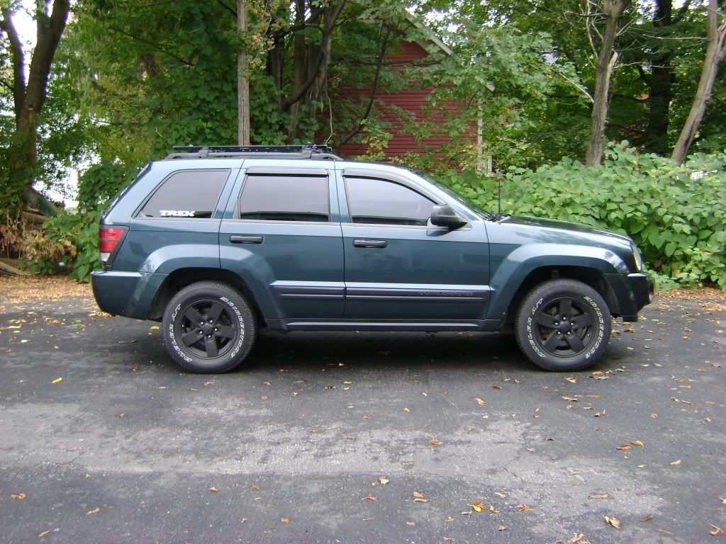

sunrcr69 is right. The whole assembly needs to be dropped. The spacers goes onto the 4 studs and then you bolt the assembly back up. I've had them on now for about a year and a half.
Before
After
