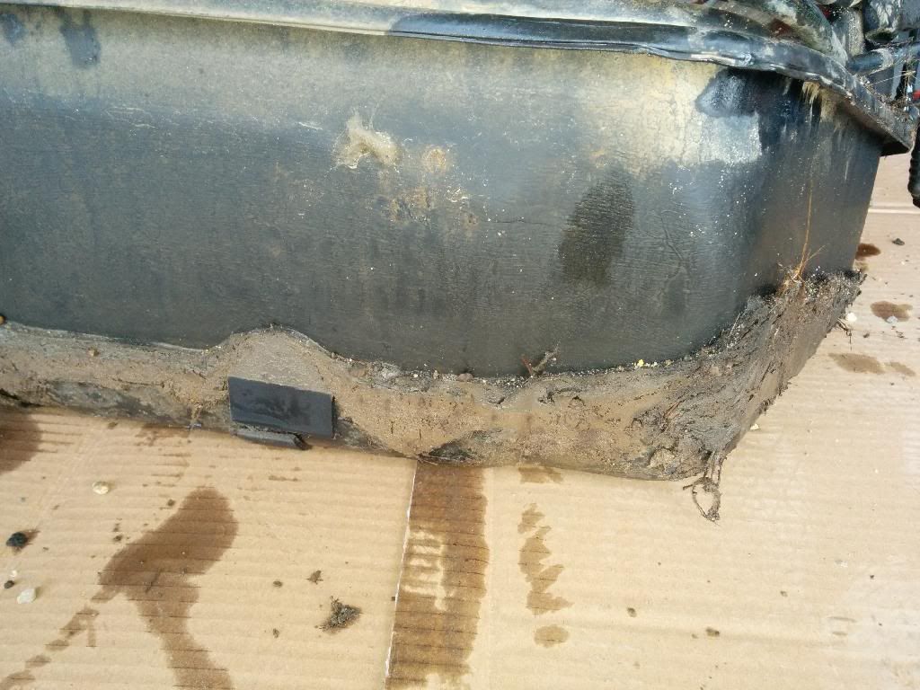

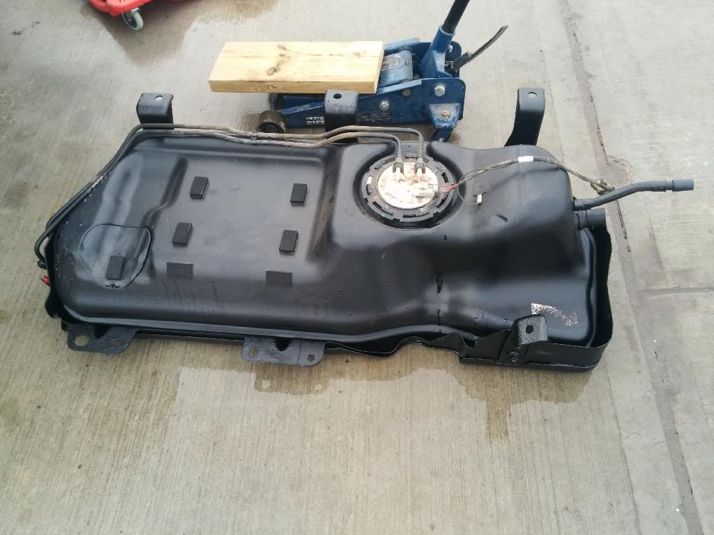

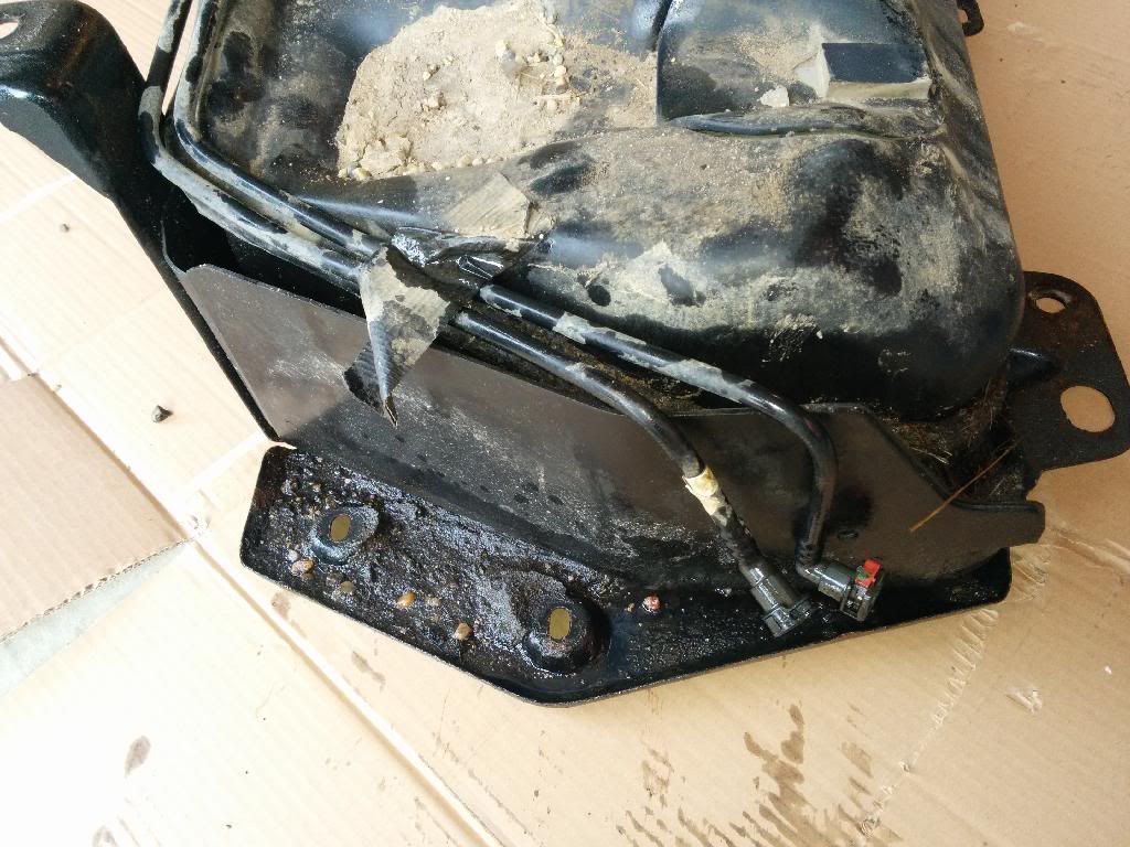

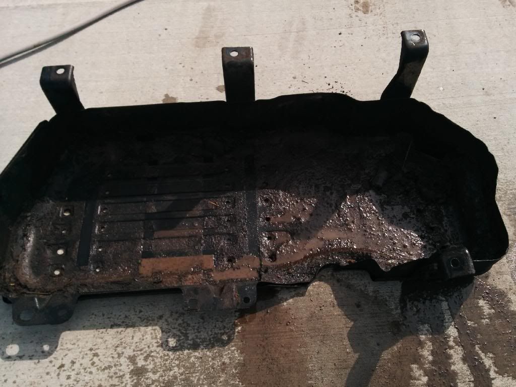

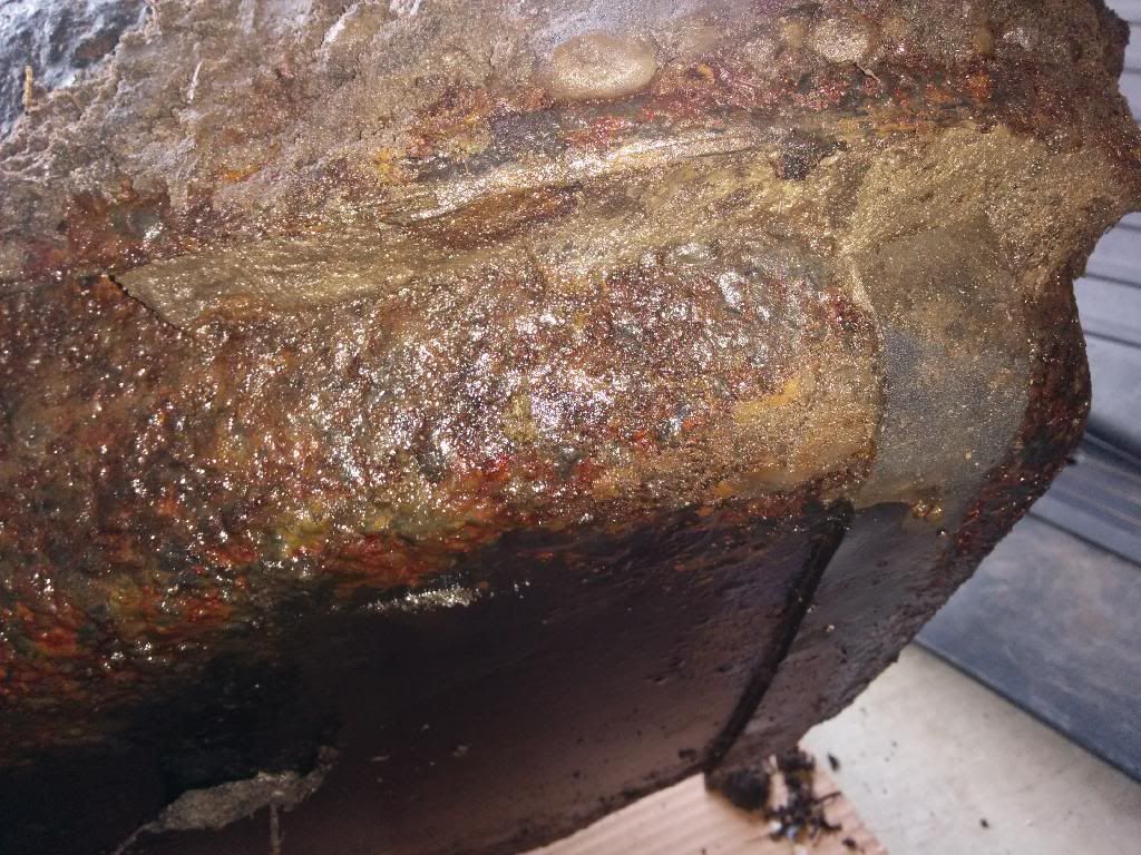

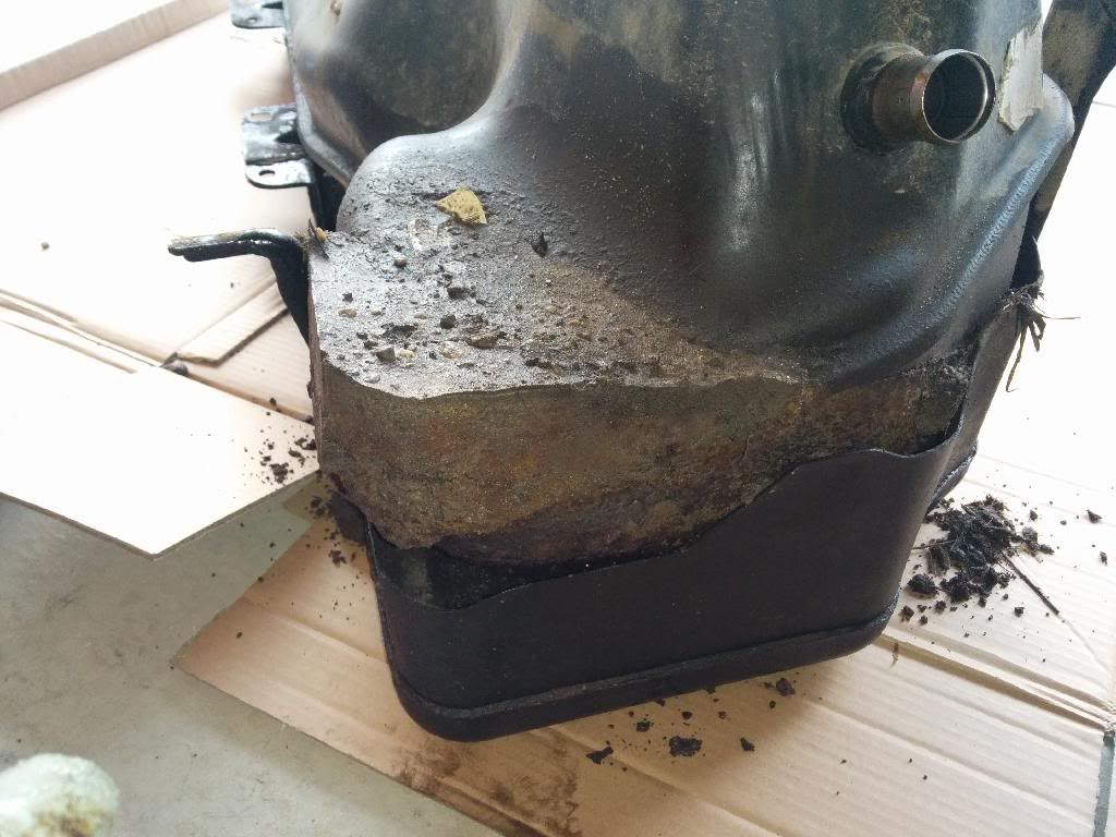

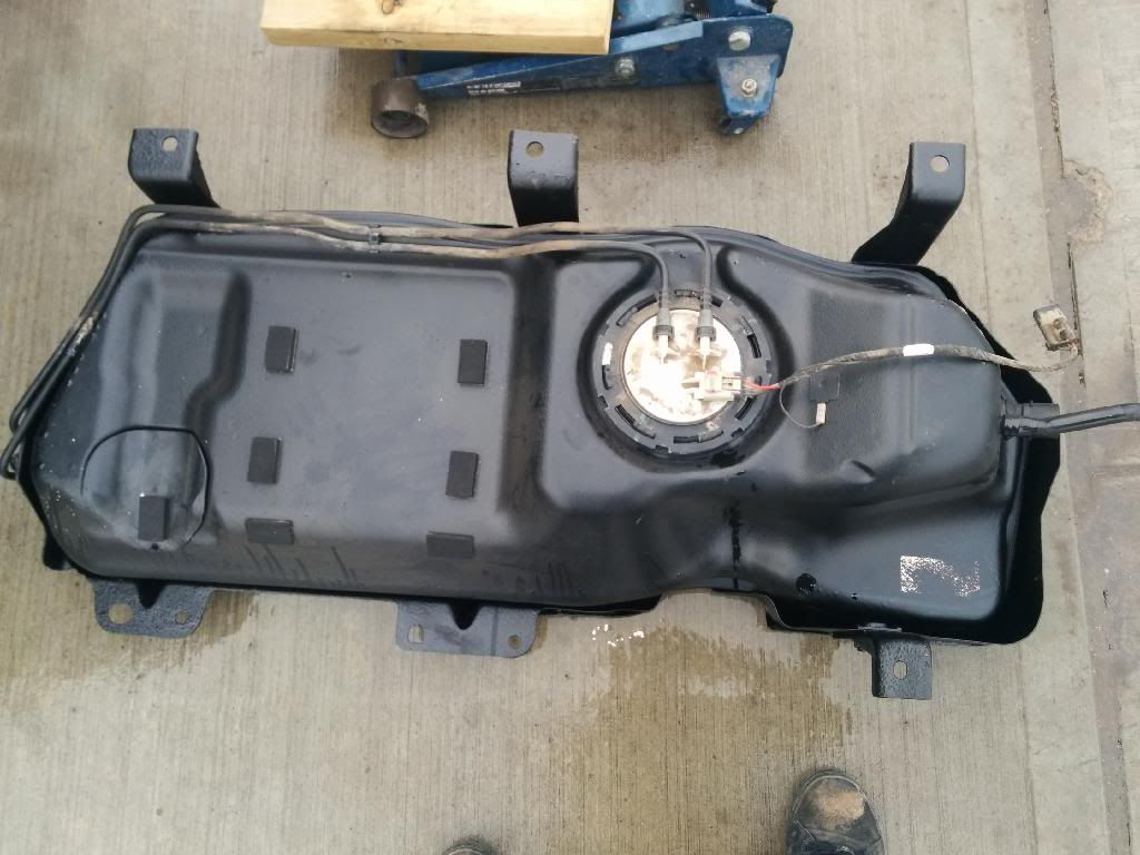

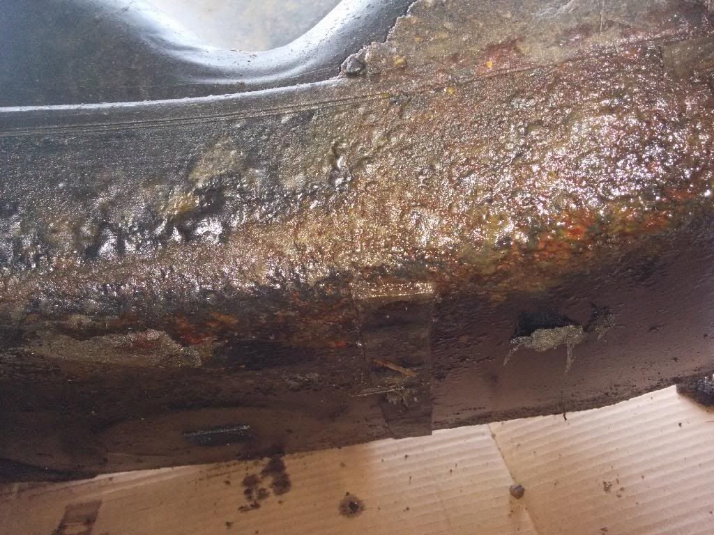

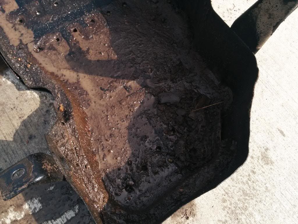

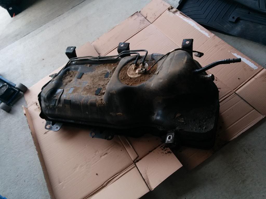

Long story short, I was leaking diesel fuel all over my driveway.
My vehicle is a 2008 Jeep Grand Cherokee CRD (DIESEL). It has 110, 000kms on it. I have full skids, including a metal fuel tank skid.
Chrysler Canada refuses to help in any way to repair this issue. They said its not their problem and there is nothing they can do. BUT they can sell me a new tank for $2100 CAD~ and install it for $800 CAD~
so what did I do? I'm cheap as ****. I went looking for aftermarket support. There is ZERO. Custom fabbed aluminum tank? $3000~ depending on time spent on it. So no dice there. No poly(plastic) replacement tank.
So I found a tank NEW from the dealership in the USA for $900 shipped to Canada. Perfect! (I don't know why Canadian dealers like to FUC* us so bad)
So what happens with Chryslers INFINITE wisdom and designing:

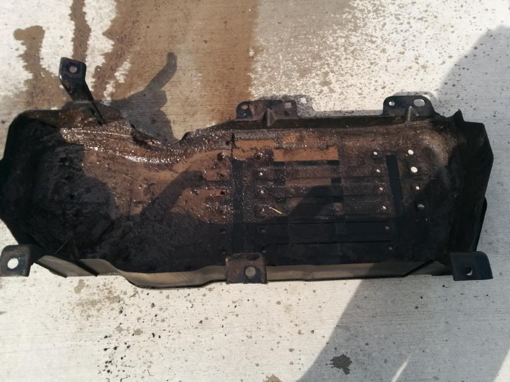

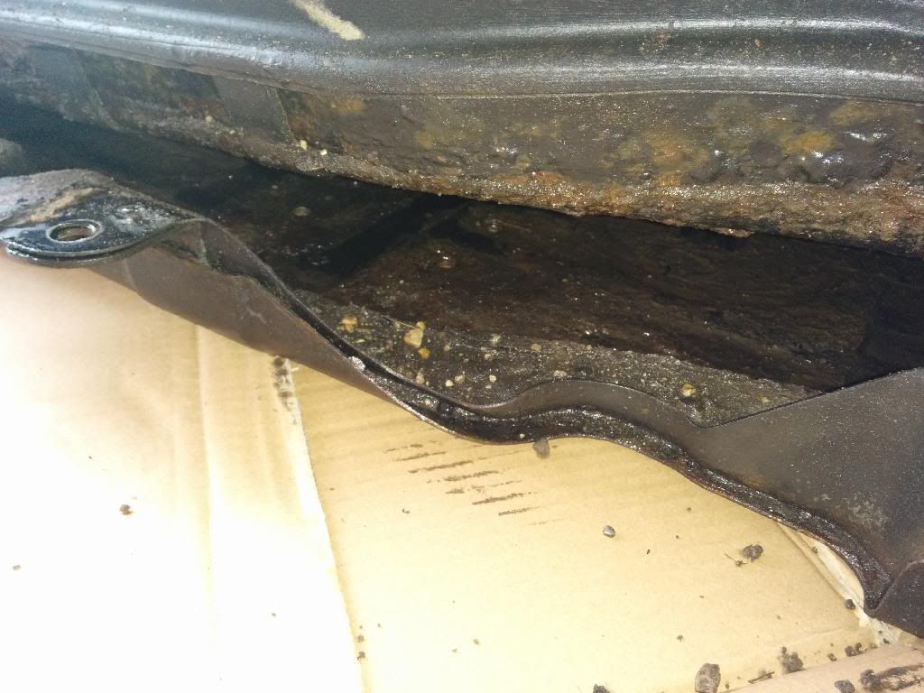

They have a STEEL skid plate essentially clamp (steel on steel) the STEEL fuel tank to the underbody. Does anyone else see a problem with this? I do! Don't worry though, they provided foam like padding to stop the contact of the two metals and provide space! (yeah right!) They have 1/8" think foam pads strategically placed in a few spots. Then they provided draining for whatever gets caught in between the fuel tank and the skid plate to run out of. (again.. yeah right!) they have 6 or 8 1/4" holes drilled in the skid plate.

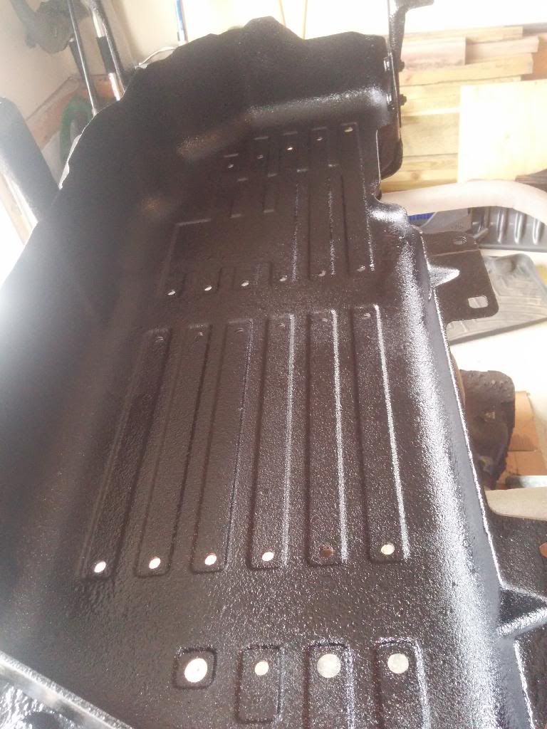

So with my hands tied on what I can do to prevent this from happening again, I rock guarded the **** out of both my skid plate and my fuel tank. (hope it helps a bit) But Chrysler has a serious problem here.
I would like to share this information with everyone with a skid plate, so they can take the necessary steps of hopefully preventing this to happening to them as well. Simply drop your skid tank and CLEAN IT, remove rust if any, and replace with rock guard or paint.
So to end my rant, my vehicle is 5 years~ old and Chrysler sees ZERO problem with a fuel tank being disposable at this length of time. It's NOT an engineering problem at their end..
/RANT
On a side note, I hope this above information and the below posted pictures serve to help others that will have to encounter this themselves.
-Ryan

1st. Thanks for not being an un-educated dick on the matter. I was posting useful information and bringing to light a problem.
2. Your very WRONG. The fuel tank is steel, itès rusted as shown in the above picture. OEM does not make a plastic alternative, I verified. If you are assuming and do not know the facts, please leave your speculating comments out of this thread, itès not helping anyone.
3. I clean my car lots, if you seen the position of this, you would know youèd have to drop the skid and tank together to clean it out properly, it's almost impossible to clean this out while attached.
4. No I don't think I'm entitled to free anything. I feel that this information is useful to everyone. I also feel that a fuel tank should not have an expiration date of 5 years. I would have been more then happy with them acknowledging the problem and providing any sort of retrofit to stop this from happening again, as well as notifying Jeep people so they can take proper preventative measures.
5. Thanks for coming!
*I tried so hard not to be a a-hole responding to you BTW.*

again... the fuel tank is in fact steel, not plastic.
If you don't believe me call the dealership.

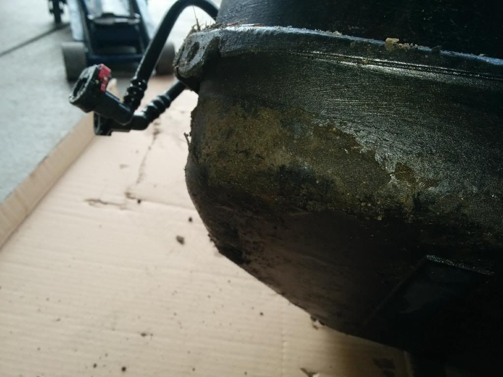

Correct, no salt used here. This is just from an accumulation of rock, mud, sand and water with no escape route. Eventually this will make it through the paint/primer and cause rust.
To properly clean it, you will have to drop your tank and skid plate. It's not too difficult if you have a jack and air tools. I got good at doing it after doing it twice... (I forgot the gasket around the fuel pump and had to drop it again.. lol)
