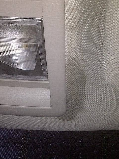

the water mainly comes out the passenger side A-pillar and the upper console
here is my upper console

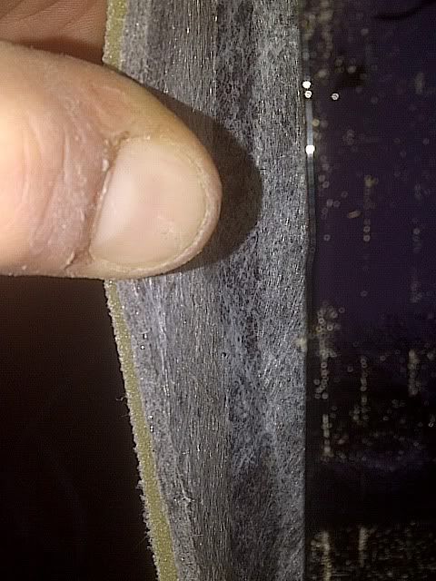

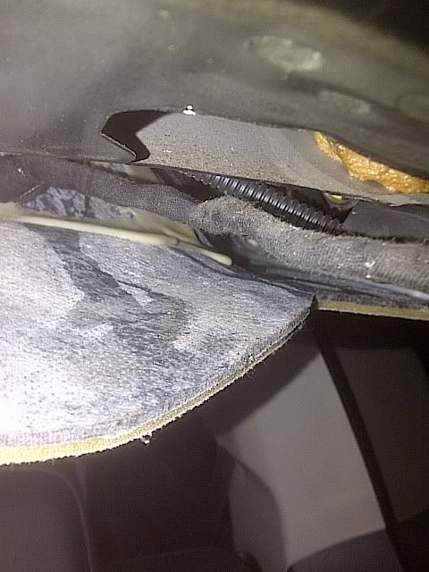

this is the rear passenger door, i pulled down the weather stripping and the headliner, the stream is coming from the back

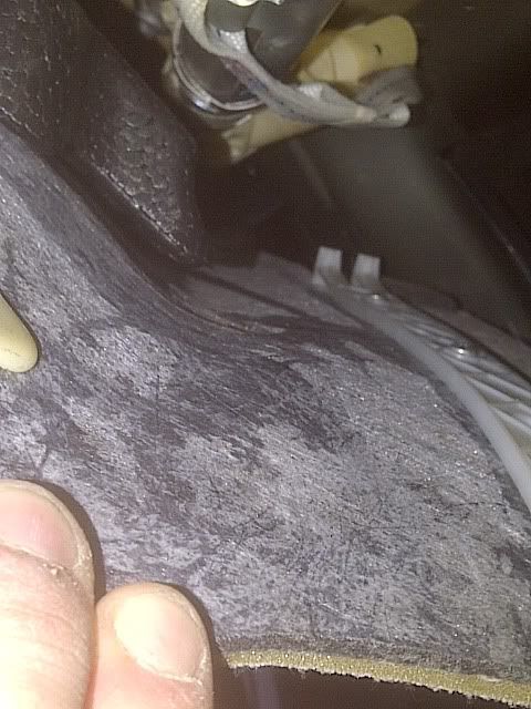

then i went into the back and pulled down the panels there to pull down the headliner and this is what i saw
i can reach my hand up under the headliner and the roof is soaking wet,,,
