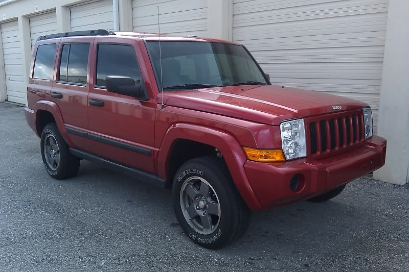

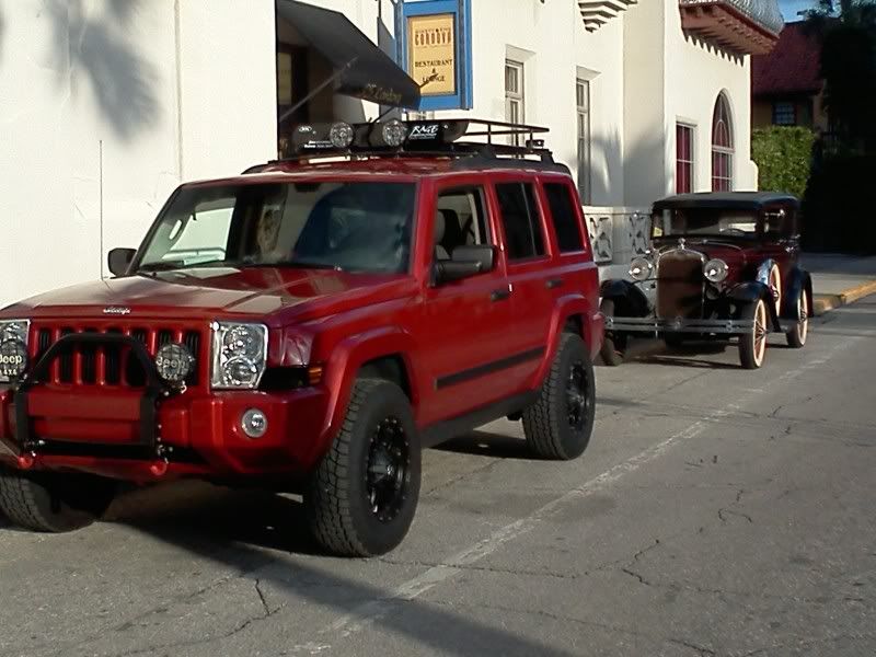

I baught it in stock form at 36,000....2006 3.7L 4x4 QT1 Inferno Crystal Red
First I installed the Rocky road 2.25" lift.............
Then I installed "Limited" rear grab handles and color-matched them to be different than the norm...
Continued...............

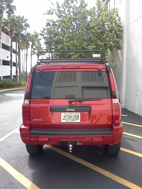

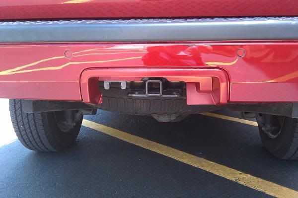

Hitch
Got my Mopar Hitch installed with color-matched bezel...............................
[/IMG]
I know, I know......it's the baby hitch, but thats all my Commander is rated for.

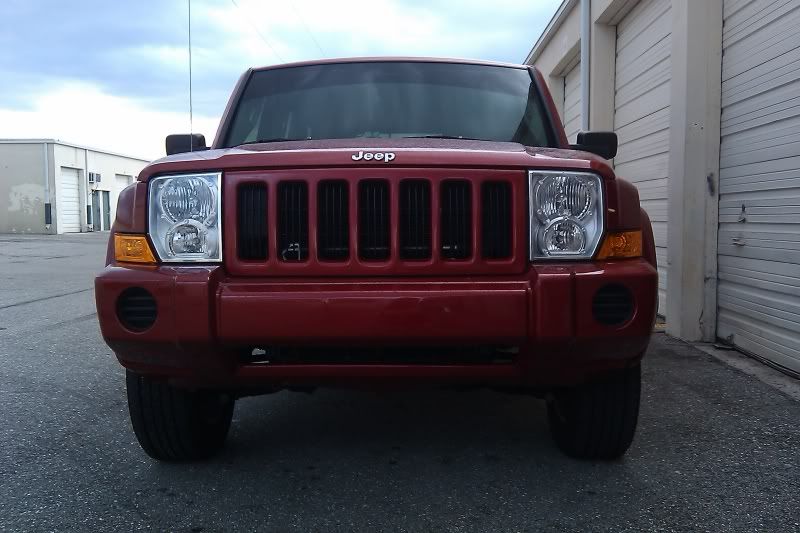

Tinted turns...

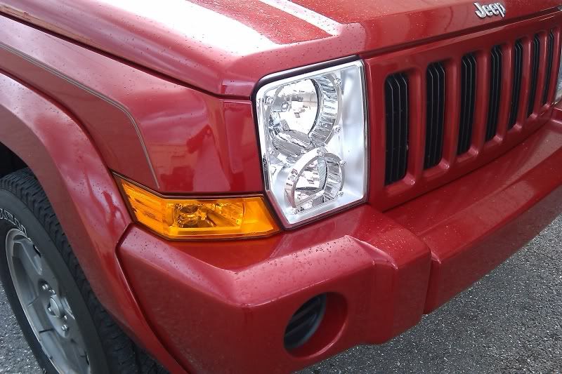

Finally installed my new-to-me lights. They look good, but it's only part of my final plan.
Before headlights.....
During.....(I also installed the studs needed for the Matrix)....
After with smoked corner lights...........................

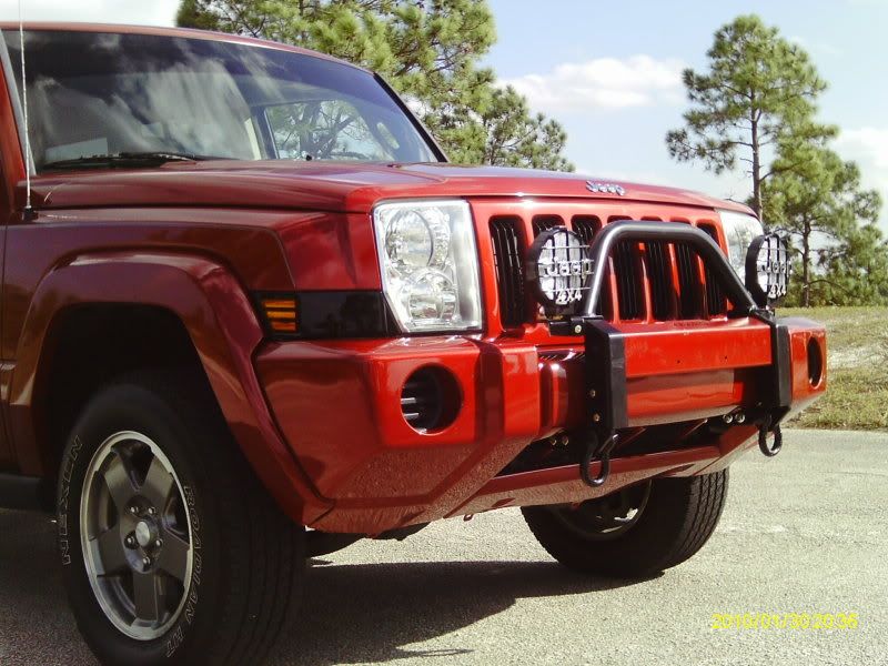

Matrix 4xgaurd w/hoop and lights
I installed my Matrix-4xGaurd w/hoop and fog lights today. Check out the pics......................

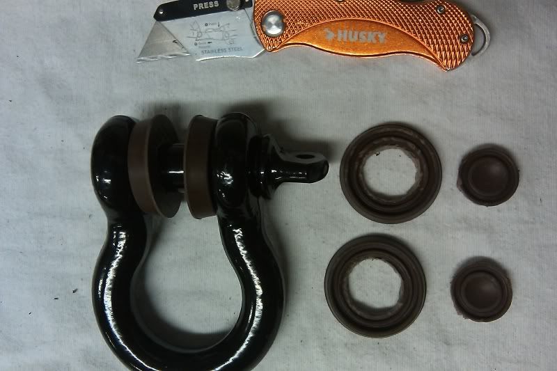

Here is what I did to cure the D-shackle clanking on the Matrix. Others have used felt and that works as well, but I chose to use rubber chair feet cushion thingies....
That's it........It only cost me $2 at Home Depot and it works great!

Hitch harness and bumper lights

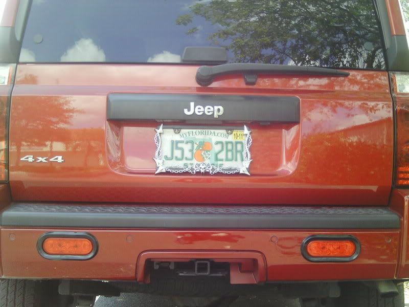

So today I had a chance to finally install my hitch wireing harness and also the rear bumper lights...For now I wired them to light up with the tails/turn/brake lights, but later on I will swap them out to clear white lights for reverse assistance (I have not found the white ones I like, yet). You will see in the pics provided that I soldered on a "pig tail" to the hitch harness so i can just unplug it when ever I'd like. I didn't take pics of the actual install, 'cause I just followed the thread on the lights that has install pics. So, on to the pics.....
Here you can see the hitch harness with the pig tail and the light harness as well.
Here is a closer look...
Another look....
Lights.......
O.K., no night pics yet 'cause since I wired them into the hitch harness, I still have to program the computer so it knows I have a hitch. Therefor they will not light up yet.

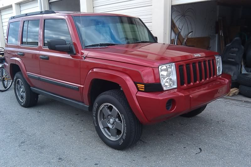

New wheels/tires

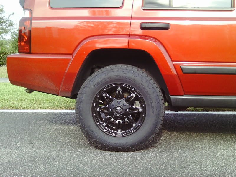

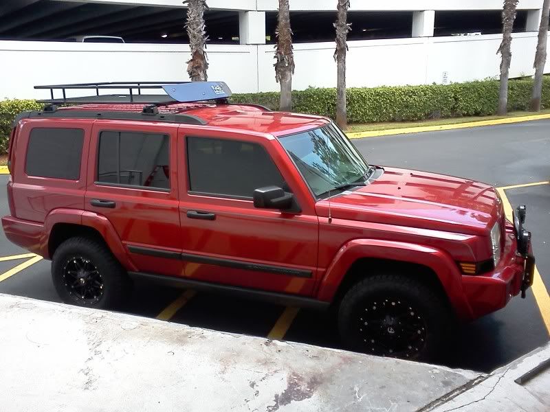

New wheels and tires installed tonight, Man what a difference! I had to take some quick pics for someone (Hmmm?) so, they are not the best. Whenever I have time to clean up the Jeep and take nice pics, I'll replace these. But, for now here you go....."Someone".
Specs..........
MHT Fuel Hostage 17x8.5 +14ET
Nitto Terra Graplers 265/70/17
First Thoughts............
The offset is perfect..puts the wheel just about flush with the flairs. There is plenty of clearance on backside to clear the dreaded bolt. Gives the Commander a muscular look from the front/rear and fills out the wheel wells nicely. The tires rub at full lock in the usual spot but, just barely. I think I can get away with just remolding the inner wells and not mess with the pinch weld, we will see later. These tires are not as aggressive as I wanted but, they are almost silent. If I roll up the windows and kick on the a/c, I cant here them at all. I do 95% on road daily driving so, tire silence is a plus. We will see how they perform next month at Uhwarrie.

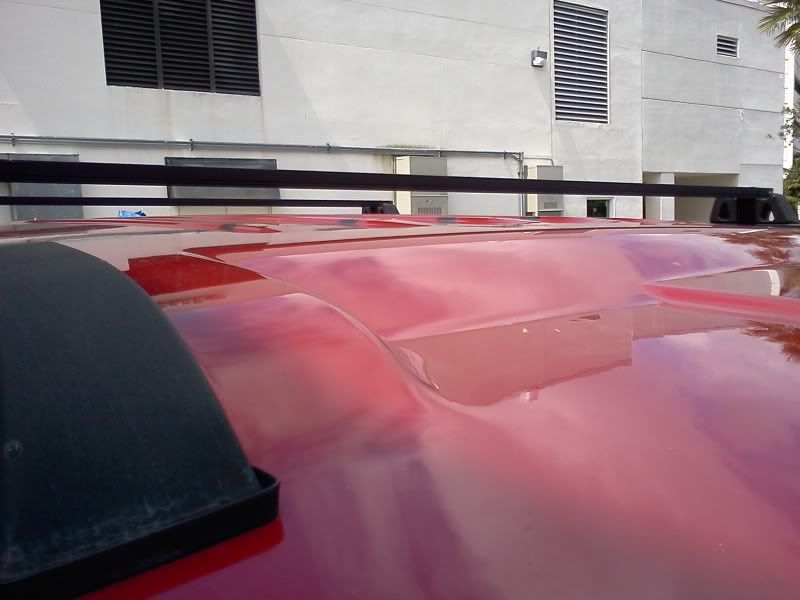

Custom low profile load bars

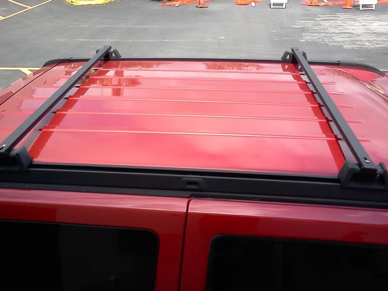

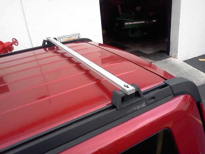

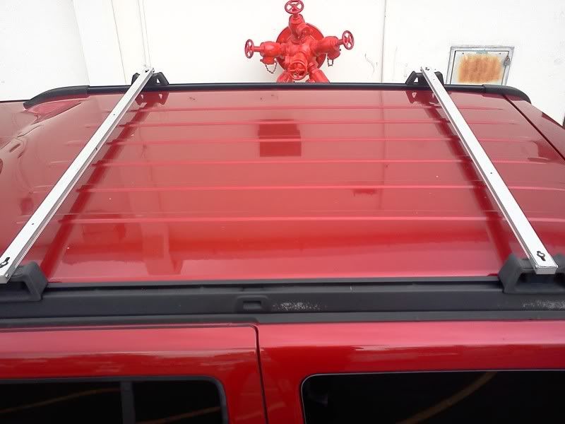

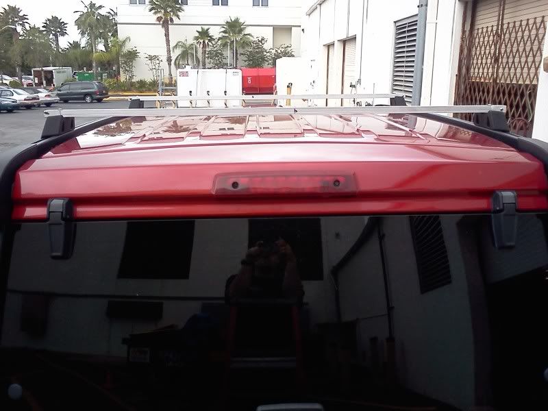

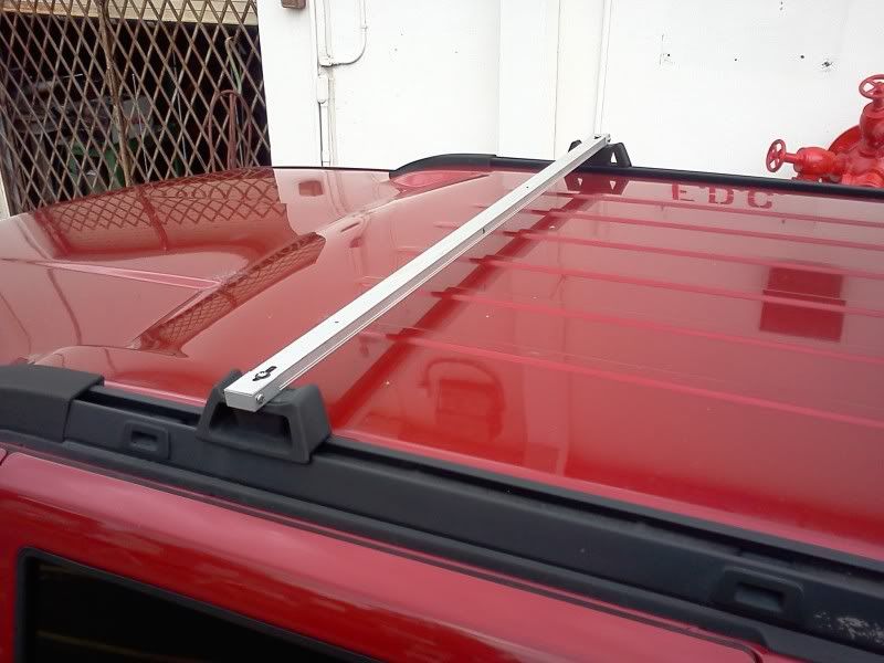

First, I had to make some new cross rails that were lower profile (so i can park in the garage at work). I used curtain alluminum rails that we use at work. Cut them to length and test fitted them..............
Then I sprayed them with undercoating/bed liner stuff and installed them in their resting area..........
I gained 1.25"s of lower profile....with the sport bars (including the mounts) it was a total of 4"s high.......with my home-mades it came out to be 2 3/4"s high.

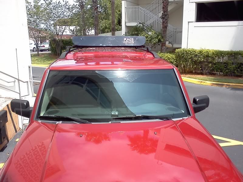

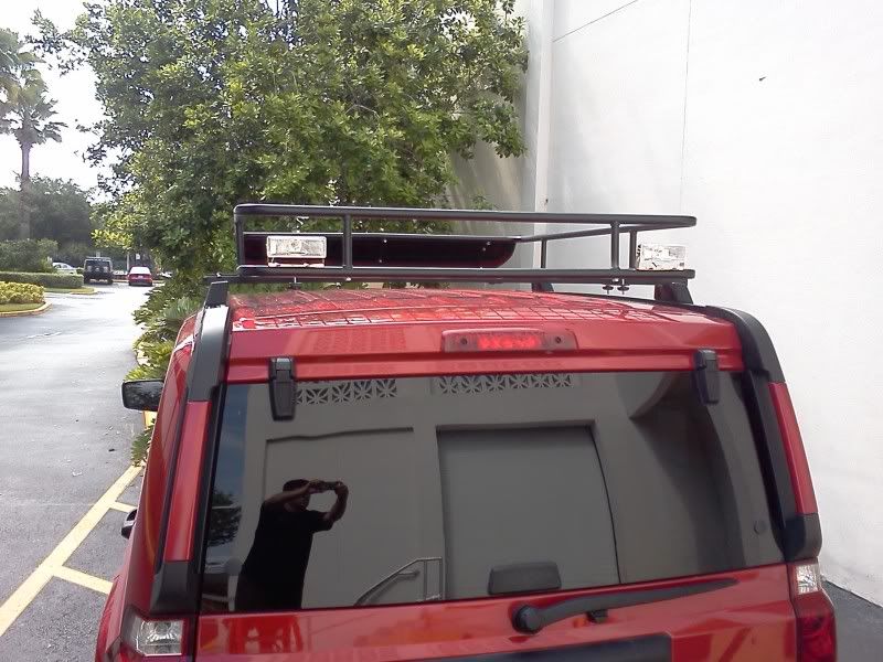

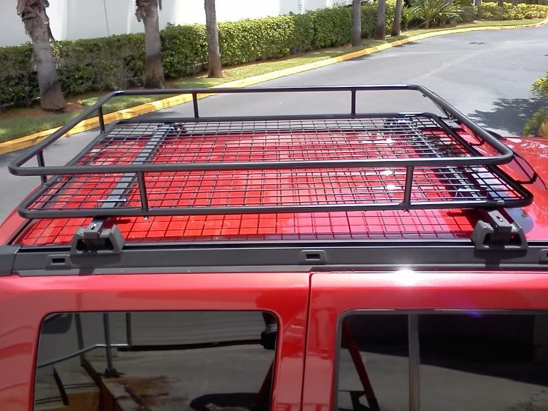

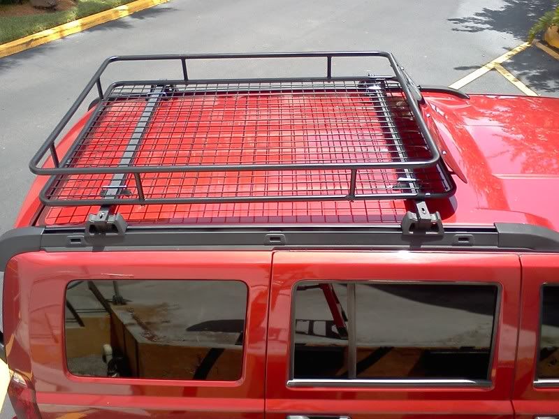

Rage roof cargo basket

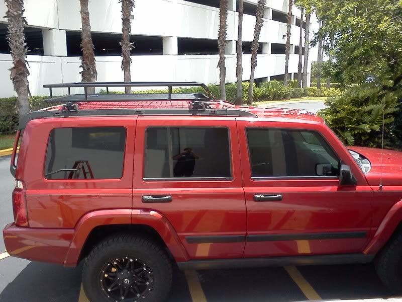

Then it was time for the basket.......Originally i planned on widening and lengthening it because i wanted a little bigger basket but, I ended up just putting it together and seeing how it looked.........I'm glad I did, it fills the roof of the XK pretty well and I did'nt think I needed to mod it any.....Sometime in the future I will fab up a custom basket from scratch but, for now i'll rock the Rage......I picked this basket because of Sal's review and torture tests......Anywho, on to the pics.....
I still have to mount some rear facing lights and make a light bar for the front, but thats a differrent thread..................I'm out!!!!

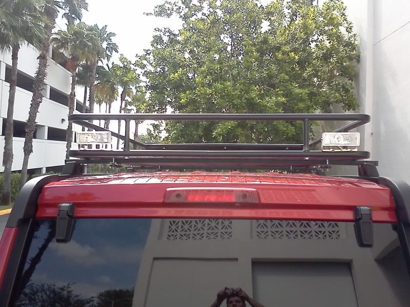

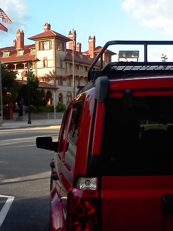

Rear cargo lights
Got some rack lights on today and ran some wires for front fogs/driving lights/and front roof lights. Still have to hook up the relays and switches but ran out of time, gotta take mom out for early dinner( it's mothers day). Here's the rear lights I installed................
