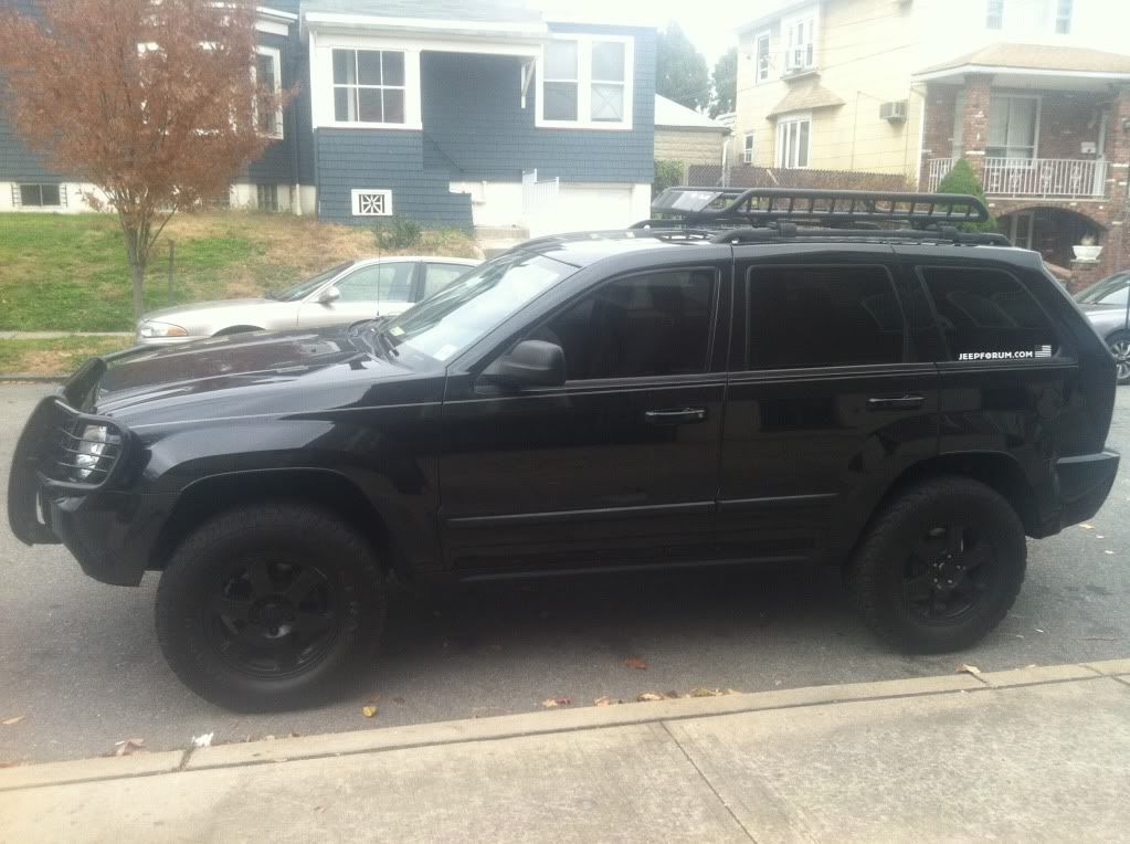

A little while later, I got started on the gutter guard front grill. I ended up using some expanded metal I got at Home Depot. First I removed the entire grill assembly. I cut all the fins out of the grill and started laying in the mesh. Once I had everything lined up the way I wanted, I actually used lashing wire to secure the mesh to the pillars. While I had everything apart, and had some extra material, I made a piece to go in front of the radiator at the bottom where it's wide open to rocks and debris. This piece was just zip-tied in to make sure it wouldnt rattle. The assembly was re-assembled and remounted.

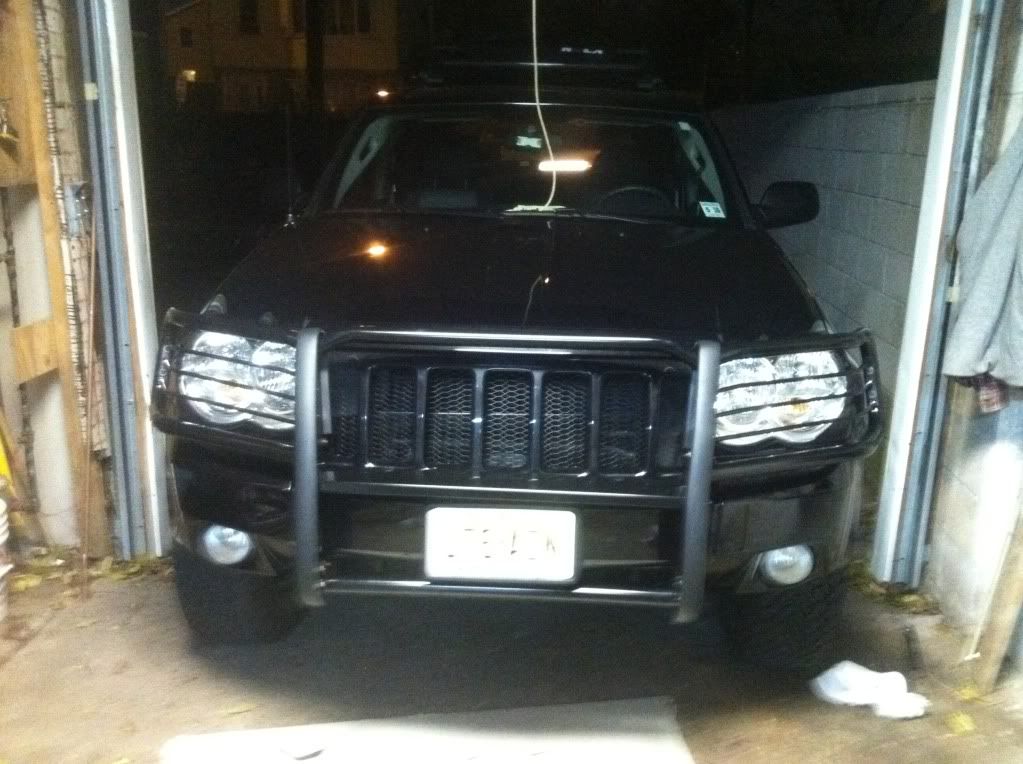

Finally, I got a Westin Brushguard from the GF for my B-Day. I def didn't waste any time throwing it on. I had to end up cutting holes into the mesh grill to allow the mounting brackets. But in the end it was a pretty straight forward install.

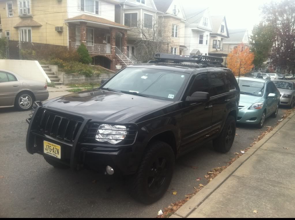

And this is how she sits today
Hopefully I'll be adding more posts to this as the build progresses.
