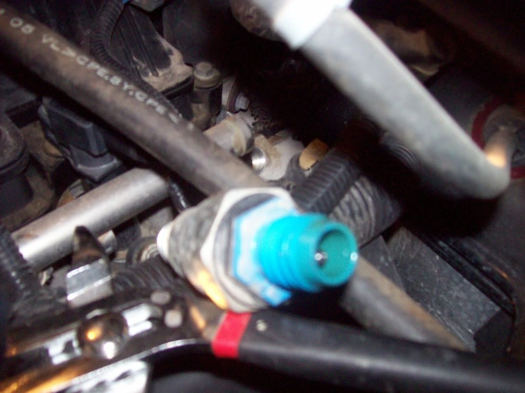

It just screws in and out. Caution: if you just drove from the shop to get the part, then the one you're taking out will be hot. There is a hose that seats on top of the valve - just pull it off. Used a set of channel locks to unscrew the old and set the new one. (If you look at the fourth pic closely you can see it threads in just past the rear of the fuel rail). Reattatched the hose to the top of new pcv valve. Piece of cake!

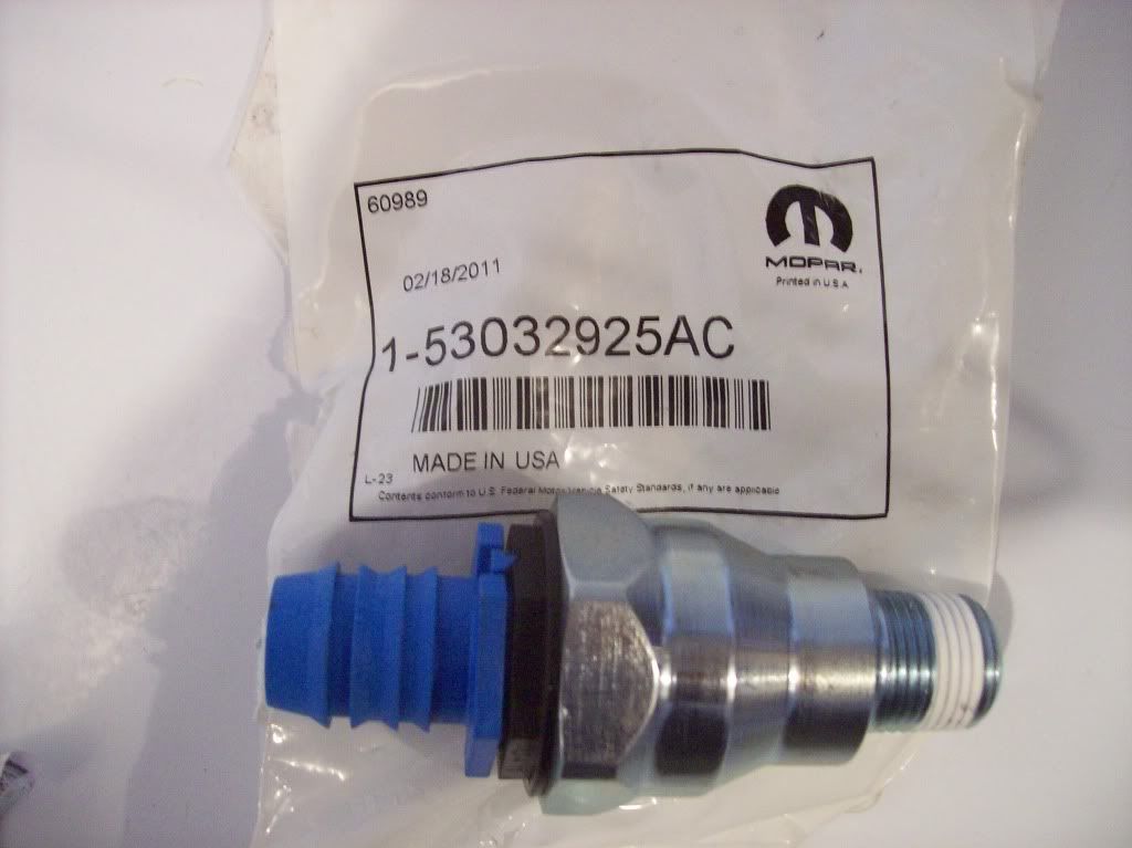

New pcv valve with mopar Part#:

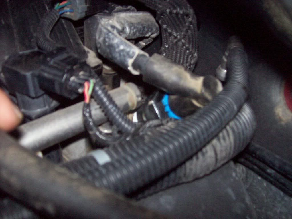

PCV valve with light shining on it "glowing" in the back:

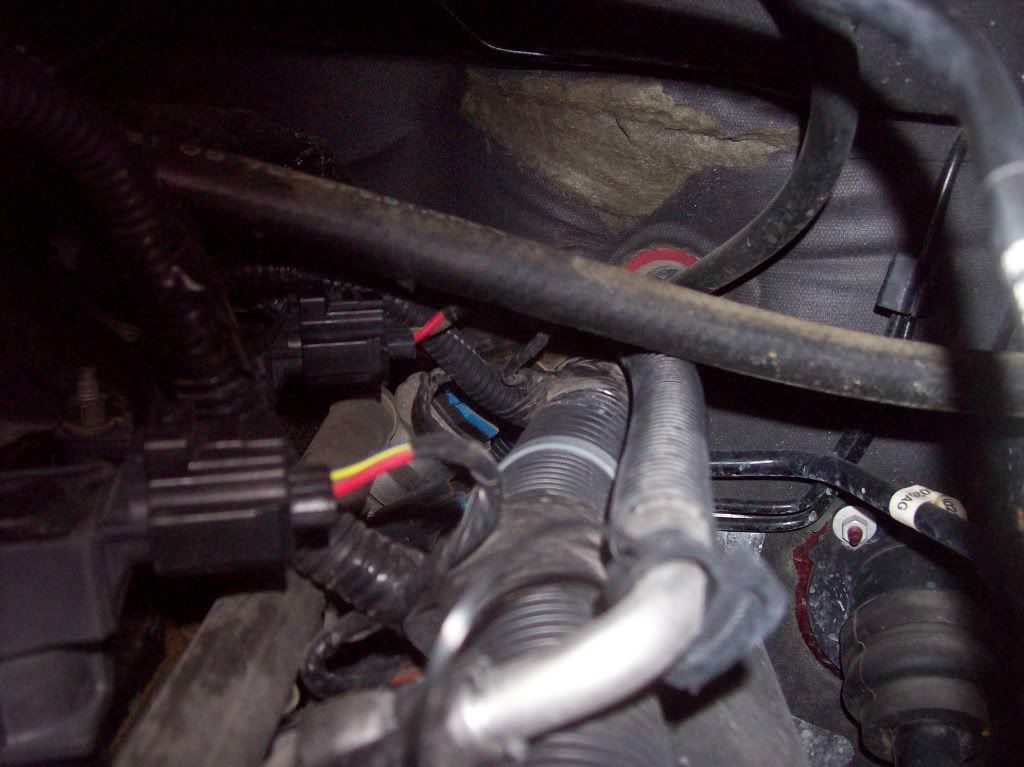

Blue clip (this is actually the flange to the plastic piece fitted to the body):
Threaded slot just beyond fuel rail:

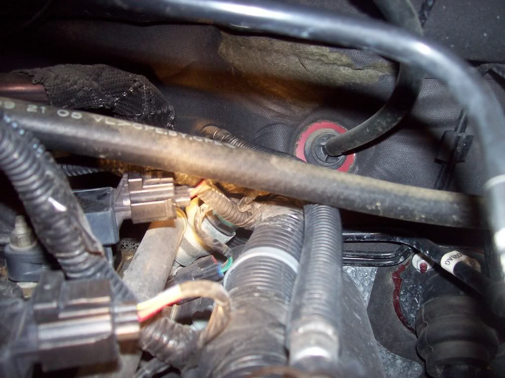

New pcv valve threaded in with hose boot reattached:
