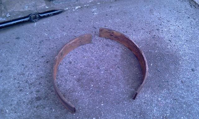

I had the exact same thing happen to me. It was during one of the recent blizzards we had up here in MD. I was one of the few people out in the snow (gotta love owning a jeep ;-) when I heard a loud bang and the back end started getting squirelly. I limped it to my garage and couldn't see any thing obviously wrong with the wheel/tire. In order to pull the rotor off to inspect the parking brake, all you have to do is remove the caliper and and a rubber O-ring on the hub in front of the rotor. when I pulled it off My brake assembly fell out in about 40 chunks of metal. Fortunately it wasn't driven far enough to damage the abs sensor or notches on the axle. Funny thing is when I called the dealer for the parts, they sell the baking plate fully assembled with all of the parking brake hardware and shoes already mounted. Seemed a little odd to me, but after reading this, sounds like a this a common problem and easiest to sell it this way to fix it quicker. To replace it I will only have to remove the axle and replace the O-ring in the axle, so shouldn't be too much work, but I haven't had time. This was just the driver's side, but after reading this, I think it's right time to pull the passenger side off and maybe order a replacement for it. As a side note, the rotors were severely scored on the inside, so it looks like it was frozen locked for a while. I'll update on how difficult it was to swap and if there were any issues associated with the cable itself, but it appears ok upon initial inspeaction.

Inside wasn't as bad as I thought. Nothing has really disintigrated. The friction material as come off the shoes. This is on both left and right sides. The cable is still fine on both sides. Pulling the lever pushes the shoes (minus the friction material) outwards although it doesn't seem to move both shoes outwards equally. I don't know if it should when the drum isn't on.
