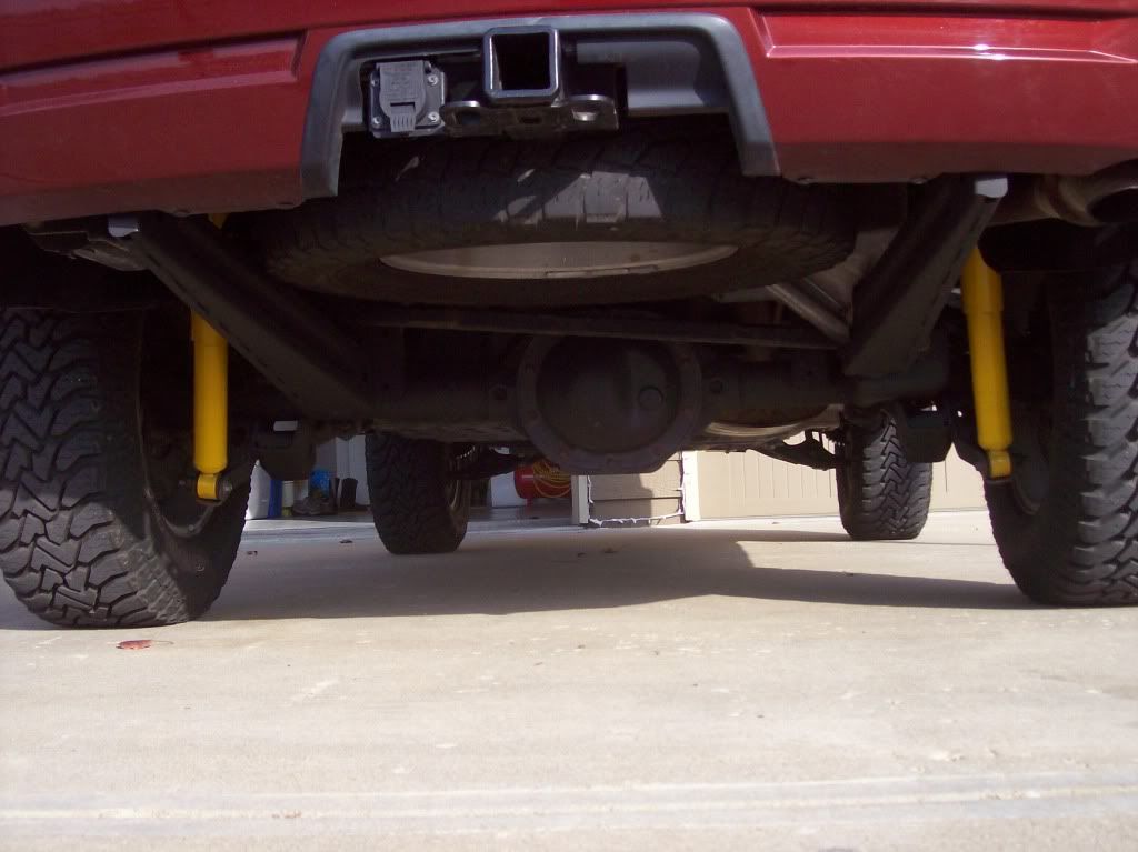

Yep. Wire brush, sand paper, wire wheel on a grinder - whatever you want.
Works great:
