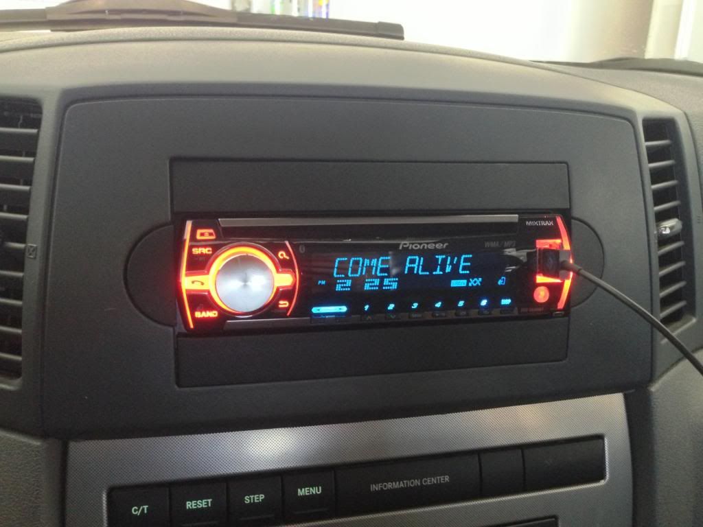

I bought a single din unit off Crutchfield that came with a faceplate to make it an exact fit. Ran me about $200, and it's got USB, AUX, BluTooth streaming and calling, and a bit more as well. Plus it made an INCREDIBLE difference in the sound quality of my music.

Can you post a picture of the Din1 setup? The audio store guys said they could do that, but I wasnt sure about how it would look so I held off.

A can change the colors to whatever I want. I never use CDs. I store all my music on my phone and use that. Theres plenty of touchscreen units out there that will sync with your phone and allow you to scroll through music, pictures, video, etc. I still have steering wheel controls, and can assign them to whatever I please.
That looks great, much better than I expected. Did it come with a microphone for the handsfree calling and does it work well? Will the phone automatically connect once it has been paired? This is for my wifes Jeep and she is going to want something that is pretty user-friendly.

Yes, it comes with a microphone and generous length cord so you can put it where ever you please. Mine is in front of the instrument cluster. So long as your blutooth is on, it automatically pairs it up for you after the initial connection.
