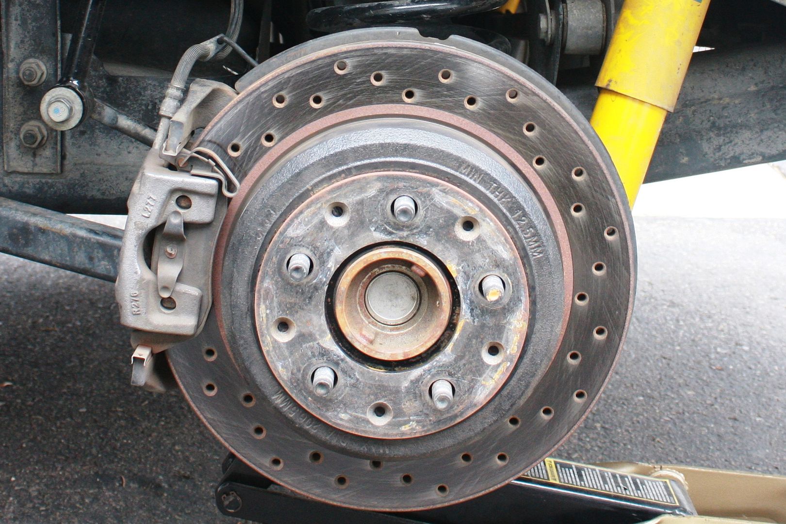

As you might have noticed I also got a set of Stillen rotors on sale from Kolak. I love these things! I only got the rotors, because the Mopar pads that the dealer had put on were still new. Even with just a rotor swap I felt a noticeable braking improvement! These really helped make up for the extra weight and rolling resistance.
I know this was a while ago but I just got my lift and tires put on and I have noticed a serious drop in braking performance. Will the Stillen rotors help with this? And if you don't mind me asking, how much will they set me back if I decide to grab a set in the future?
