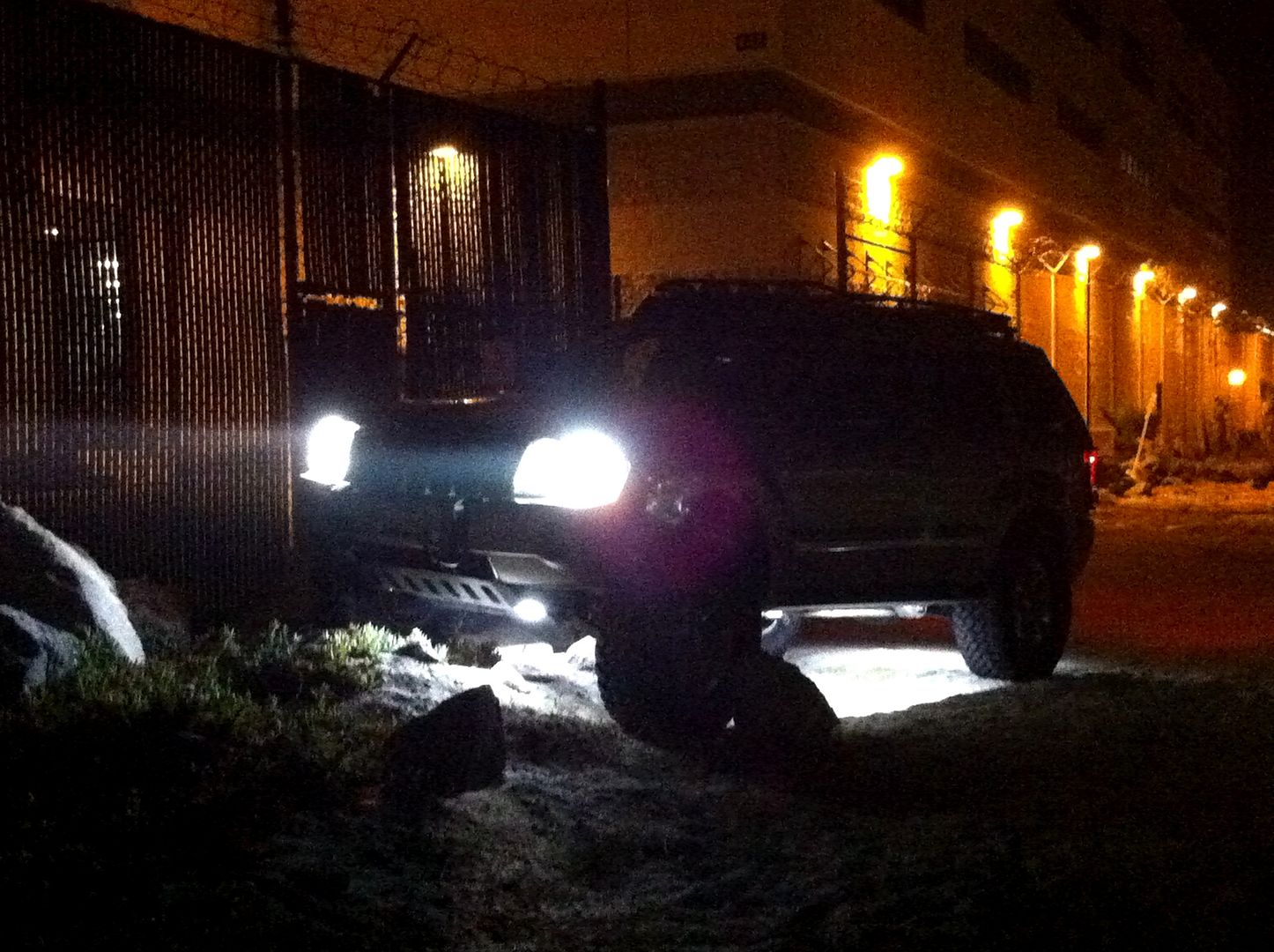

Update!
I had to go out the other night and decided to snap some night shots of the rock lights. I pulled up onto a pile of rocks and sand to try to simulate off road conditions where I will need to see rocks under the Jeep. Unfortunately all I had was my phone which doesn't take the greatest night shots. I will have to bring a real camera the next time! Enjoy!

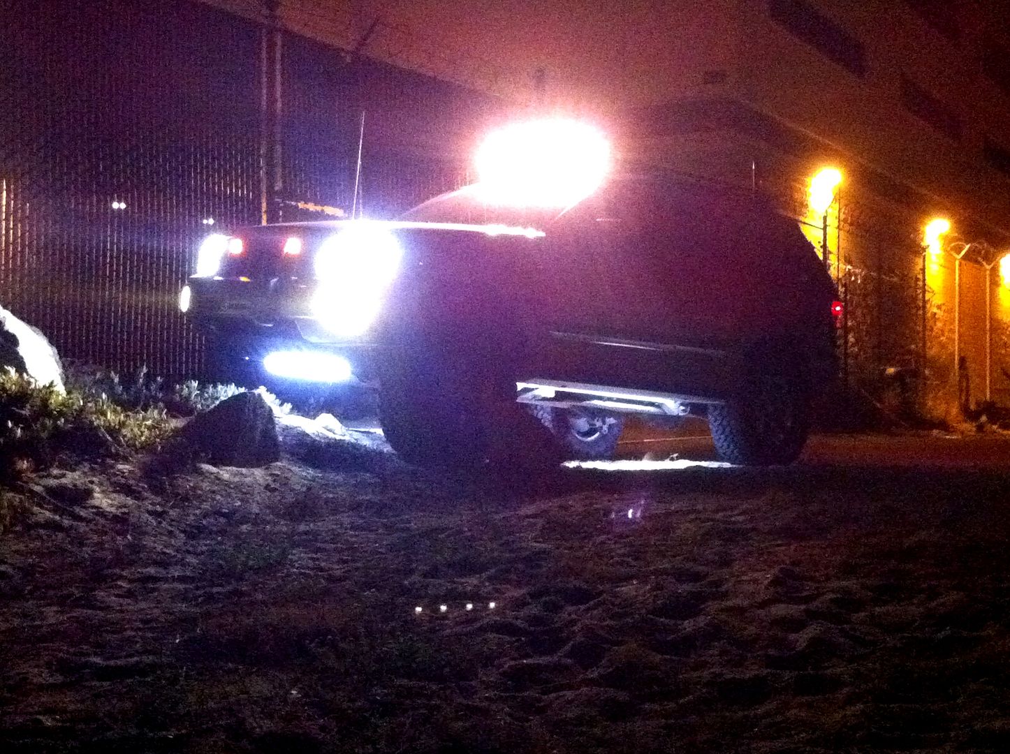

And a few more...
Nothing like a little extra light!

You have a crap load of lights. I can't get over the output on those LED's. Sweet. They would be nice entry/courtesy lights too. My WJ had a light strip under the rocker that came on when I unlocked the doors with the remote. Was a nice litttle feature.
