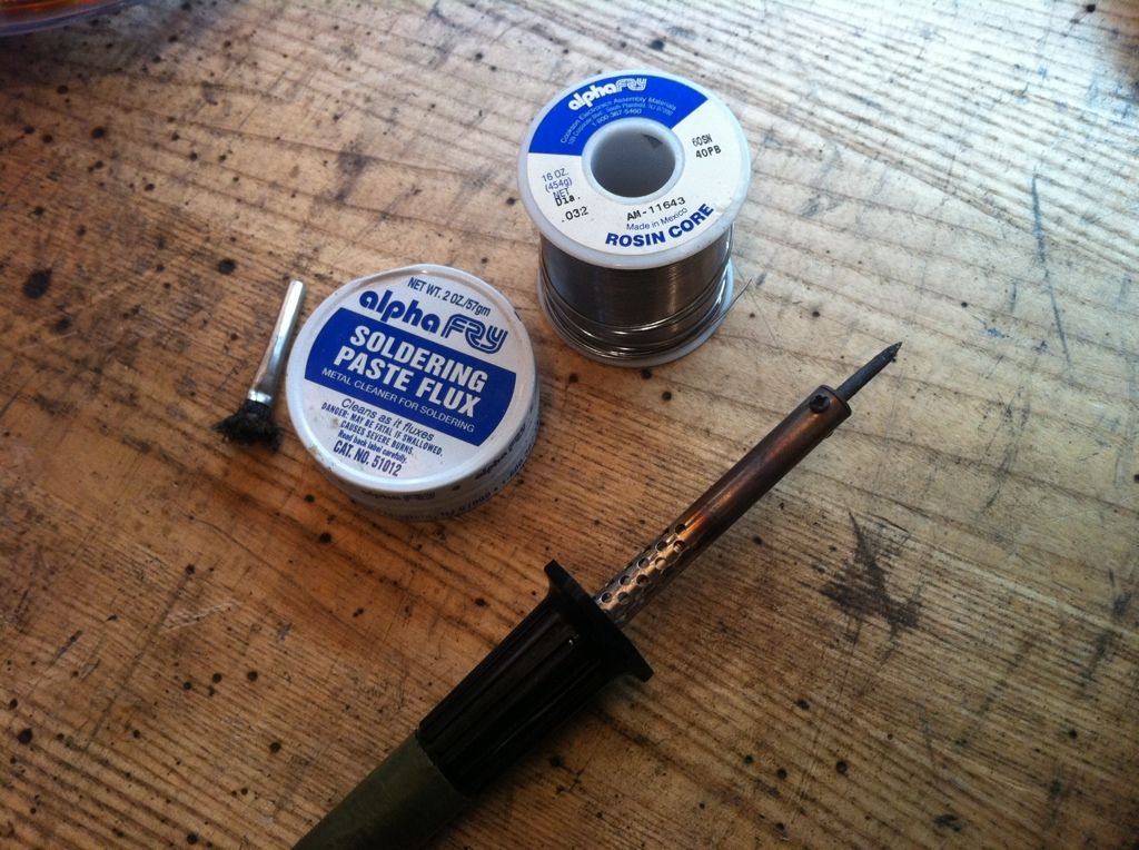

I soldered mine with a big solder gun, not a nice electronics one. Make sure you are using a quality solder, and I like to use flux.

How hard of a time you guys having soldering up the connections? Ive tried my cheap walmart iron and all it is doing is burning the white circuit board. I also attempted useing my cold heat iron but the tip is to big.
Are you tinning the wire first then reheating to make the connection or are the pooling the solder on the light contact before placeing the wire on? Needless to say my soldering skills are way sub par
Sent from my DROID2 using JeepForum
What I did was first trim the silicone off the tip and expose the two leads. Then I tinned the wires. Lastly I placed the tinned tips onto the leads and heated them until they milted and stuck. Last thing was to use heat shrink on the joint. I am extremely amateur when it comes to soldering. So if I can do it anyone can!

Just a quick update since I finally got my lights. I used the same method as Omelet just posted. (tinned the wires , etc.) The easiest way I found to do it was to seperate the silicone from the circuit on the end with a fingernail, then bend the contacts down at a 90 degree angle. Then just snip the piece of silicone near the first led. (ignore the rusty plyers in the pic. They serve their purpose.) I think Nate also mentioned using liquid tape in an earlier post. I did that as well. Coat the leads then cover with the heat shrink. That way the conections should be water proof.
Also there was some talk about what kind of solder gun/iron to use. I have a nice electronic soldering gun that heats up instantly that I was planning on using but, while at Home Depot, I decided to pick up a pencil torch to heat the heat shrink. (tired of using a lighter) For a few dollors more they had a small kit that included soldering tips. I used it for the whole project and it worked great. So if anyone is looking to buy a soldering gun I would recomend this little torch. Small, fast, versital, and portable. (just have to be sure you have butain on hand to refill). For $15 you can't beat it.

I have the cheapest soldering iron there is So this is proof that you don't need anything special to get it to work. This is what I have been using for all my wiring:
