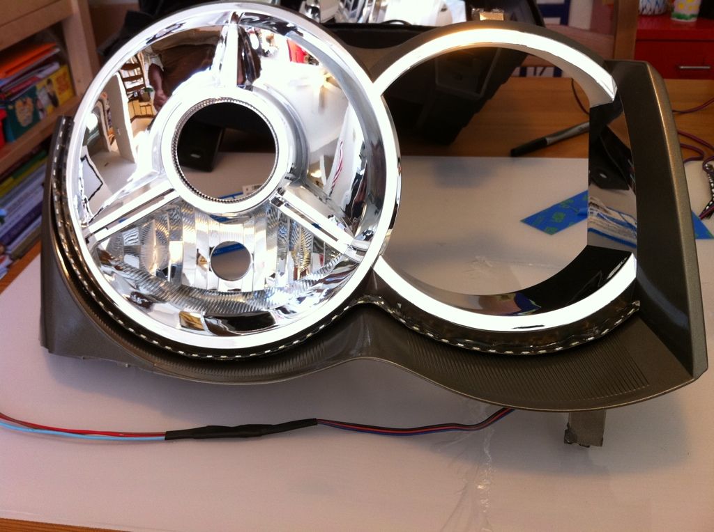

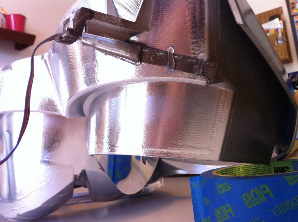

The LEDs are now installed!
With the wires running out the side and underneath.
I also got the projectors swapped out. Pics to come later...
I am about to put the clear on the side markers and then it will all be ready for reassembly!!!

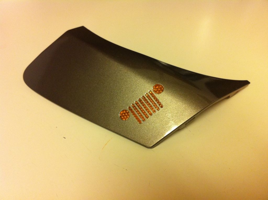

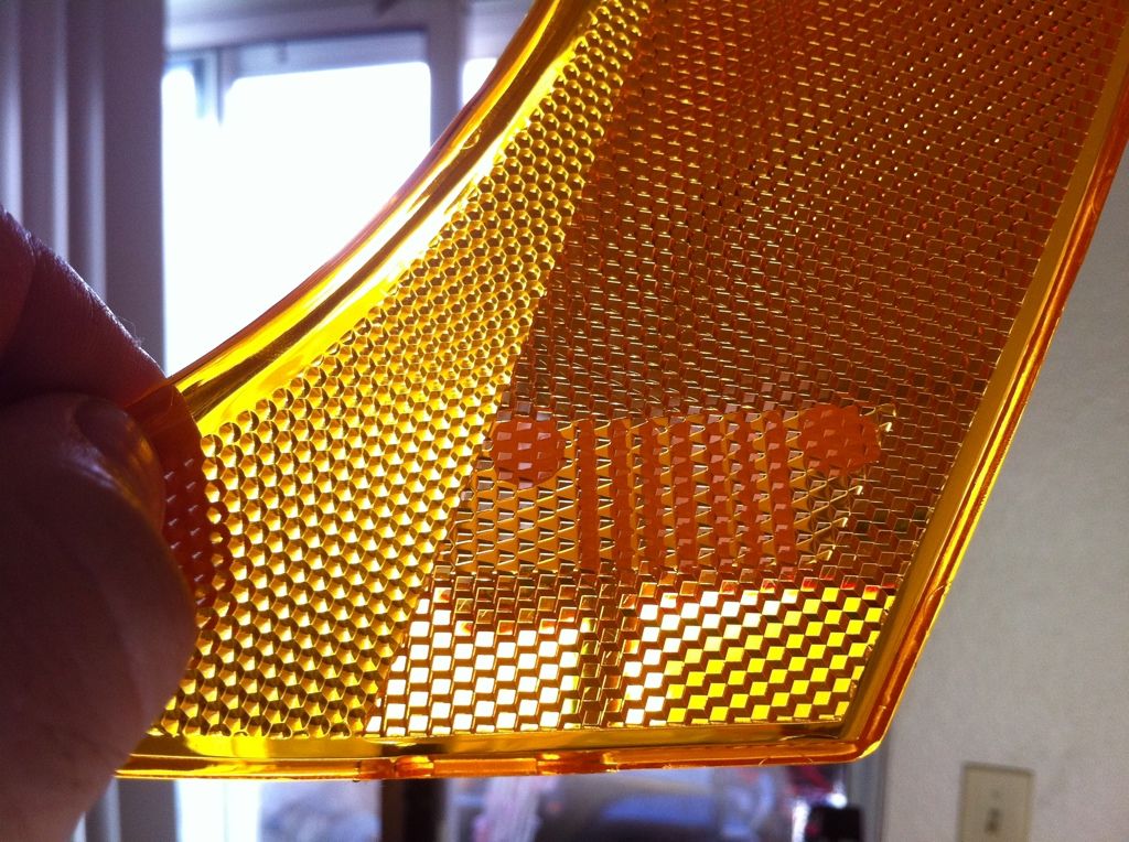

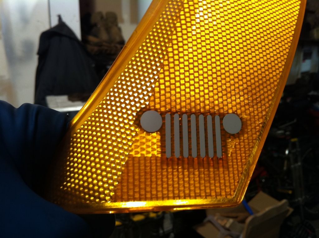

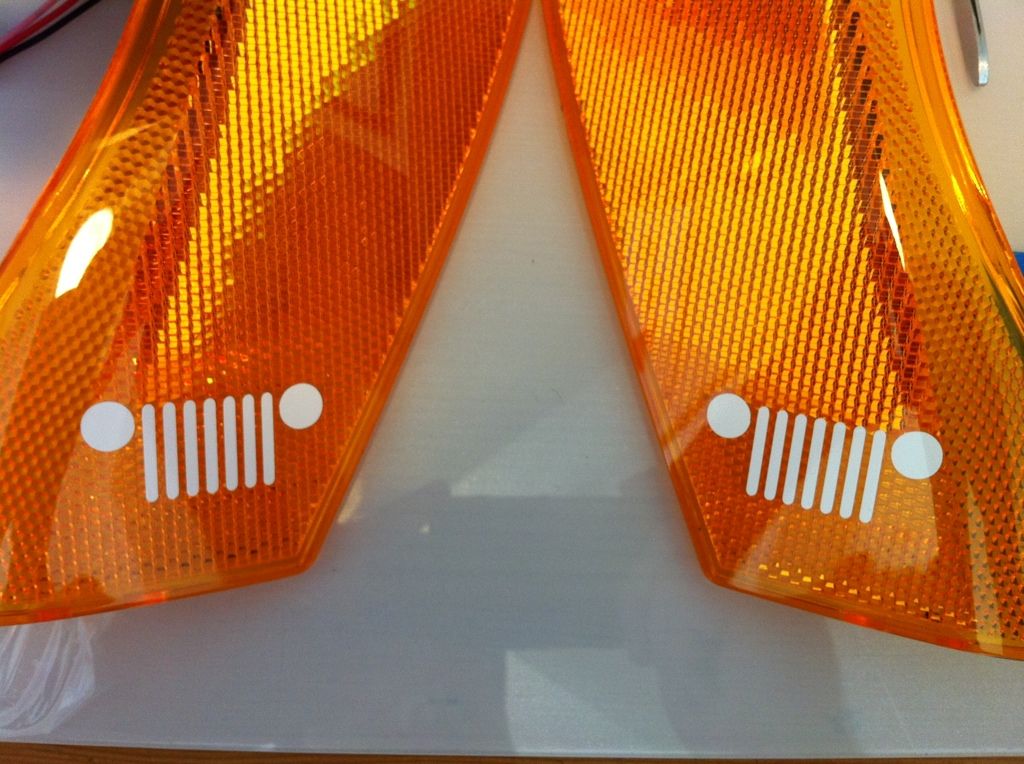

Now for the marker surprise! Not my original idea. It was either this or a MOPAR "M". I went with this because it was more the shape of the window than the "M" would have been.
I got a set of stickers made to the dimensions of the window. (Thanks again JCDubya for the hook up )
View from the inside:
After I scuffed one up with sand paper:

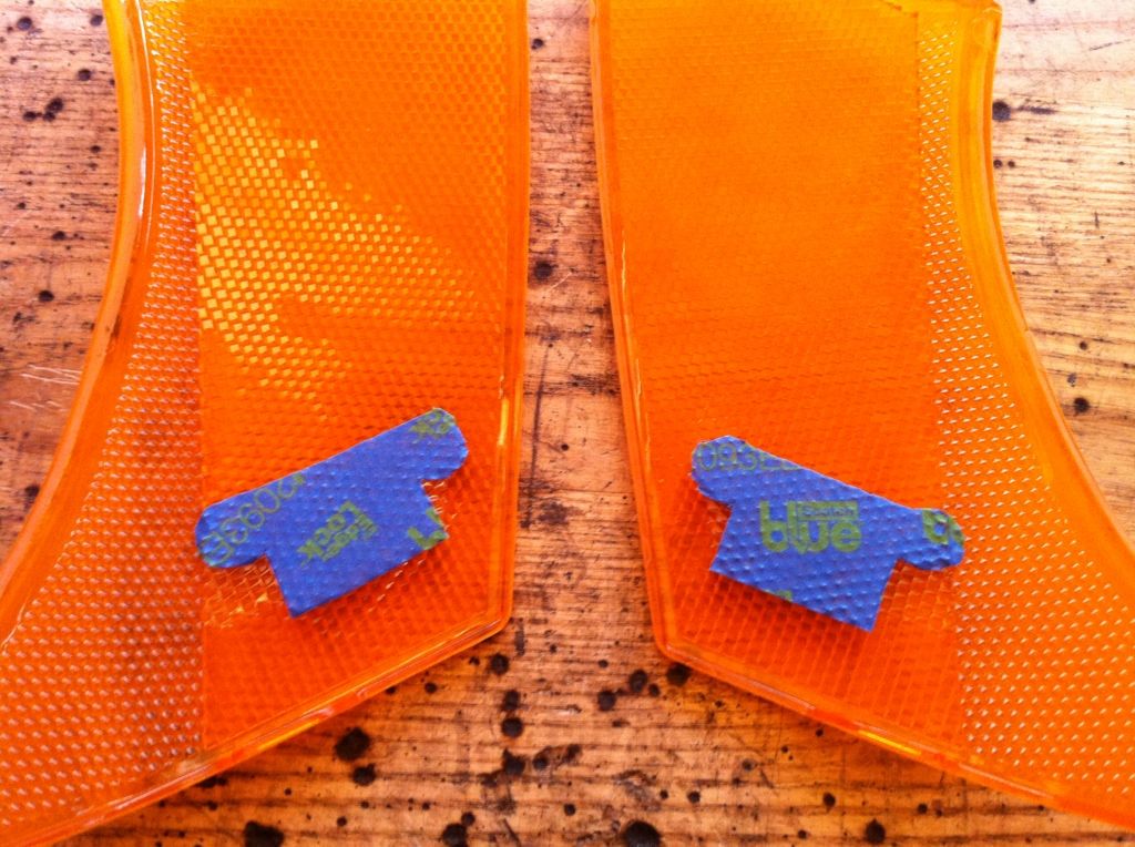

After they were both sanded I applied tape to the inside so light would only shine through the sicker and not glow around it:

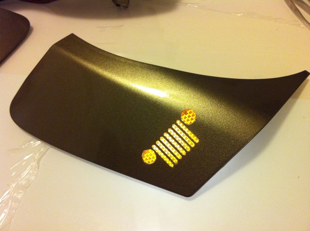

Once they were painted and dried:
And with some back light:
Omelet is offline

How did you get in there and peel up the sticker?

What do you mean?

From what I can tell it looks like you put the sticker on, painted the whole thing, and then peeled the sticker off, is that correct?
I was just wondering how you went about getting the sticker up without damaging any of the paint work you did.

Oh Right! I used a scalpel and tweezers. I did the primer and base coat, then pealed the sticker (while it was still wet), and then applied the clear.
