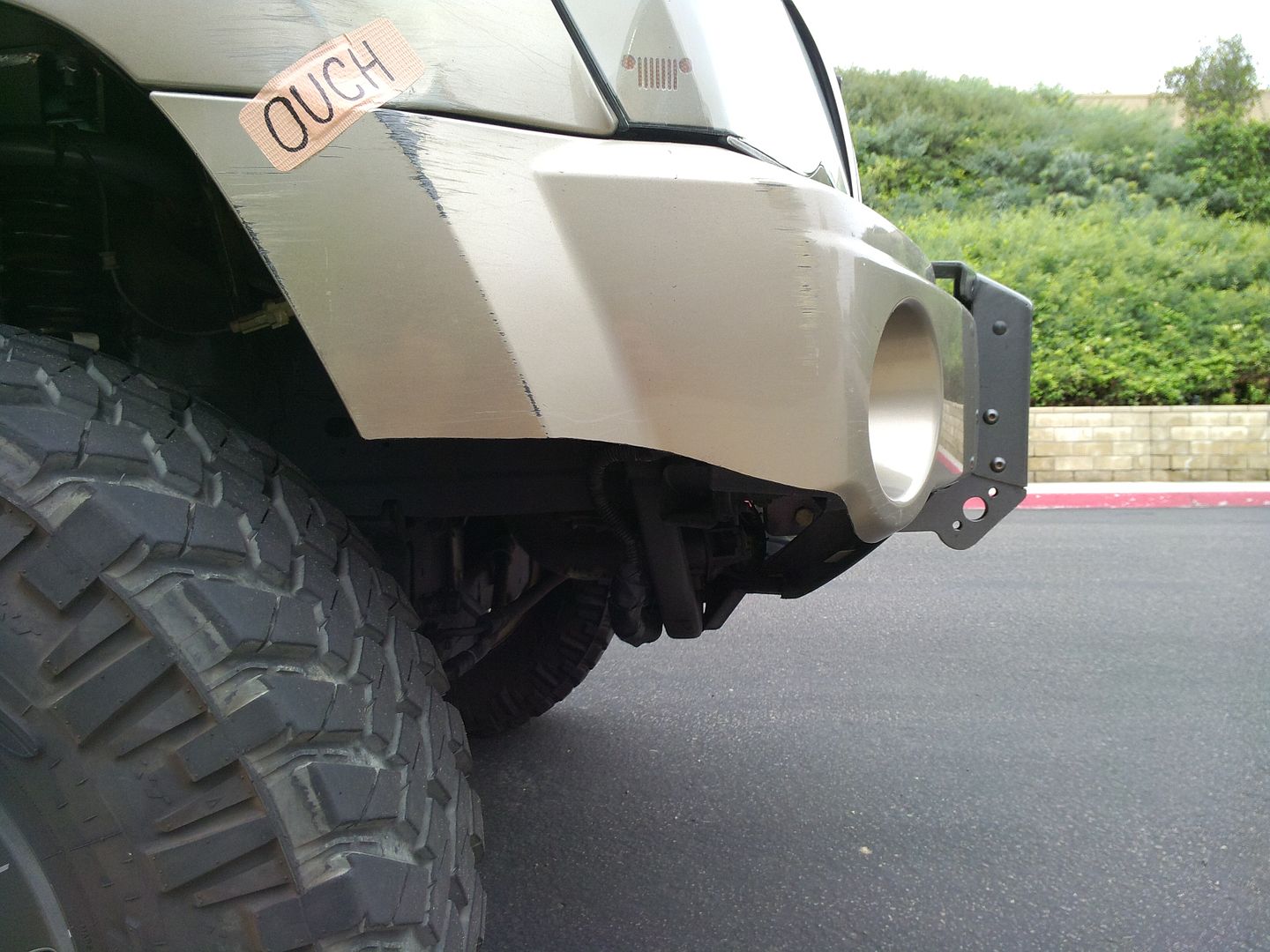

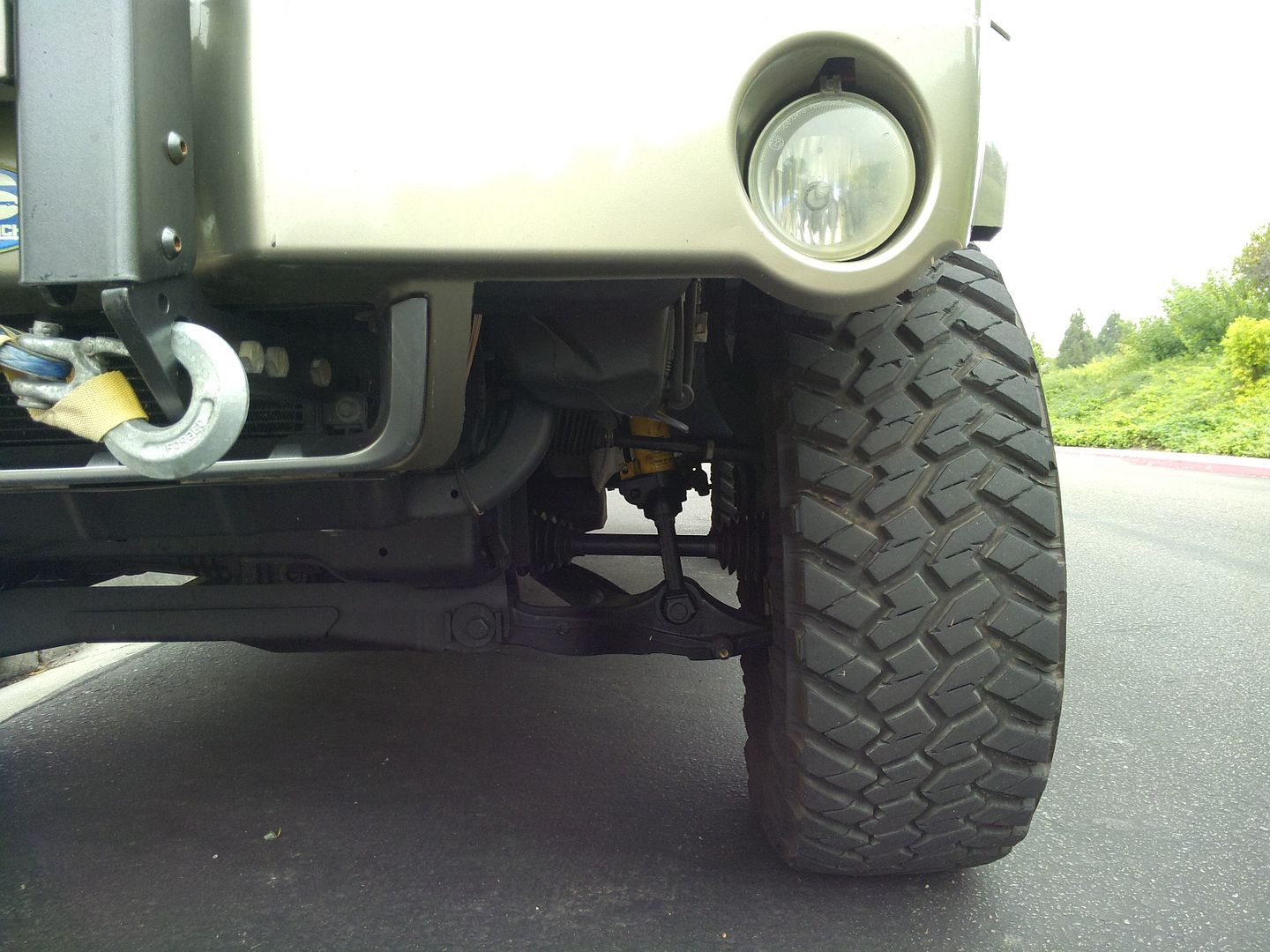

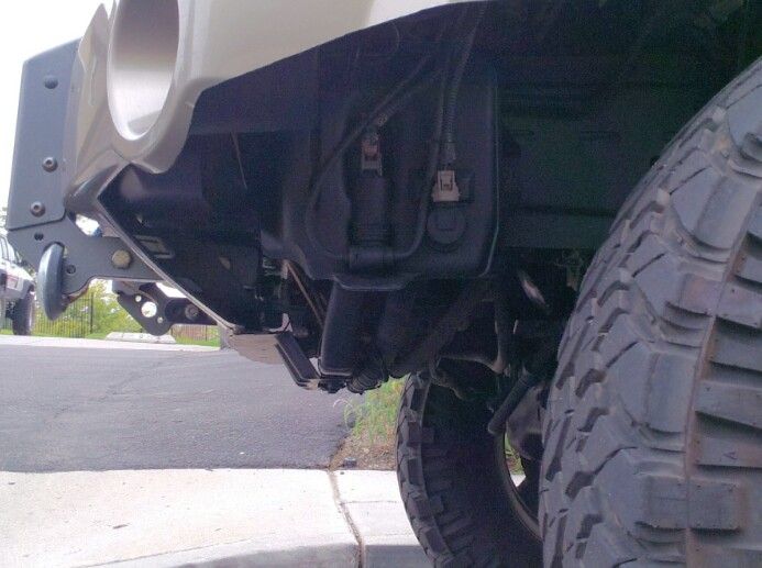

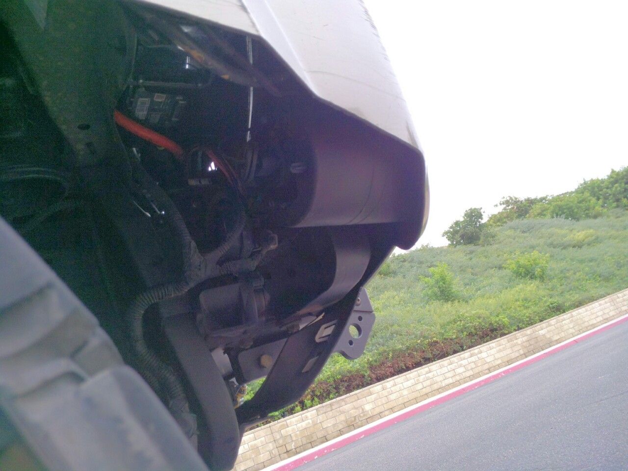

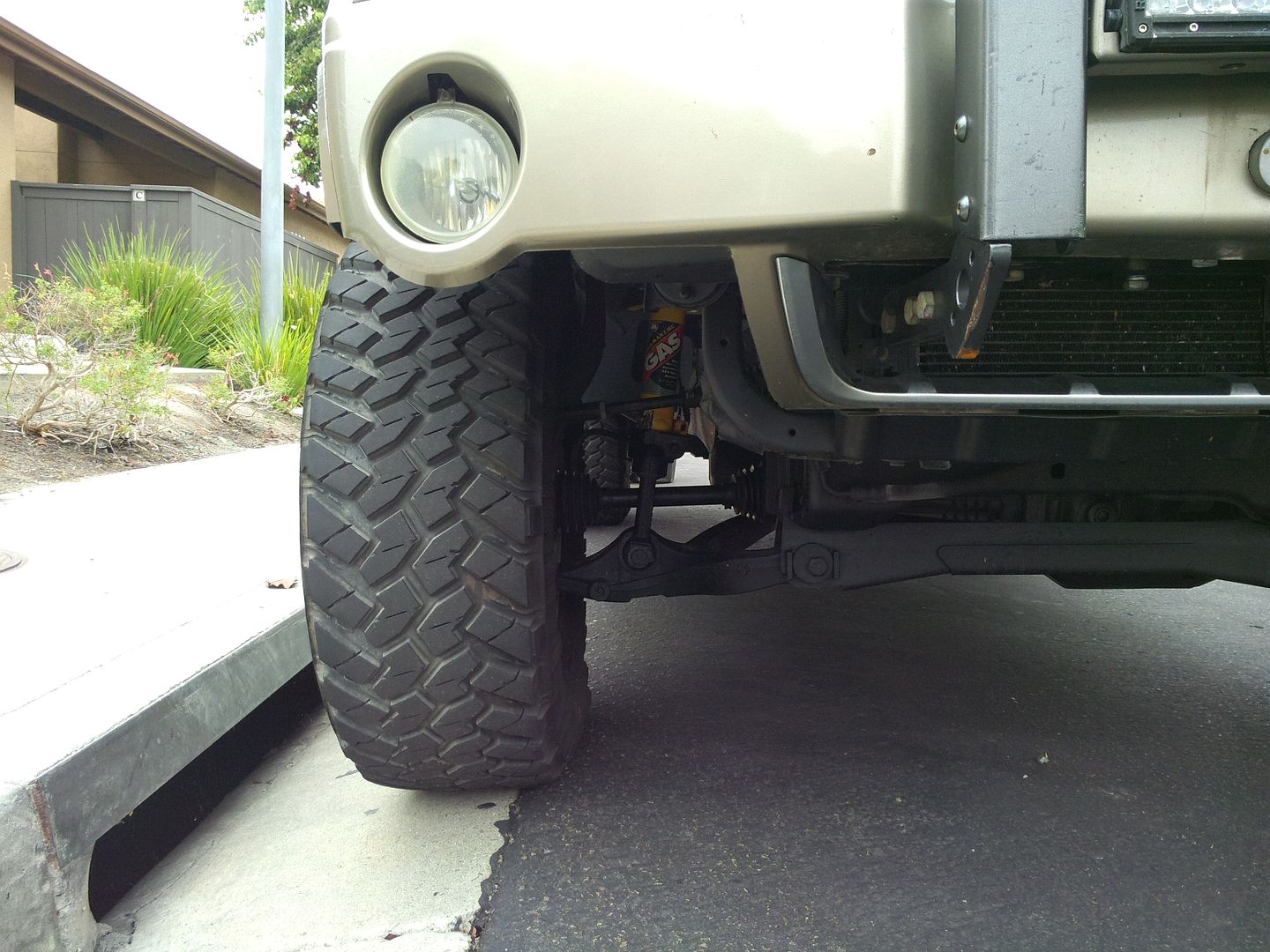

Ok a few guys have been asking for more info on the trimming I did to my front bumper, so here you go!
First I had a basic idea of where I wanted to cut. I wanted to try to keep it as clean as possible and not have it looking goofy or hacked up. So I applied some painters tape to the areas I was wanting to cut. Then using a sharpie I marked exactly where I was going to cut. I used a dremel with a plastic cut off wheel to do the cutting. Lastly I used a sand paper tip on the dremel to smooth out the freshly cut edges.
Straight on from the front:
Straight on from the side:
And looking up under both sides:
You can see the washer fluid bottle, but I had previously painted it flat black so it blended in better. So it is visible and does hang down slightly, but your eyes are not drawn to it and it doesn't really stick out enough to clip a rock. When I painted it I left a strip from top to bottom unpainted so that I could still see the level.
You can cut the sides up higher like Jay did if you'd like. I only went up as high as I did because the ballast for my fogs are bolted right behind there.
I hope this has helped! Let me know if you need anymore help.

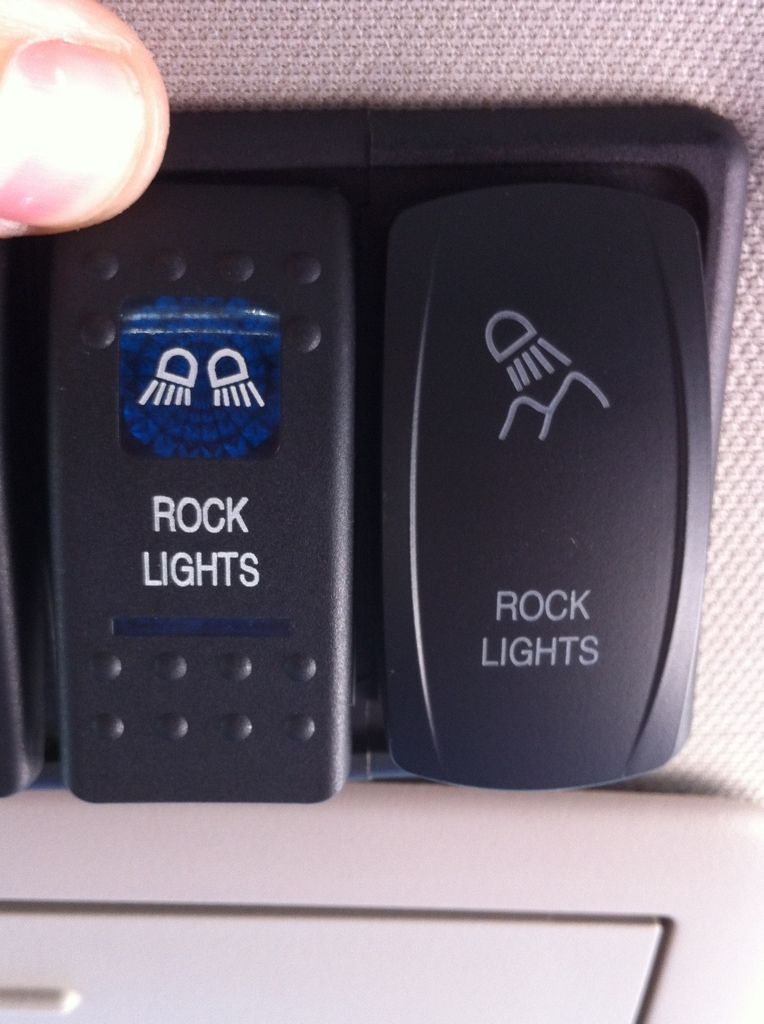

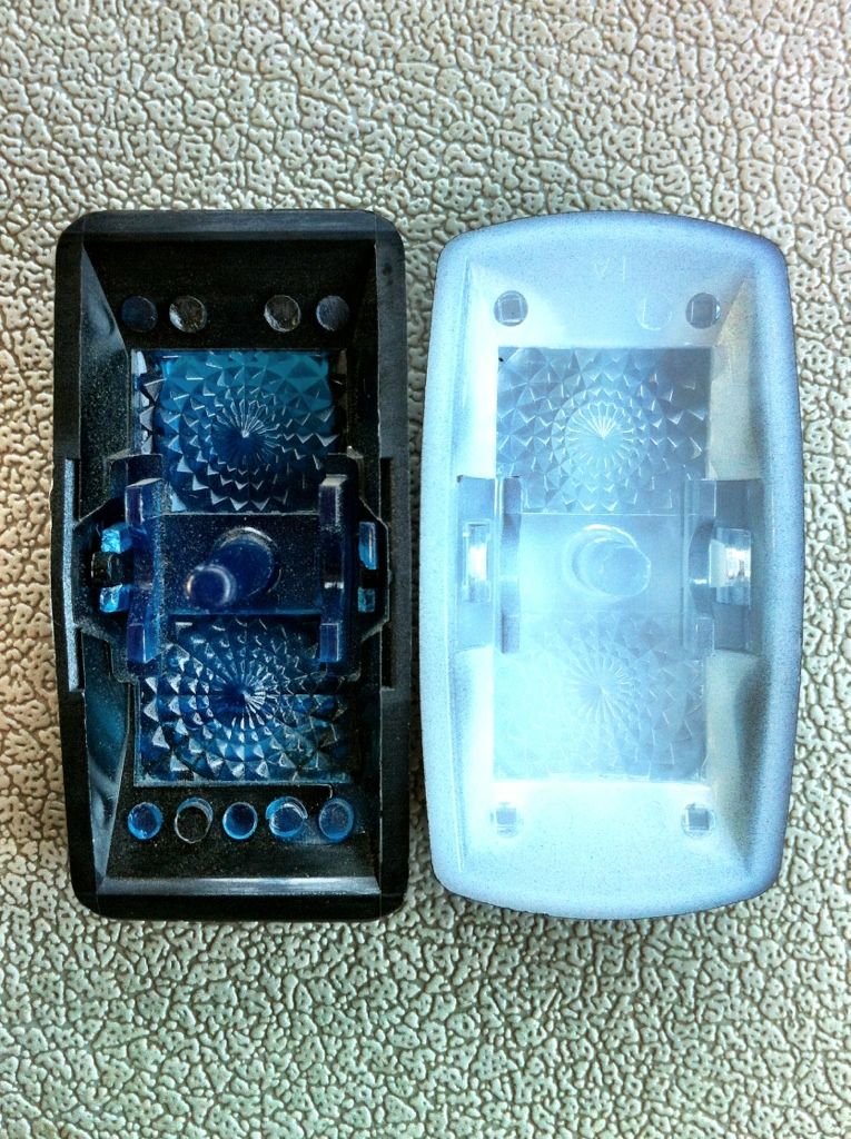

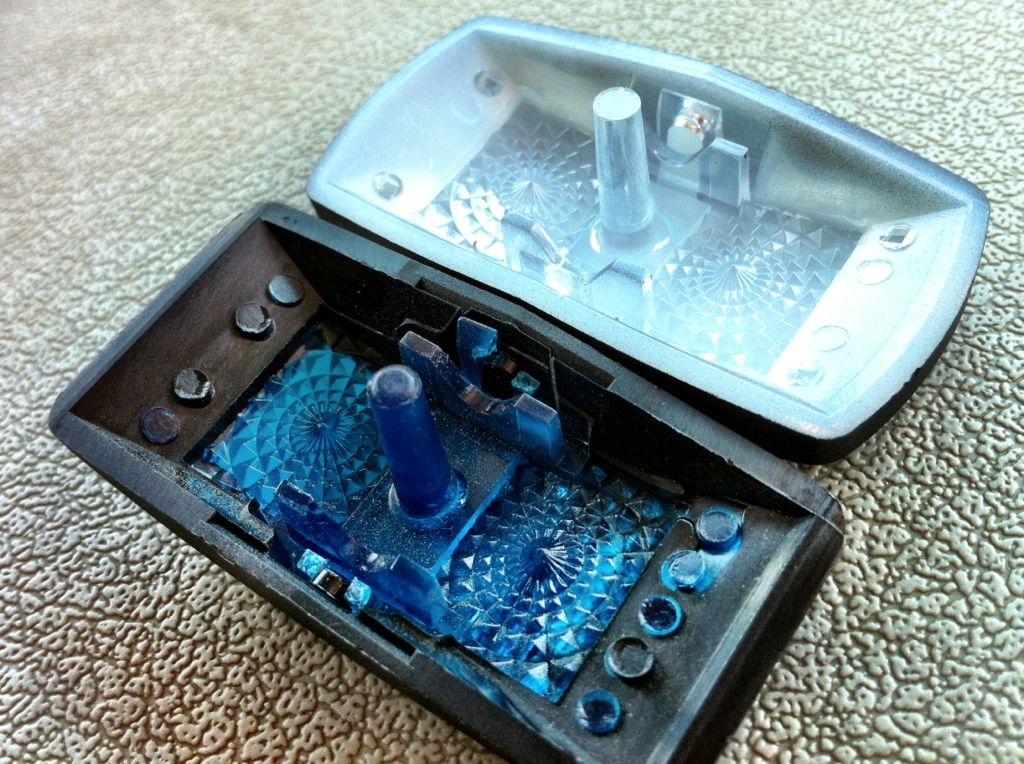

So a few weeks back the cover on my rock light switch broke off. I took the opportunity to check out OTRATTW's new switch covers and see if they were any better. Once I got the new cover I compared it to the old.
Old on the left and new on the right:
It appears to be a little more hardy than the old cover. Anyone who has used this type of switch for a while knows the cover will easily break loose if whacked. The clips that hold the cover to the switch look to be slightly thicker and the clear plastic seems harder and less brittle compared to the blue plastic.
Time will tell whether or not these last longer. In the mean time I also ordered their "Passenger Eject" cover for the switch that currently has no purpose and their "Tiki Mask" cover which will probably find it's way into the rear. I have already received a few inquiries from some concerned passengers
I now plan to place another order to replace the rest of my switch covers
