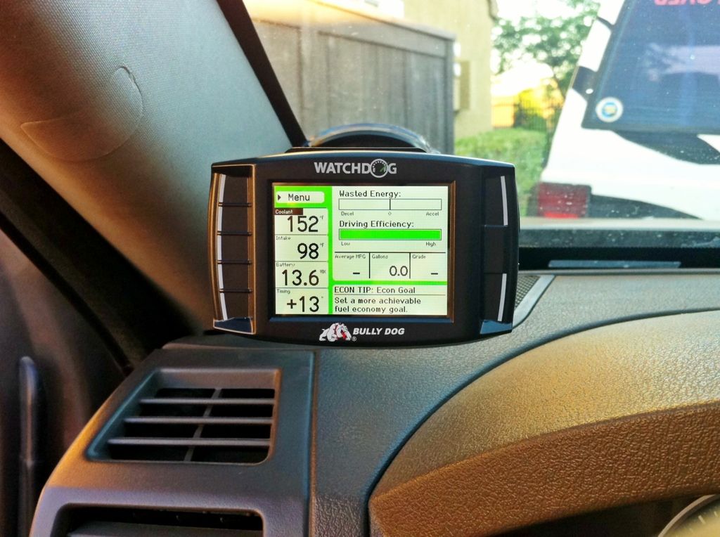

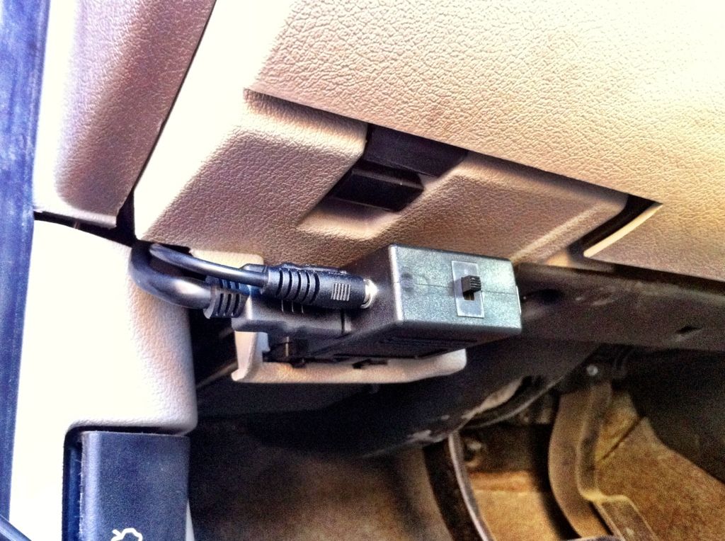

Ok here's the quick instal with some pics!
This plug went into the OBDII pot. From it there is a wire that goes to an ACC source (I used the fuse box that is right behind the dash, same one I have been using) and ground. The other is an HDMI cable that goes up to the back of the WatchDog. I think there is a better way for this to work, but this will do for now!
It came with a suction cup mount so I put it here.

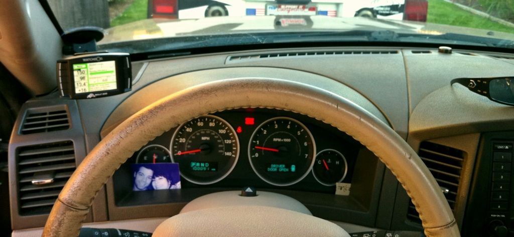

The view from the driver seat.
And a nice close up. This was before I had it fully set up. Notice the Econ tip at the bottom! Haha, after looking into it the goal MPG was set to 25! Like that was going to be happening

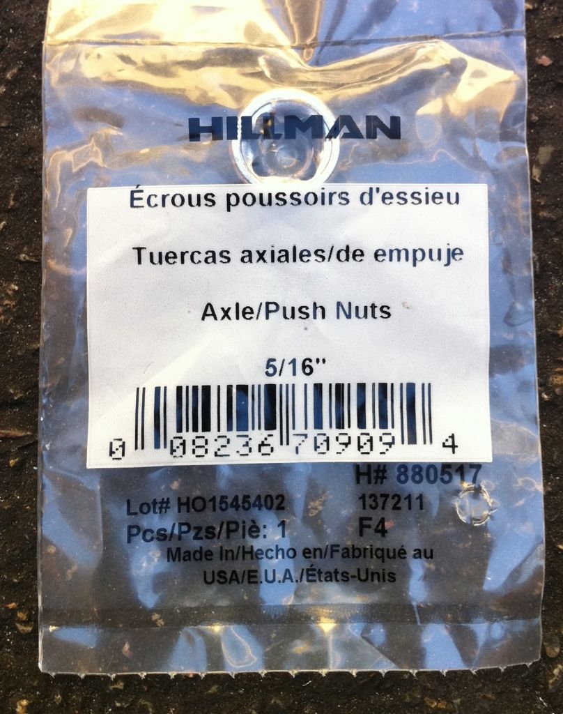

Time for a little security! Since I live down here in North Mexico I am always worrying about some guy with sticky fingers walking up to my Jeep and taking something that isn't his. Most items are either bolted on in such a way that it doesn't just come off, the mounting hardware is hidden, or I don't risk it and keep it inside. Now that I have this pretty new light bar I would like to use it and have it still be there when I need it. I am still devising a plan to secure it better but for now I picked up a couple of these bad boys (push nuts) :
After smashing the crap out of them they are not going anywhere easily.
This is only a temporary despise for the bolts, but it will work for now
