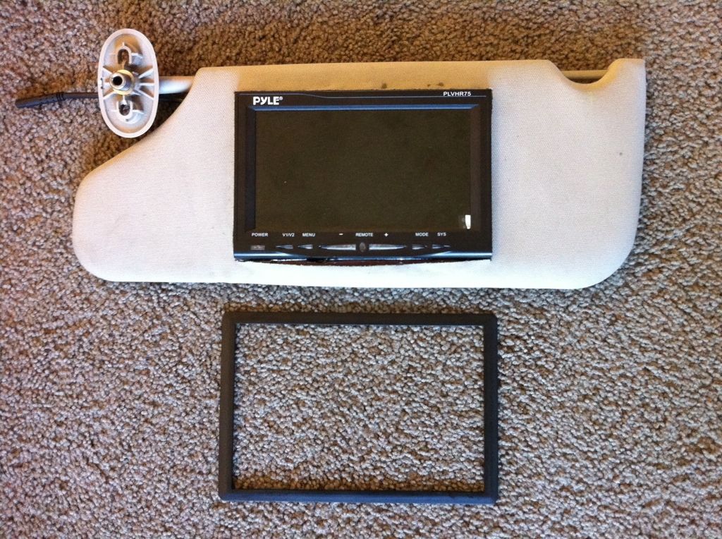

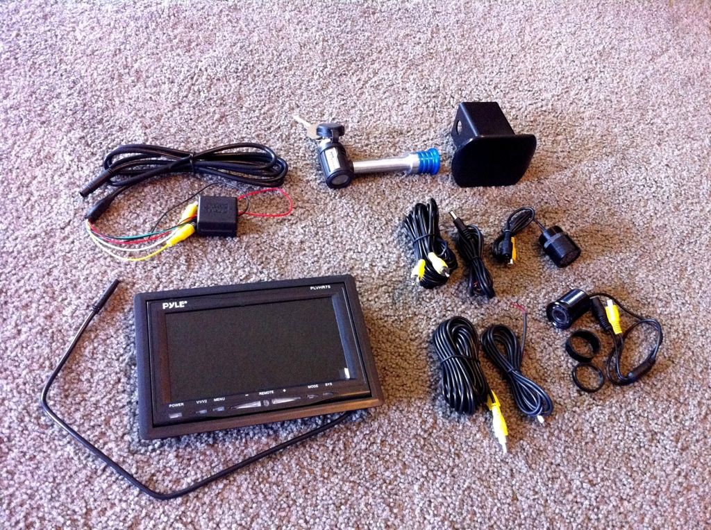

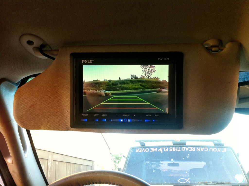

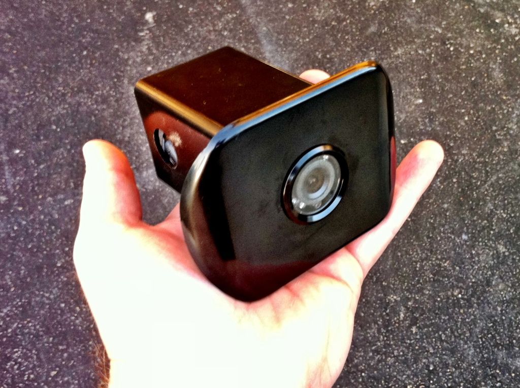

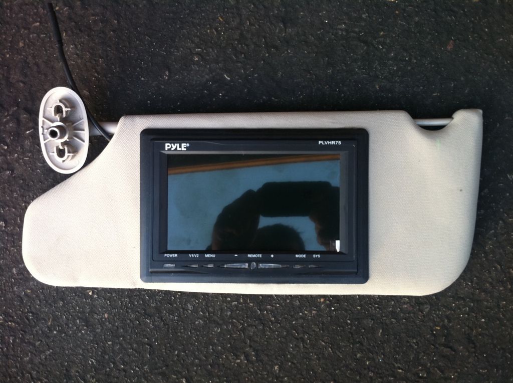

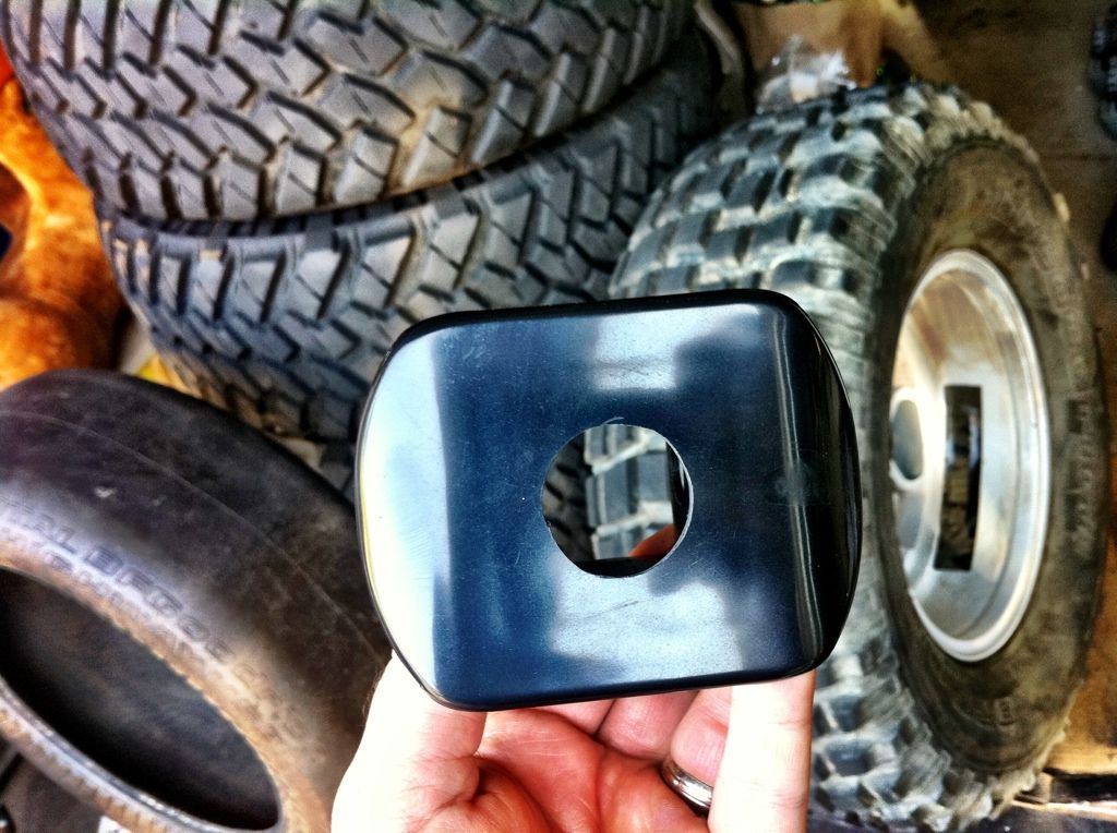

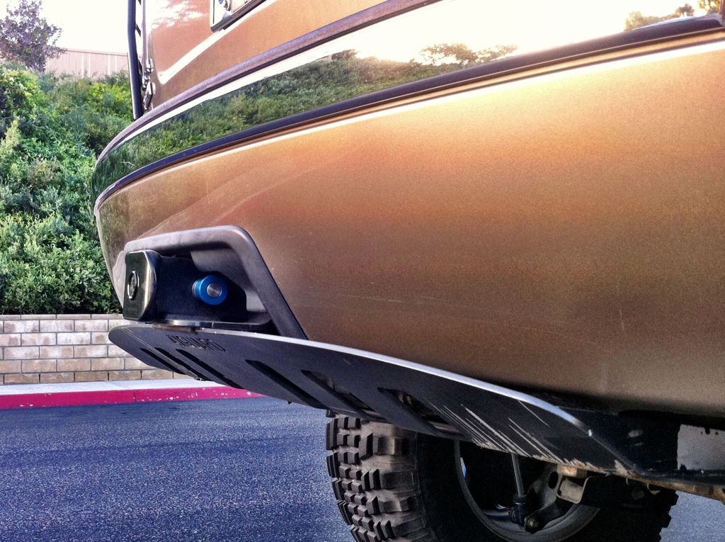

I have had this planned for some time now, only just now decided to fund it! Have you ever been wheeling going up a steep obstetrical or hill, and wished you could see something besides your hood and the sky? Funny me too!!!
I didn't want to buy a bunch of high dollar stuff for this, so I got on Amazon, did some searching, read a bunch of reviews, and finally made my purchase. I got a 7" display, 2 cameras, a plain hitch plug, and a hitch lock. It all came in a couple weeks ago, but I haven't been around to mess with any of it until now.
The cameras are pretty basic and cheap, but the reviews were great so I got one for the rear and one for the front. They include different collars so you can flush mount them or angle them.
The hitch plug is a basic $3 piece, no frills. That way if I crack it, or smash it wheeling I wont feel too bad. I measured the camera and drilled a hole for it.
I decided to flush mount the rear camera for now and see how I like it.
I wired it all up to a spare battery so I could make sure the camera was aligned properly.

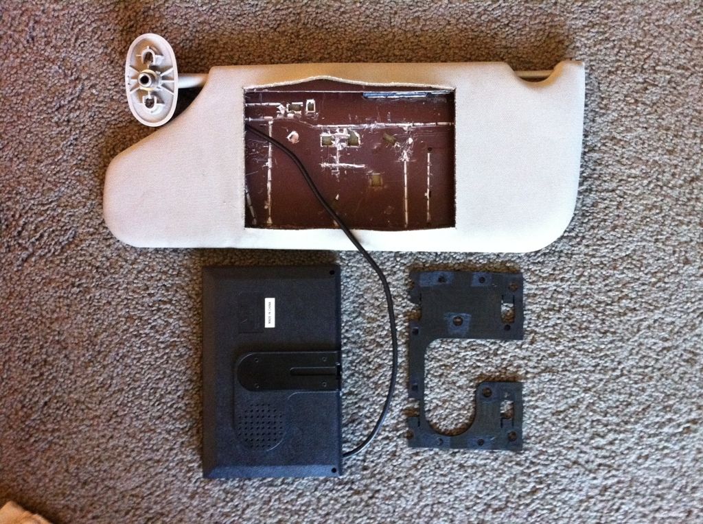

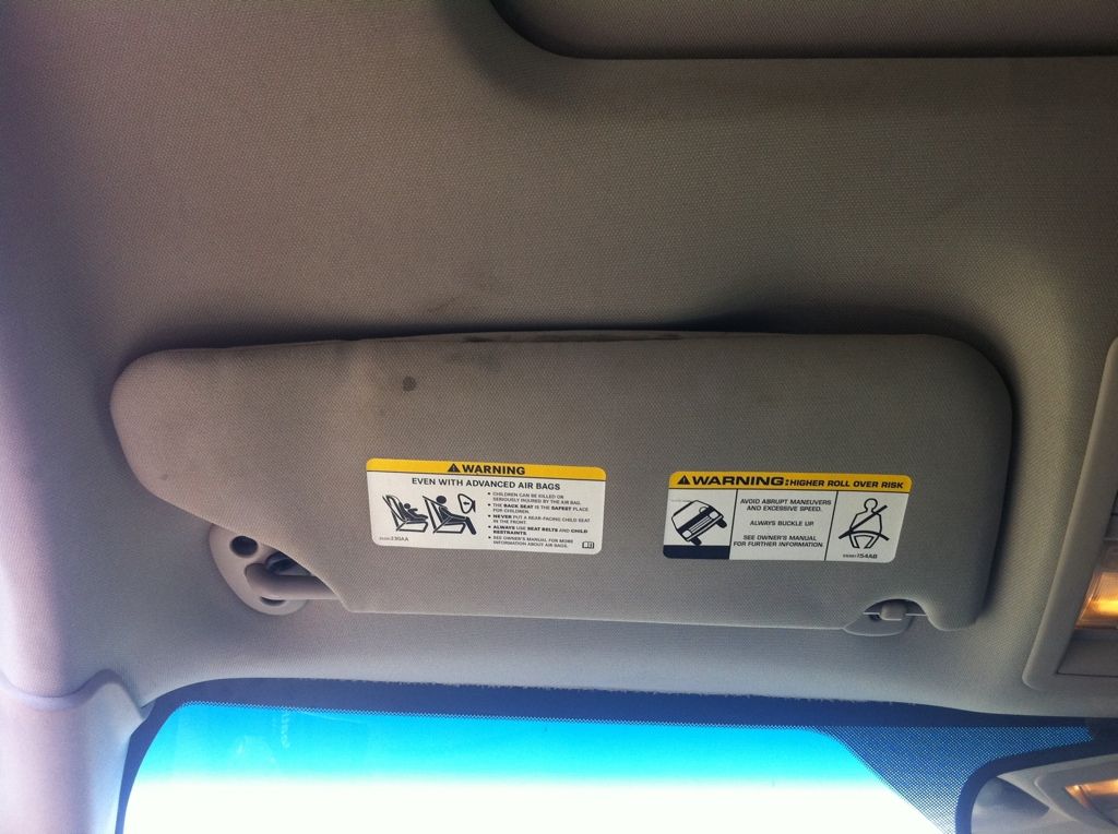

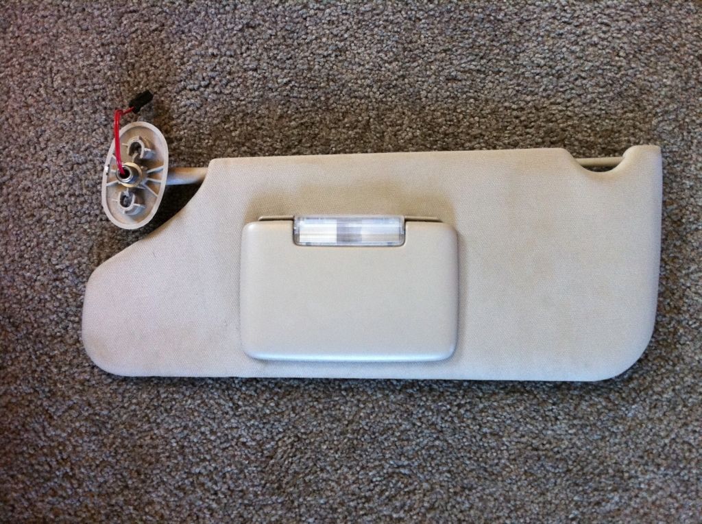

Now the easiest solution for a screen would have been to use my NAV. Unfortunately I have the original 05 unit that doesn't have a video input let alone two of them. I thought about upgrading to a new aftermarket one, but didn't feel like dropping a grand on what I wanted at this time. So what I decided to do was demolish the factory visor (I did buy a second one off eBay for $20 just in case I got carried away)

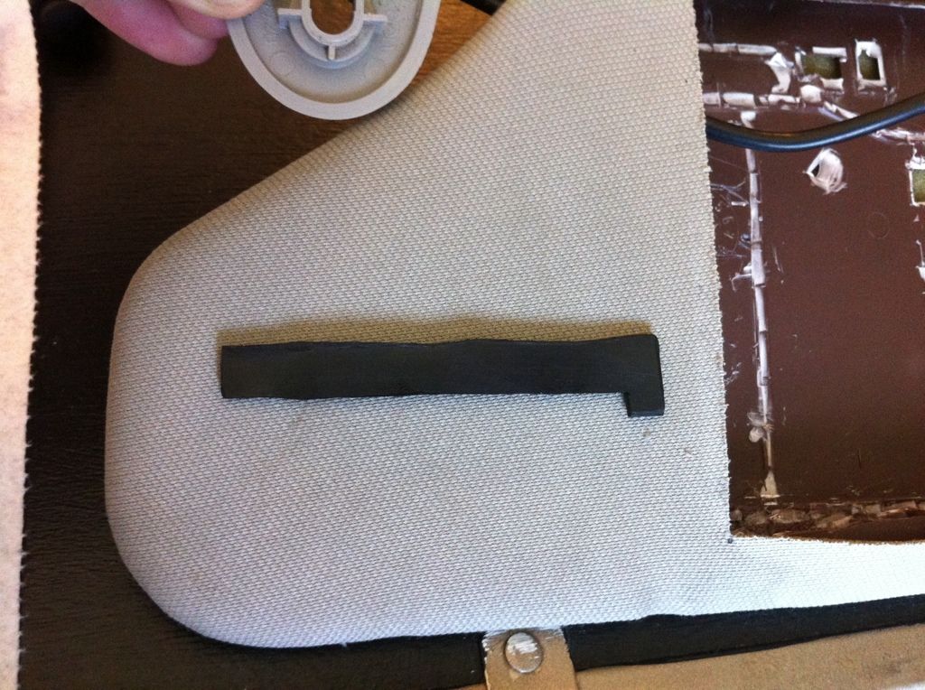

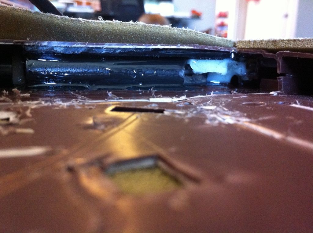

I popped the mirror off.
Used the bezel surrounding the display as a stencil and jut the fabric away.

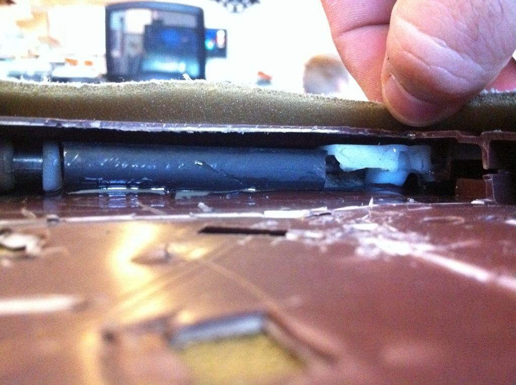

Then after a lot of work with a knife I got the thing hollowed out. There is actually quite a bit of frame work in there. I had to mod the pivot mechanism too. But I finally cleared out enough room for the display to rest.
Because of the room I needed to clear, the pivot mechanism had to be hacked along with a lot of the support structure holding it in place. So it would still function properly I used epoxy to secure it down.
There was still a small void over the mechanism where it could still flex, so I cut a piece off the shroud that I wasn't going to use and epoxied it in place.
Because the back of the display isn't smooth and instead contoured to the back of the shroud, I cut it off and secured it in place with. . . you guessed it! Epoxy
With the display ready to go in I ran the wire harness out the side, gave it a good coat of epoxy, and wedged it into the visor for good. Then I cut the frame off of the shroud and secured it around the display for a finished look.
Omelet is offline

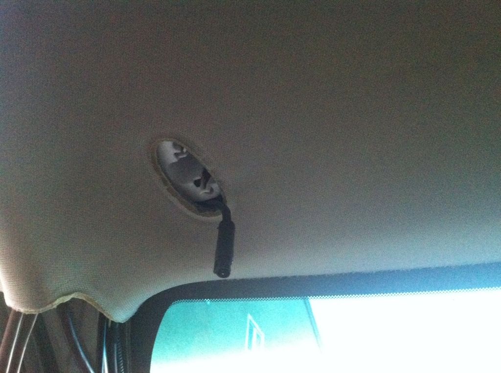

From there I ran the other half of the wire harness up the pillar and through the hole in the ceiling.
Connected the wire and there you have it!!!

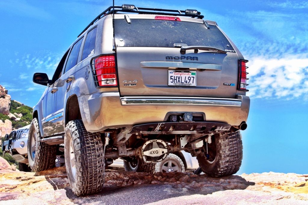

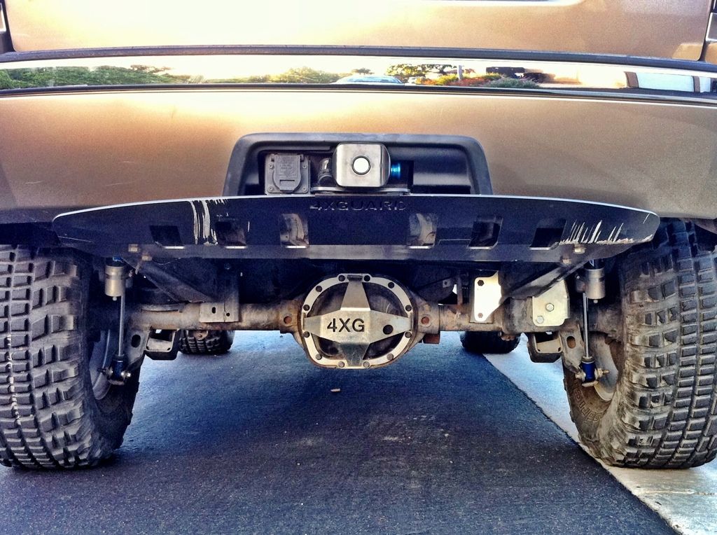

Next I installed the rear camera and secured it with the hitch lock.
After running all the wires in a tidy fashion it was alive!!! (note the Jeep is on unlevel ground)
I haven't finished the front just yet, but will get to it soon. I need to run out and get a night shot too

lmao Nathan that's awesome, I turn my rear camera view on while wheeling sometimes just for fun and thought how useful a front cam could be too. Can't wait to see how that turns out for ya!

Dude! Very cool! I did not even think of getting another monitor like that. I have wanted to get my Double Din radio in the dash to use as a monitor for a back up cam. Too bad that Kenwood Radio is to the tune of around $1,500. I like this idea too, I feel like I keep copying your ideas! I did the LED Rock lights and did the Trunk LED lights already!.

Thanks bud! I wanted to have it all finished for tomorrows outing, but didn't quite get there. Once it is finished I am thinking of getting some type of digital recorder for it so I can use the cameras to record trail runs
Dude copy away! Any good idea is one worth sharing so others can improve their rides

Yeah - the forward visibilty around our big nosed WKs is where spotters come in handy for me - even on descents sometimes. With your camera addition you'll be able to spot yourself while you drive!
I dn't know how you come up with this stuff but it's awesome

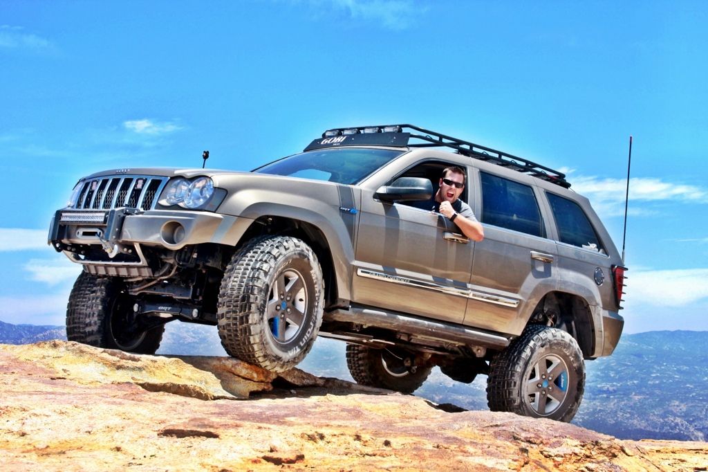

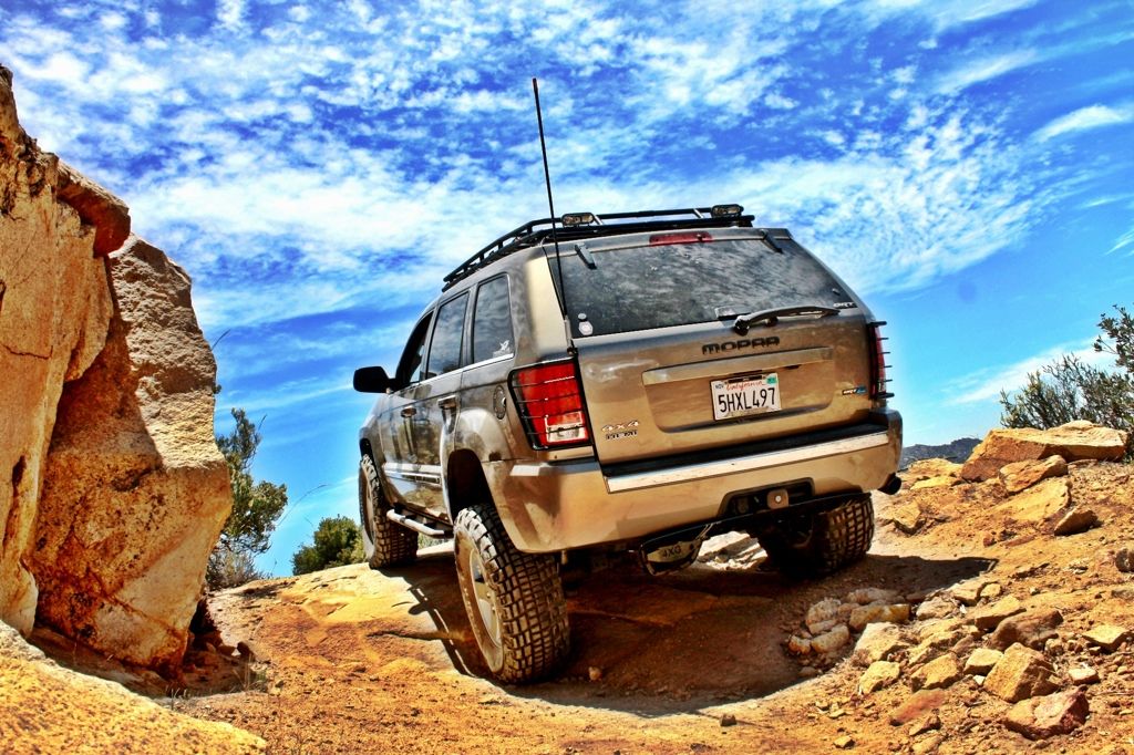

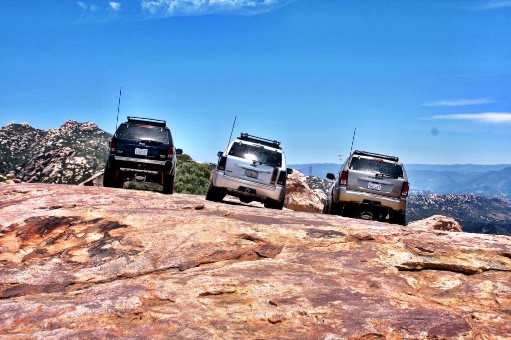

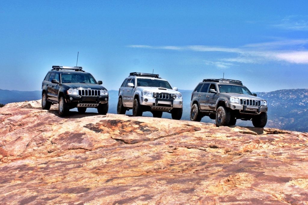

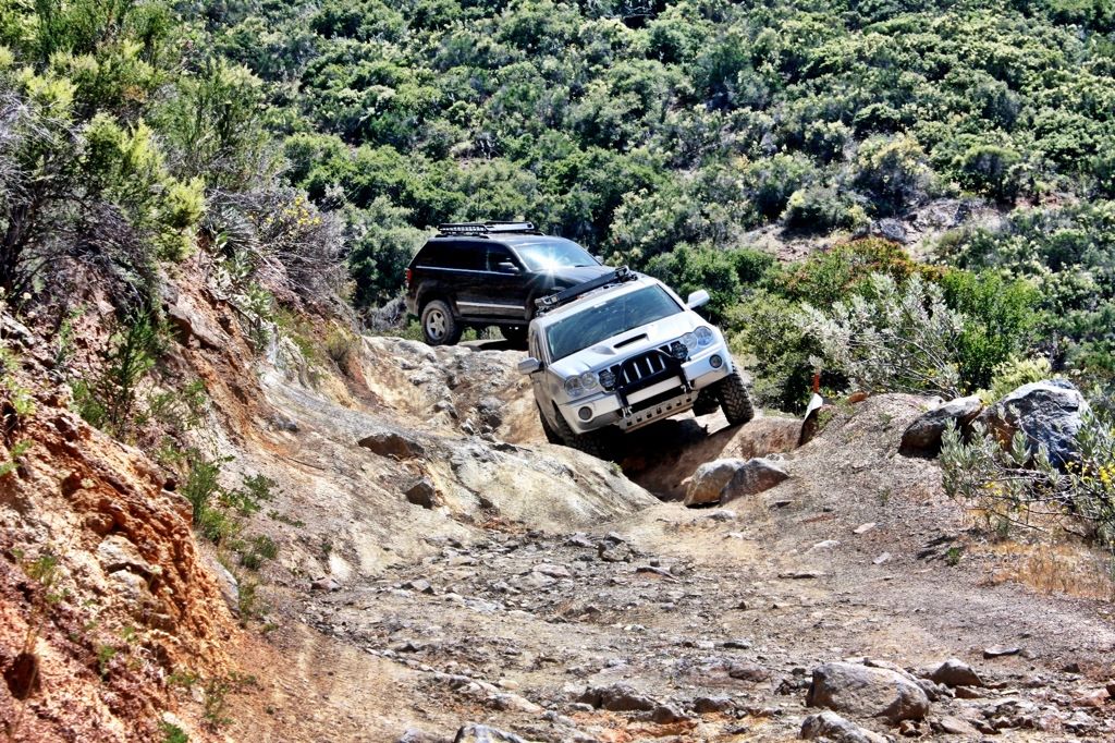

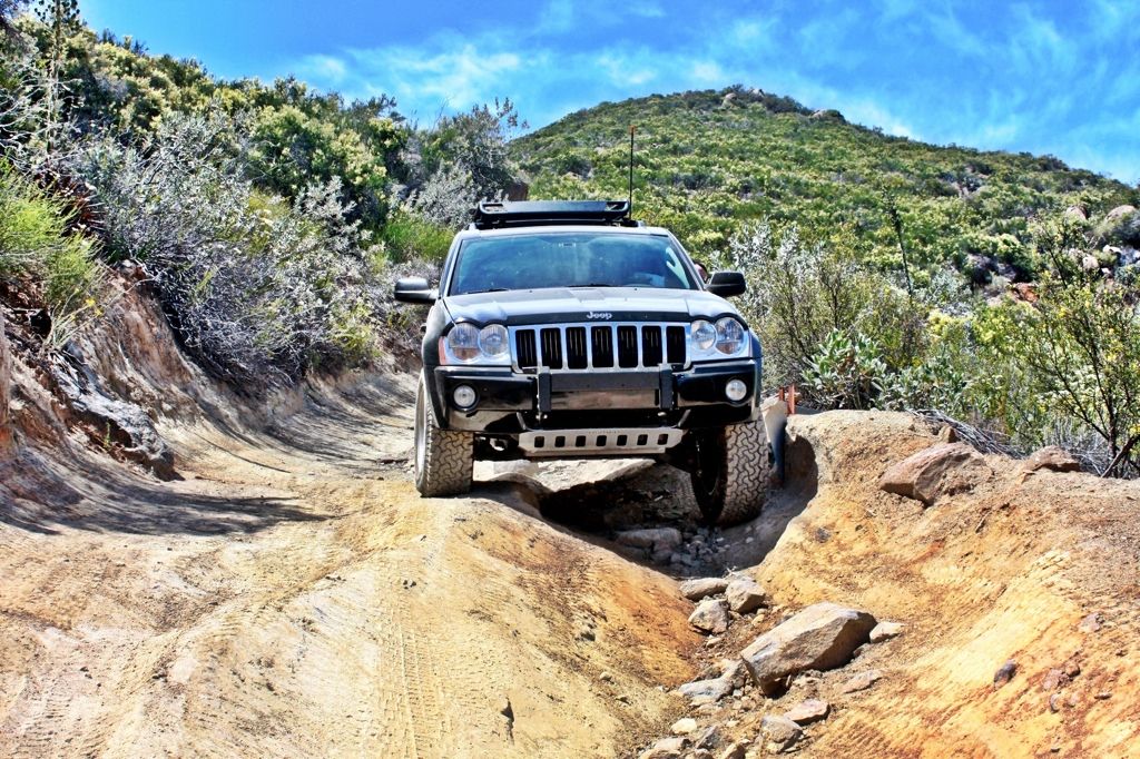

Ok here are some pics! I didn't take as many action shots as I normally do since Greg was using his GoPro, but here we go...
Once we got to the top we goofed around a bit

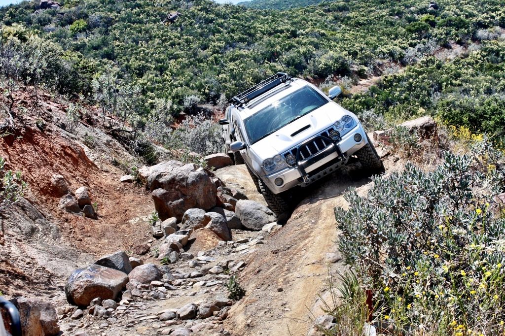

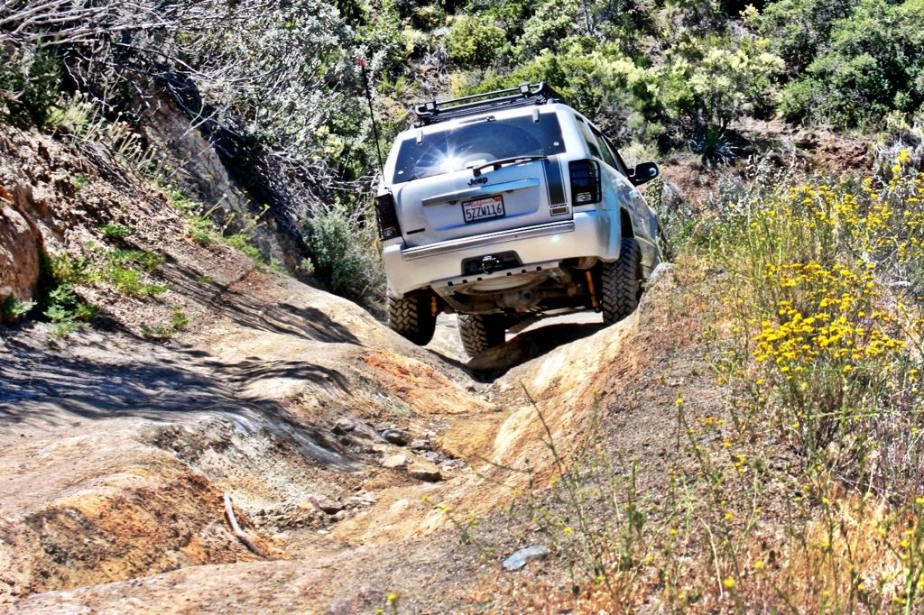

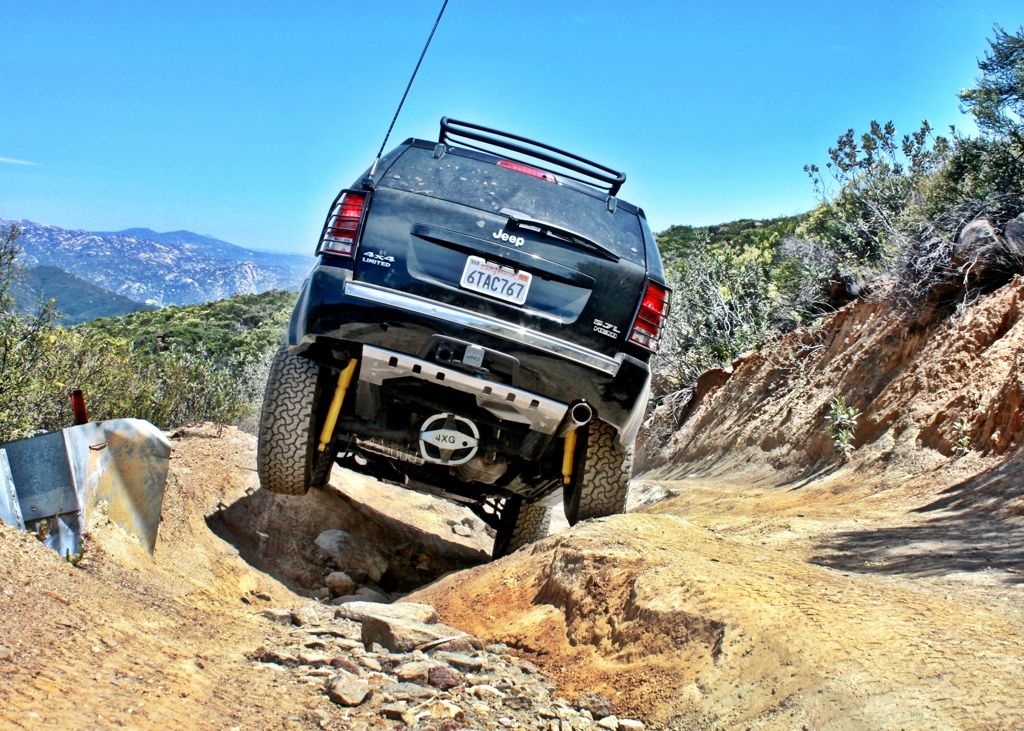

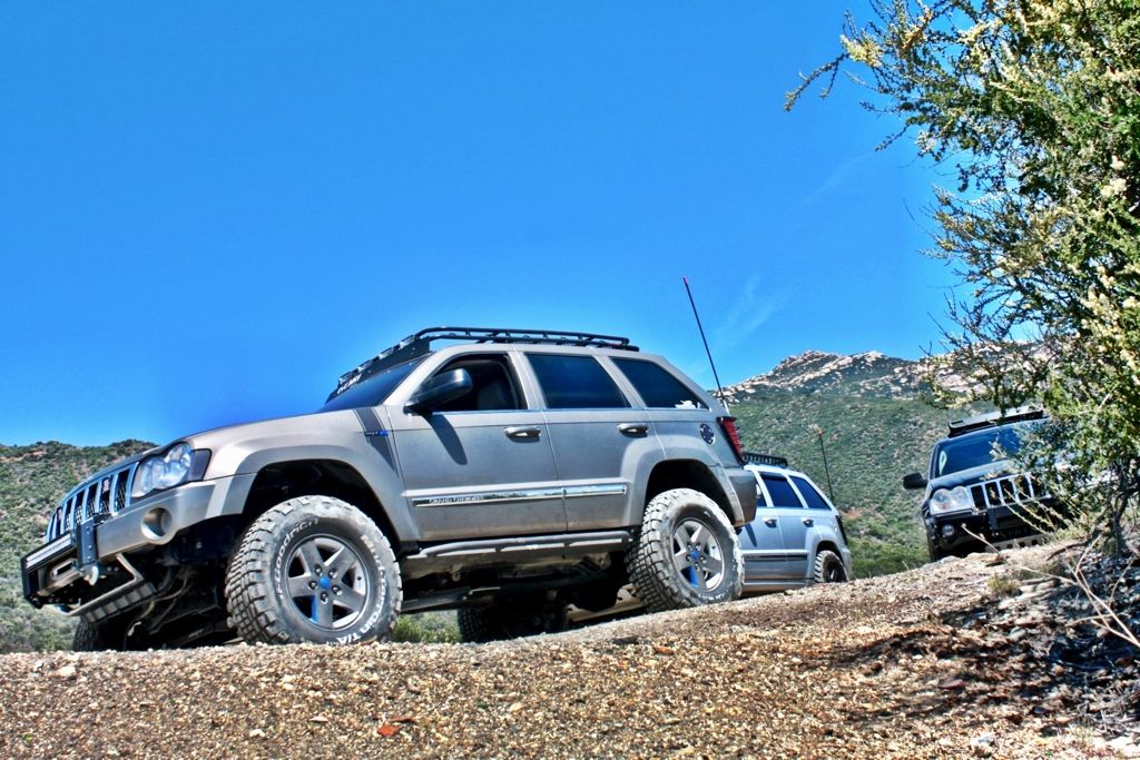

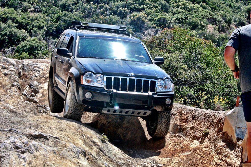

We decided to save some of the trail for next time, so instead of heading down the back side to the rock garden we just went back down to the beginning. That way we have a little hidden treasure for our next gathering (aka something to entice them to come back down for )
Omelet is offline

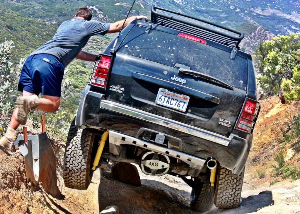

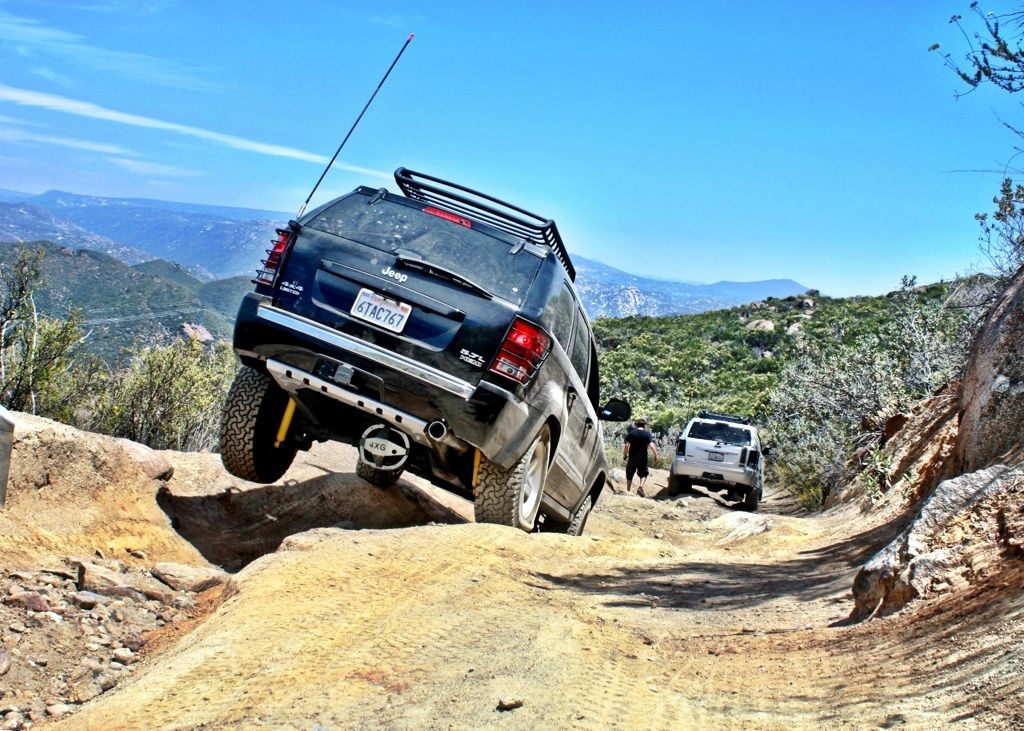

A couple parts got a little tipsy on the way down!

In the end no one encured any damage, just some good use of skids plate! A couple of us cough... GREG ...cough left their mark on the trail lol!!! Can't wait until the next time
Omelet is offline
post #1095 of 2493 Old 06-03-2012, 07:41 PM
sixfoot9psu
2005 WK
Location: York
Posts: 502
no front damage from this? that had to be close coming down
