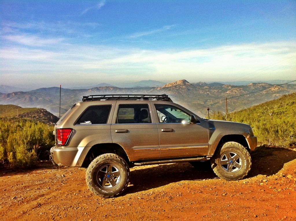

oh my goodness. awesome comparison shots.

Its funny it took so long to find one to do side by sides. WK's are literally a dime a dozen around here. Must make yours stand out even more!

I wanted to but I had to start off slow. The didn't want another beastly Jeep to drive around everyday. And now even though they look similar height, the WK is easier to get in and out. The XJ has a lot more undercarriage clearance and the bottom of the door sill is a couple inches higher compared to the WK. Plus I wont be rolling on the 35s all the time.

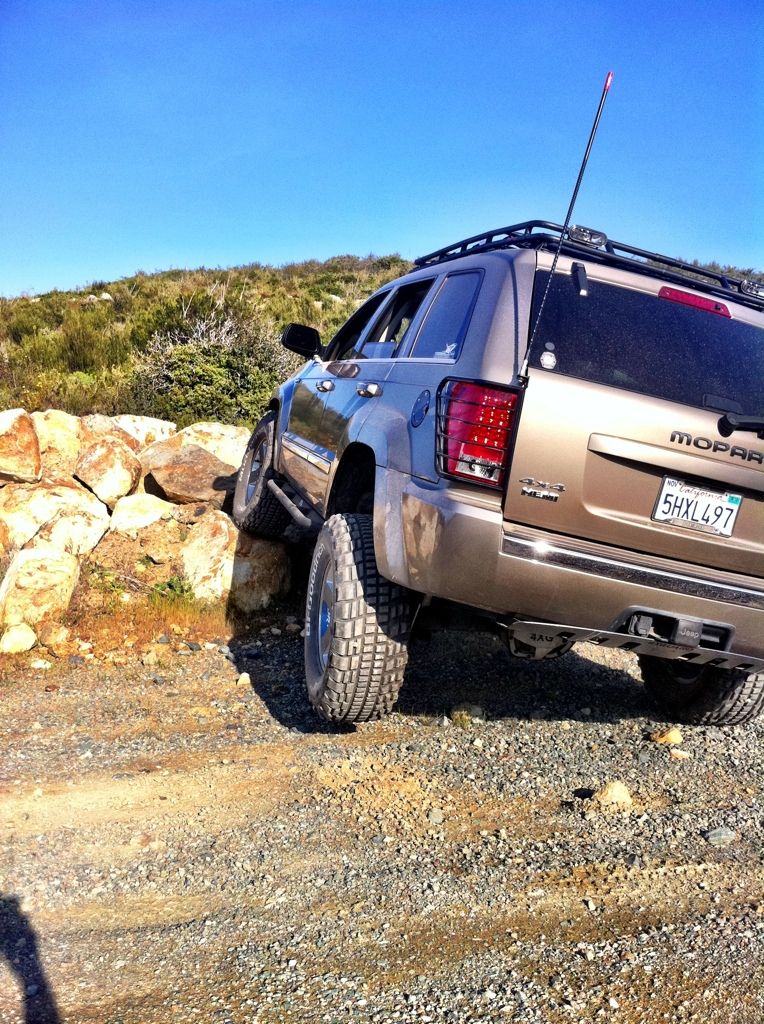

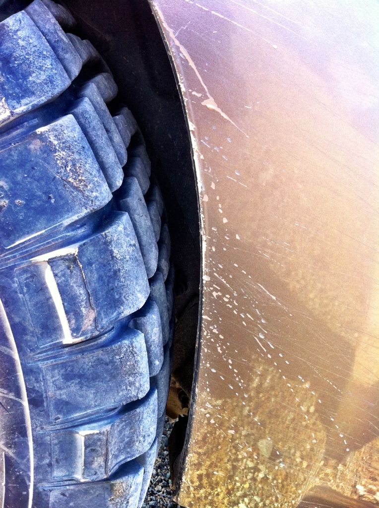

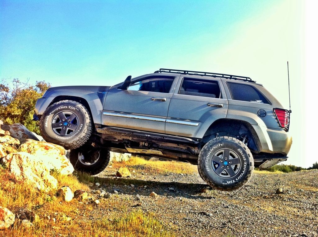

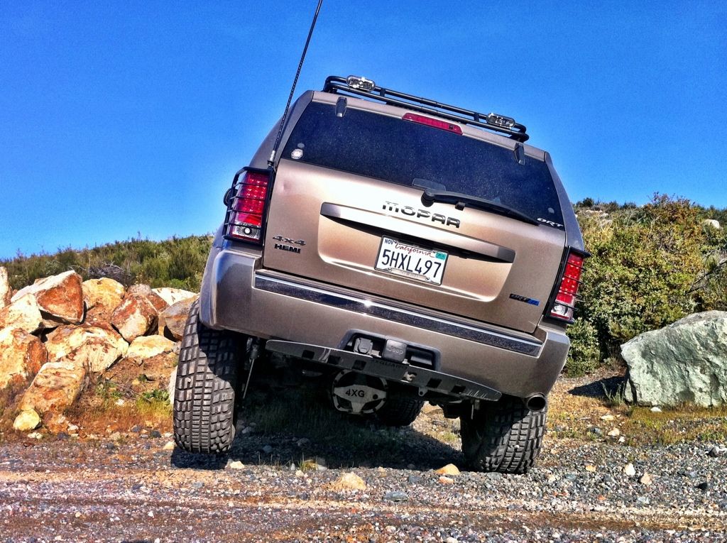

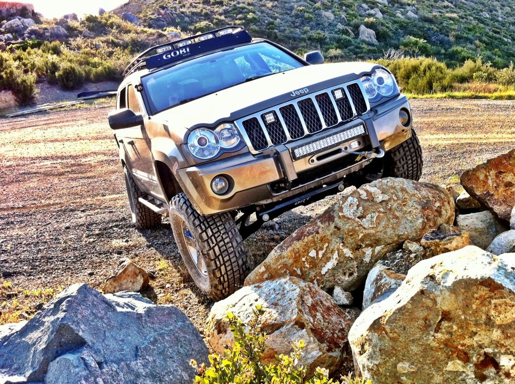

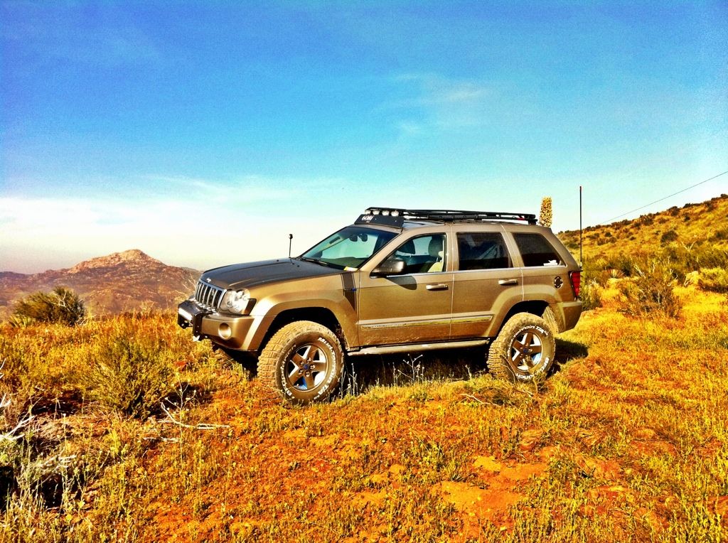

I haven't had a chance to upload these until now. On Thursday after finishing up changing the fluid in the front diff (which is a little more difficult now with the SL crossmember) I took the fam out for a late afternoon ride.
I found a pile of rocks where I was finally able to flex this thing out to the max!
At full stuff in the rear I still have some wiggle room. So as I was hoping I get to chop down these massive 4" bumpstop extensions. I think I will go 1/2" at a time until I can stuff a tire like I used to be able to. What sucks is having to remove the coils to get to the bumpstops. Also once I swap put the 11" rear shocks for a set of 12" I will has more down travel which would have kept the tire on the ground in those shots. I am looking for a good deal now. I found a guy in LA with a brand newish set who wanted $300, bit they were the wrong valving. I really want to find a set with blue parts like I have now, but that might be hard since all the ones they have made for the past year or more have been black. So let me know if anyone finds some please!!!

Nice flex Nate! Was that with both sways connected? The front diff should be easier now with the SL drop. If you look right above the crossmember you'll see the fill plug. I use a spout with a 5/8" plastic tube and squirt it home.

The rear was connected but I am not running the sway bar up front. It seems to be a very nice combo. I still want to get my JKS quicker disconnects back into the rear.
