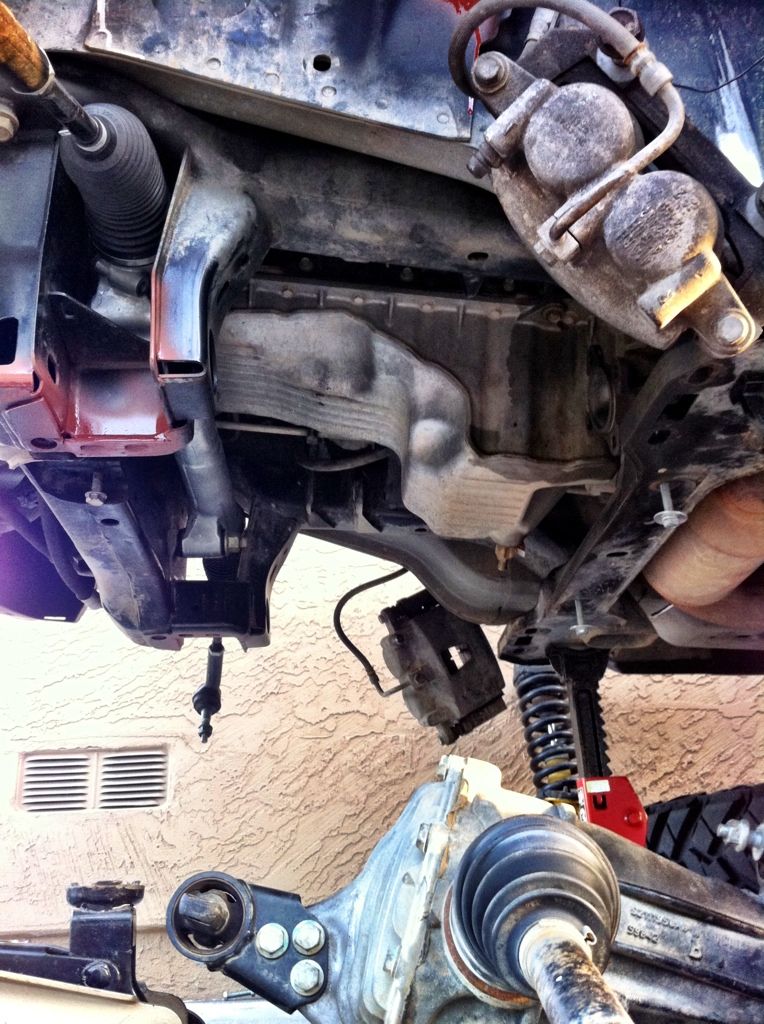

post #733 of 2521 Old 04-01-2012, 11:59 AM Thread Starter
Omelet
Evil Overlord!
Omelet's Avatar
2005 WK
Location: San Diego, CA.
Posts: 5,373
Good morning beautiful!!!
Omelet is offline

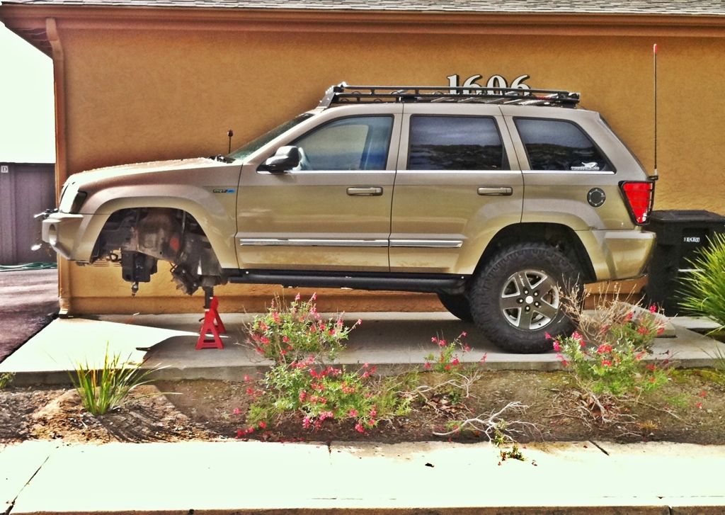

Haha! Only if I found it like that. Since I did it myself it's fine.

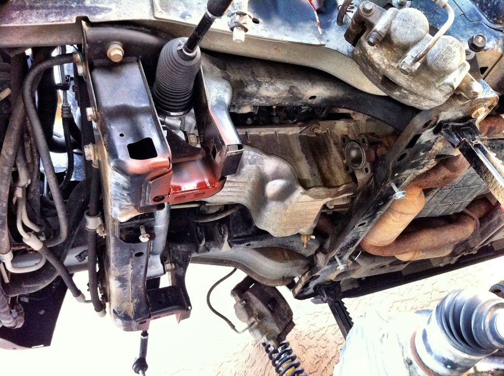

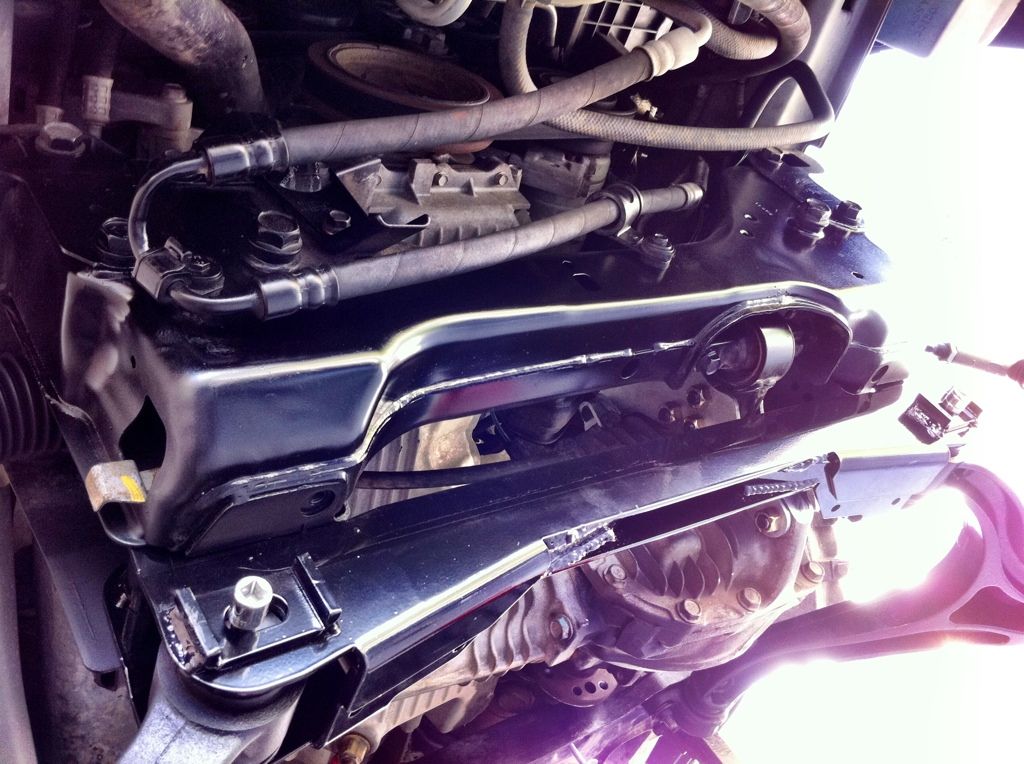

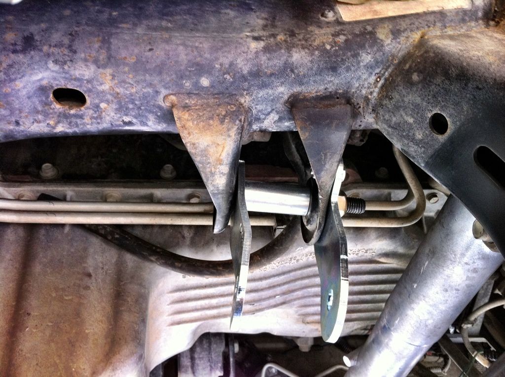

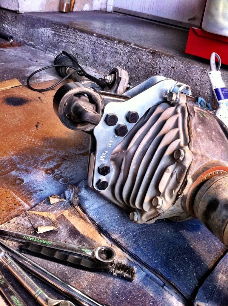

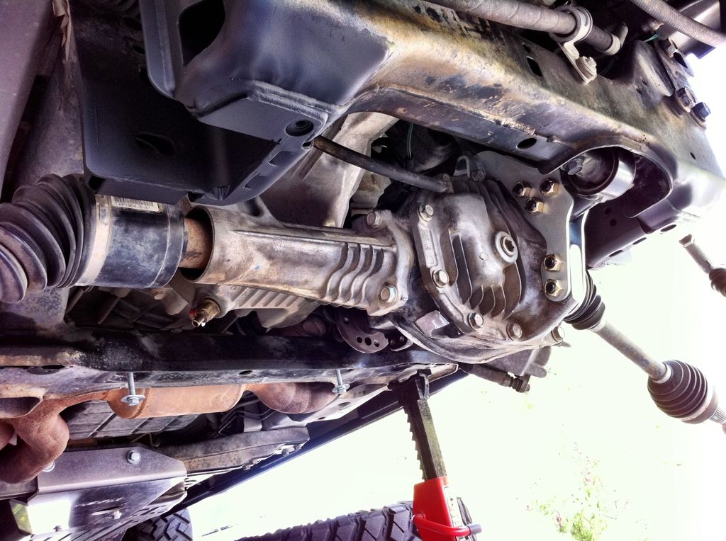

It is time for a Mountain Dew break! So here are some progress pics
New bracket with mod to the front isolator bushing.
Bracket for the diver side or pinion isolator bushing.
Bracket for the passenger side isolator bushing.
Once installed!
After the LCAs and brackets were is.
That is it for now. I have to keep going so I can finish the front before dark.
