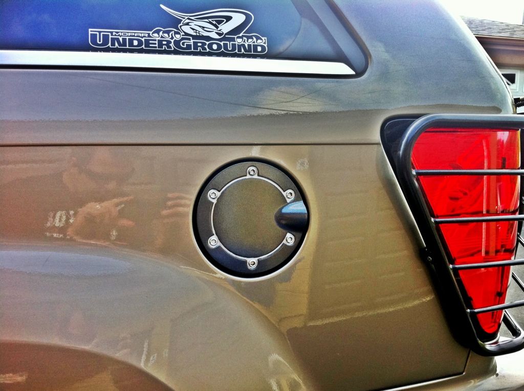

Ya it is a cheap mod so just do it AJ! I will have pics of the gas door up later so you can see if that is something you will like too. I love it when khaki guys try things like this because then the other khaki guys can get a real feel for how it would look on theirs.

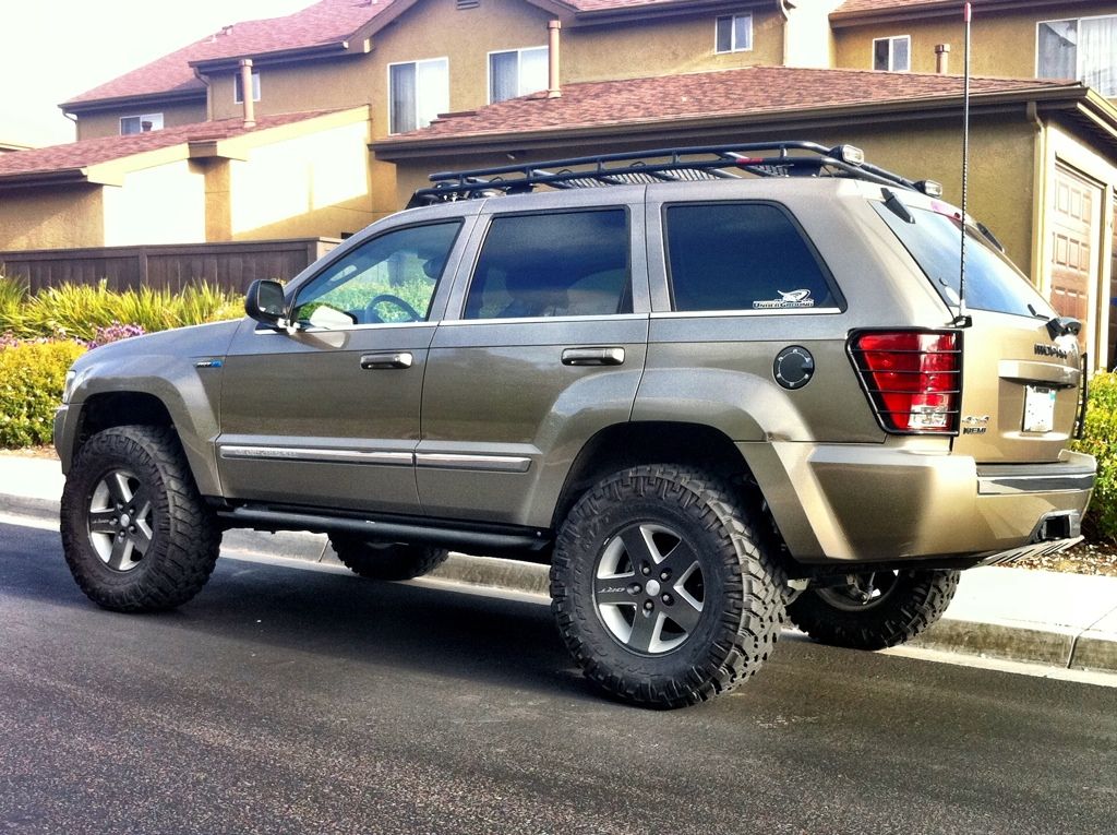

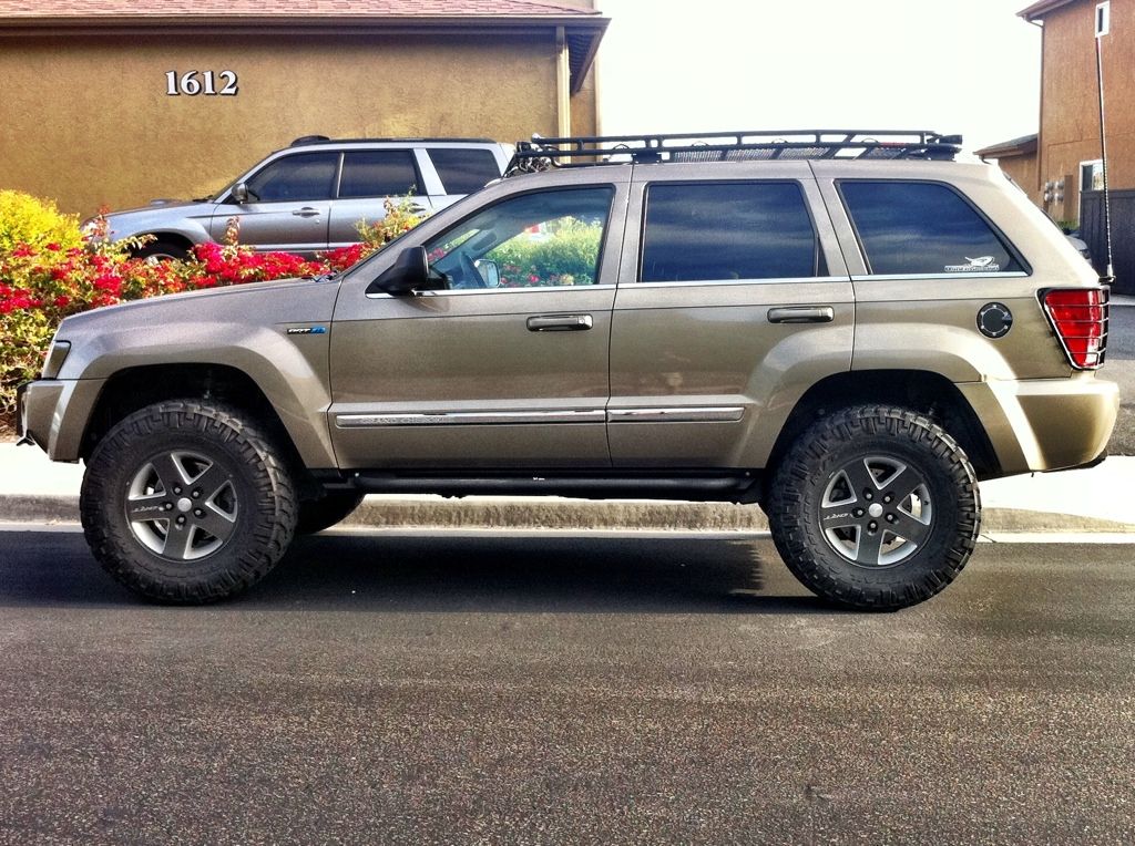

Instal pics as promised!

That's tight! Paint me one!

Real nice. The 2-tone goes great with your wheels.

The gas cap really looks good next to those wheels, well done!

Sometimes those little things go a long way. Looks great!

Thank a lot guys! It was one of those mods I have been wanting to do for a long time but never wanted to pony up the dough for a new door.

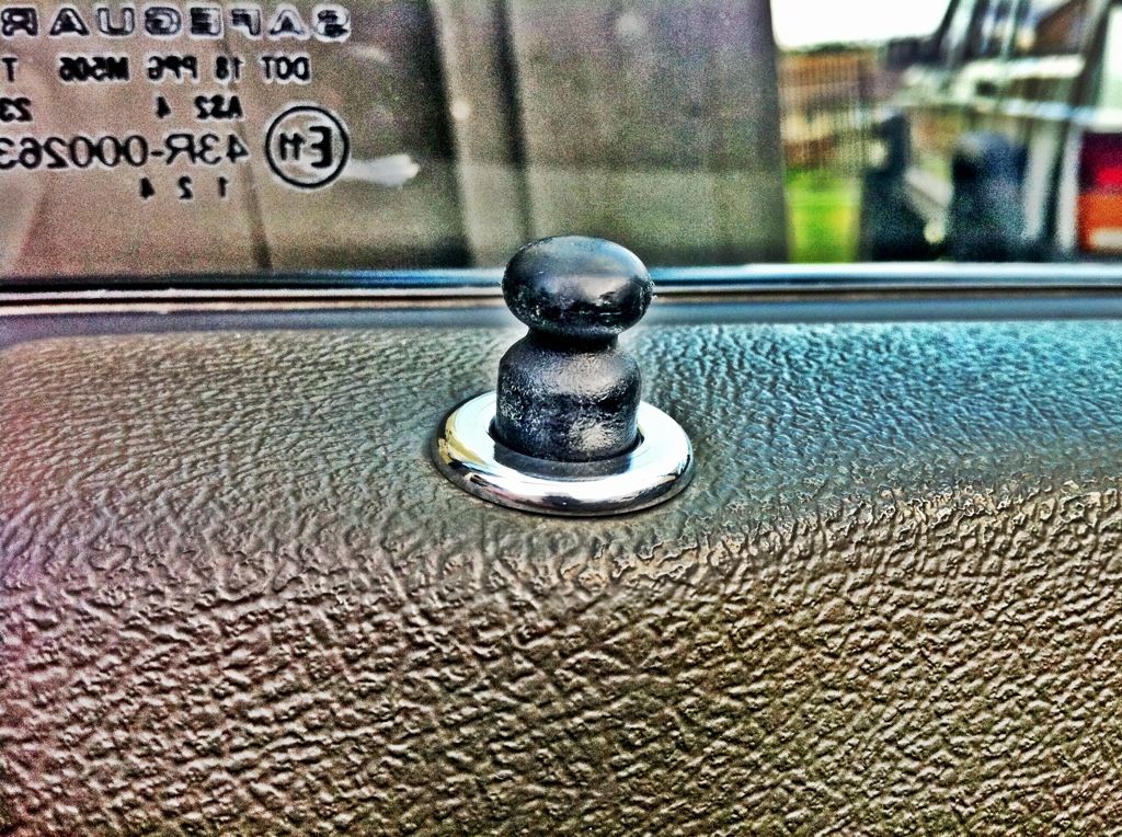

So for the benefit of those who don't want to buy new door locks but still want some low profile ones, here some awesome info for you!
I chopped one down to 1 1/8" the same as the billet ones. Then I used a drill bit and made the hole go all the way to top leaving only about 1/8" from the end. Here's the chopped stock post next to the billet one.
You don't have to chop them for them to sit flush. You can leave them the stock length, but chopping them makes it easier to screw them back on. All you have to do is drill them out farther. Here is how it sits once modified.
And then locked.
So if you like your stock locks and don't want the billet one, then this is a very easy mod to do! Although if you plan to do this you might want to go easy on the soft plastic locks. As you can see I didn't really care about mine and they got chewed up pretty good. I hope this is useful news
Just did this to the driver side only. I've only owned it a week and that lock knob sticking up was really bothering me when I'd have my arm up there. Thanks for the tip.

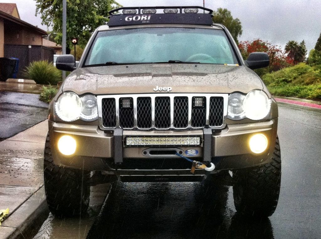

It has been stormy down here the past couple day which is nice, I love having weather! But I am really enjoying the look of the front end with the new grill. Just wanted to share

Yeah, it looks great. I think that's one of the best mods for the time/money involved. $20 and an hour or two and it really has an impact on the appearance of the front end.
