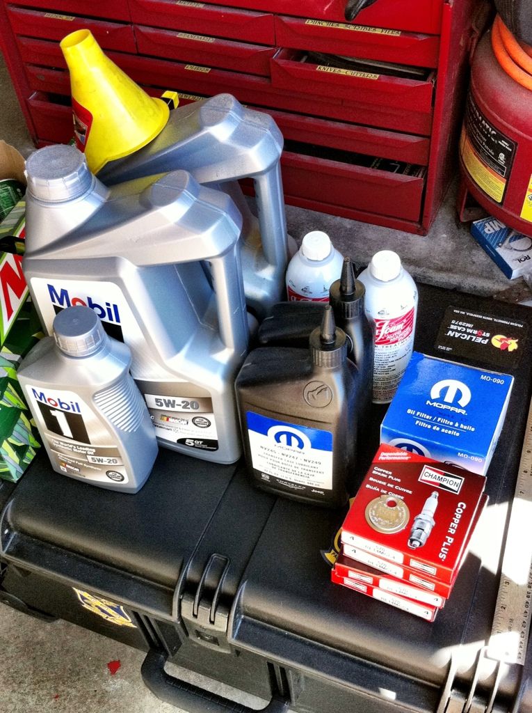

So today I gathered some supplies!
It is tune up time!!! I am doing the engine oil, spark plugs, t-case, diffs (don't have that fluid yet), and some Seafoam treatment. I am currently running with some Seafoam in the crankcase, but I will add some to the fuel after the plugs and oil are changed tomorrow along with the vac line.

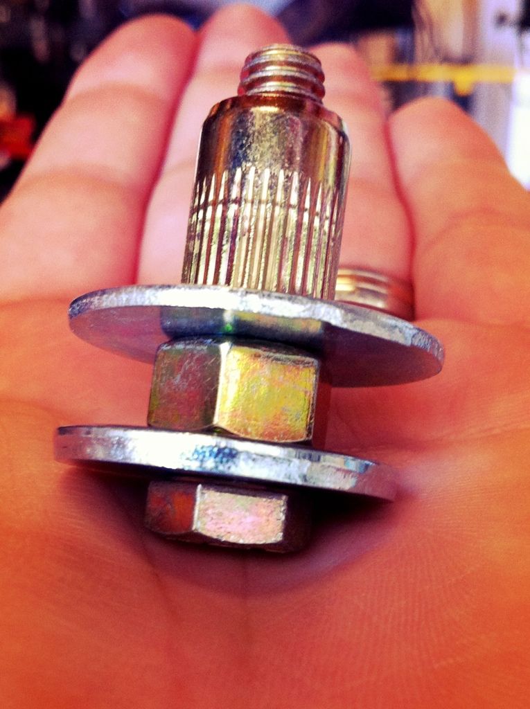

I also put together a nutsert instal tool!

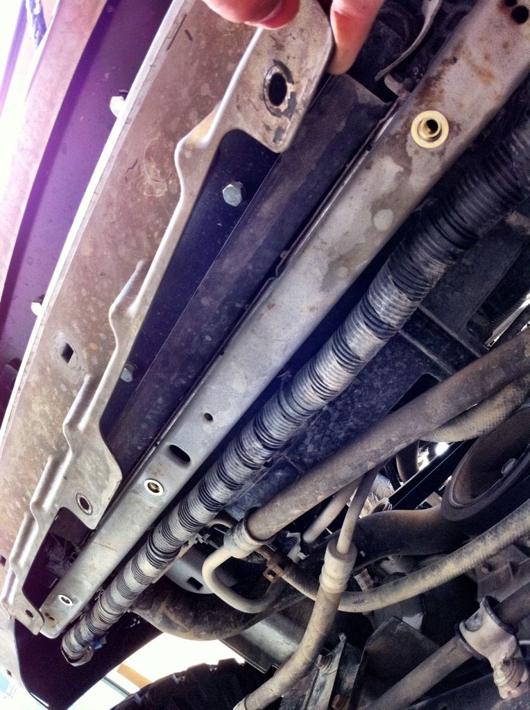

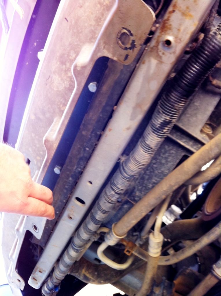

Then I drilled out the three holes under the lower radiator support. They were practically useless from having the 4xG attached to them getting bumped around. The holes had distorted and the bolts were hardly grabbing anything. SO they were drilled out and I installed nutserts in their place. Now I can use 5/16" bolts to secure my skids!
Before:
After:
This will make for a much more secure skid mount!!!

Nate how does the nutsert tool you fashioned work? I've seen some that look like rivet guns but nothing like that. Shnazzy!
Thanks Bud! You put an end wrench on the nut in between the washers (that nut is just floating BTW, not threaded on) and then a ratchet or impact gun on the bolt. Tighten it down and then back the bolt out. And there you have it... a nutcert!!!
Ooh gotcha. So it flares in the hole I'm guessing? Where'd you find that nifty tool?
