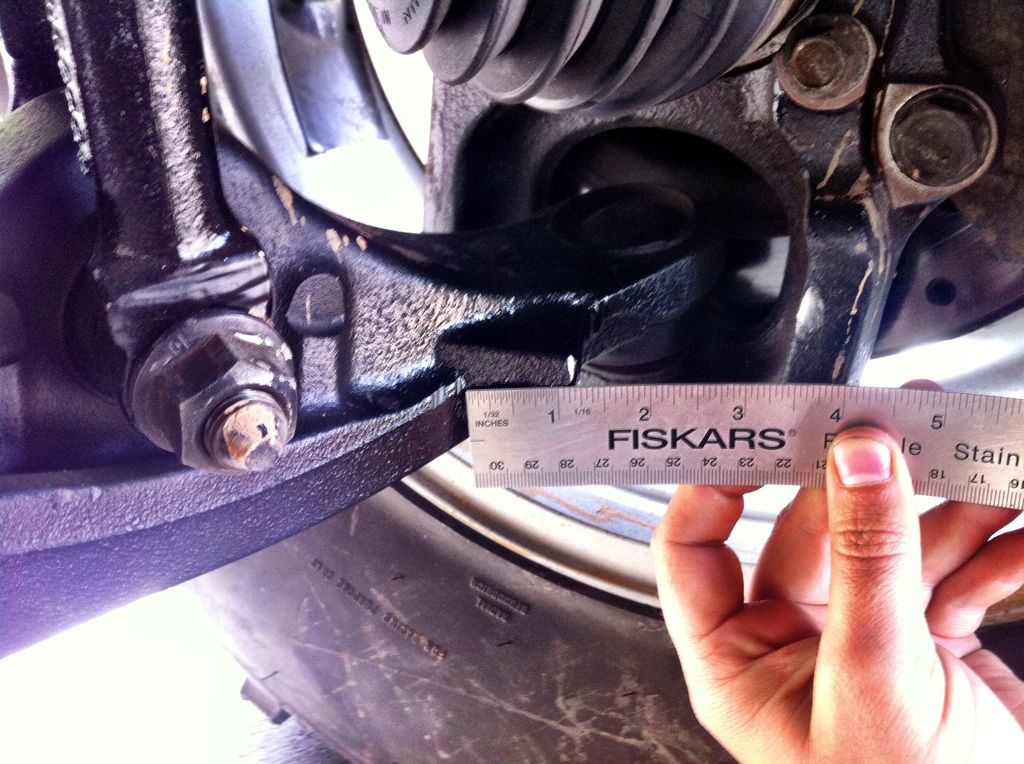

When I installed the SL I realized just how much the turning radius sucked with it. So today I got around to doing something about it. I planned to trim the stops and decided to grind the lower arms since they would be cheaper to replace if need be. Before trimming I only had one complete turn of the steering wheel from center to lock. Now I have just over 1 1/4" turns with out the 35" tires hitting the frame.
Before:
After:
I removed a 1/4" from the stop. I could go a little more, but I want to see how this works for the time being. Even a little bit will help drivability. I don't know how everyone else with the SL has been able to stand it, especially those with smaller tires!

Nope hasn't caused any issues! When I replaced my LCAs I did the same thing again. The turning radius otherwise is just ridiculous! When you trim yours, lift the front end off the ground, then trim a little at a time and turn the wheels to full lock to test, if all is good then keep trimming until you get your desired length.

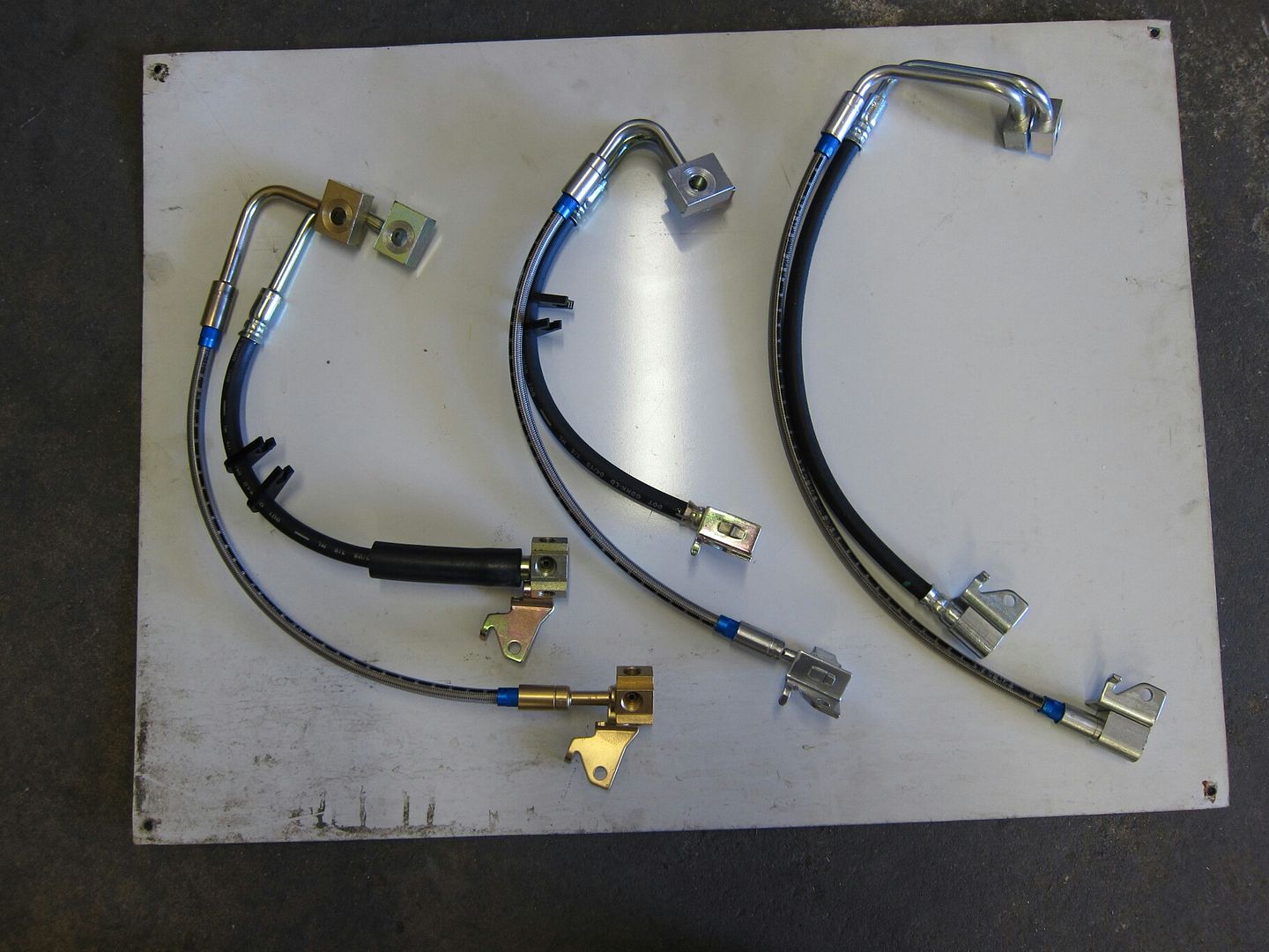

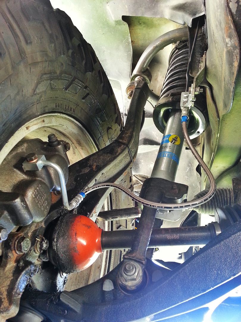

Chris and I had gotten together and tag teamed getting our brake lines upgraded. We installed the the new stainless steel extended lines he's going to be carrying at Crawl Offroad. The 6" ones when on the Bison and the 4" ones when on his. It was a messy upgrade but a much needed one!
You can see the factory lines next to the new ones here.

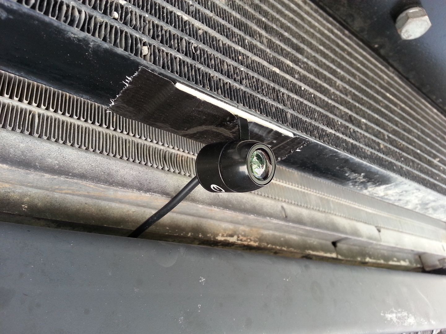

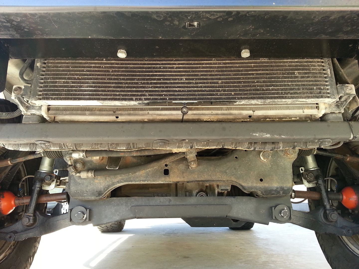

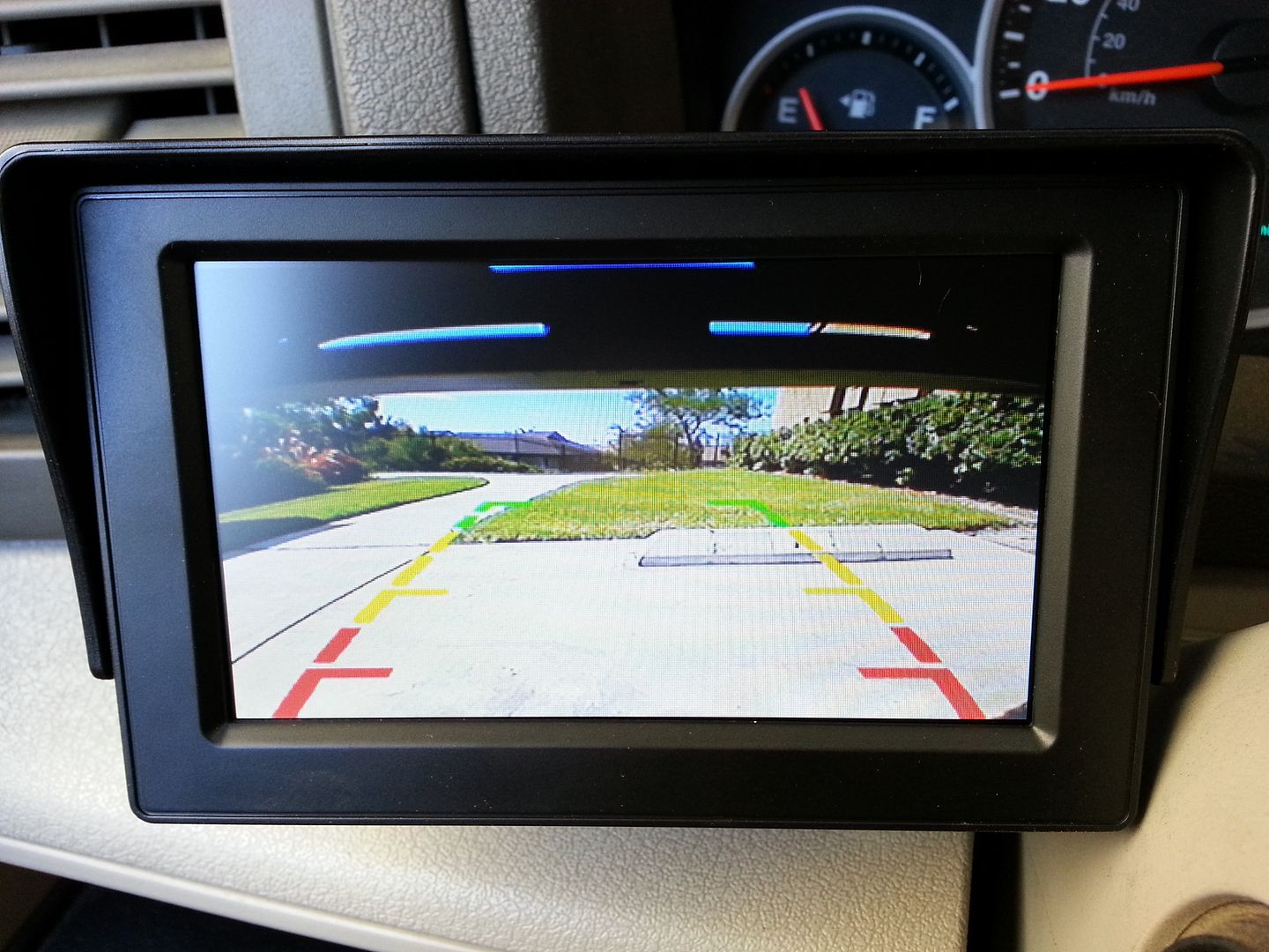

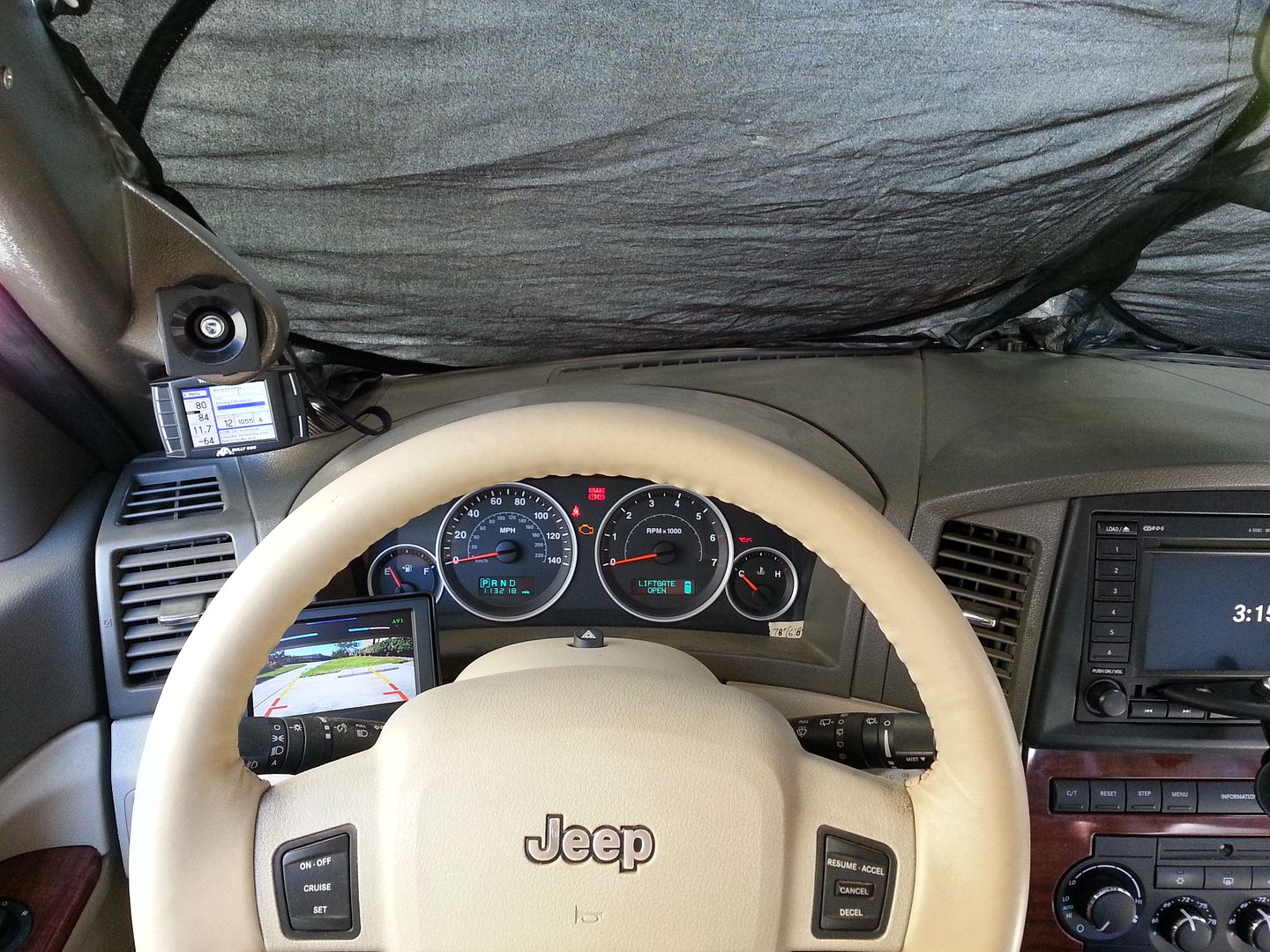

So a little while back my driver side sun visor with 7" monitor broke and would no longer stay up. I pulled it out and put the normal one back in. Then I ordered a smaller 4.3" monitor to use instead: http://www.amazon.com/gp/product/B00...?ie=UTF8&psc=1 Also I had never reinstalled my front camera after the ARB went on. I contemplated a couple different ways of mounting my old camera and just decided to use a new one: http://www.amazon.com/gp/product/B00...?ie=UTF8&psc=1
I mounted the camera to the bottom on the trans cooler. It might not be the permanent position, but it has been working so far.
Then I used some super sticky double sided tape (not the weak crap it came with) to mount the monitor to the left of the steering wheel.
The picture quality of the new front cam is definitely better than the old rear cam, so I might swap the rear one out eventually. This isn't a perfect location, but it works. Once I get a tablet in here I'm hoping to be able to wire the cameras up to it, we will see. The main difference between this monitor and the last is the input wiring. With this one it's default mode is the front cam. I rewired the rear cam so it now takes it's power from the reverse light circuit. That way the monitor will always show the front cam until you put the Jeep into reverse, the the reverse lights come on giving power to the rear cam. As soon as the monitor senses the rear cam is active, it overrides the front cam input and displays the rear cam until you take the Jeep out of reverse. It all works instantaneously and does so quite well!

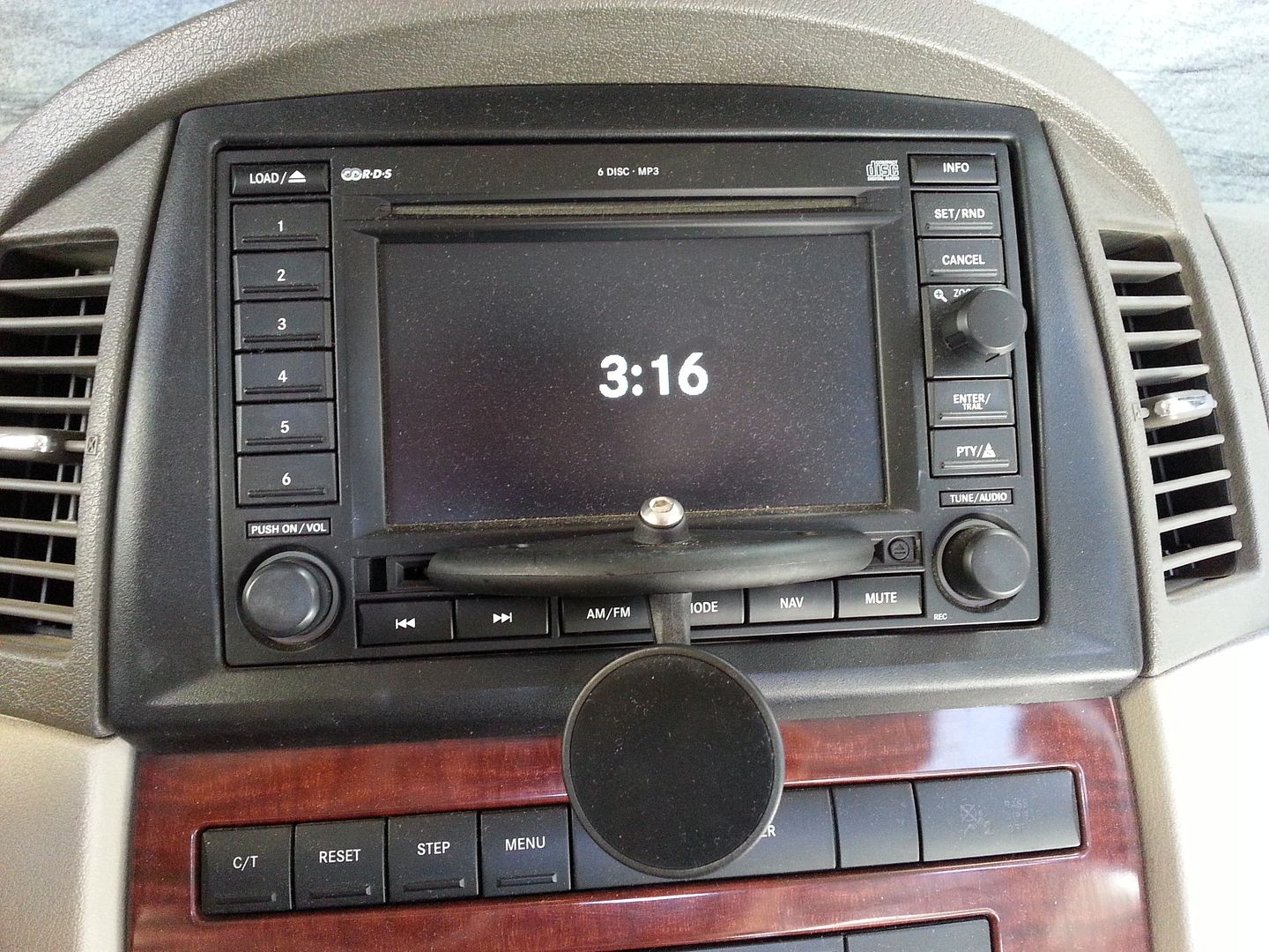

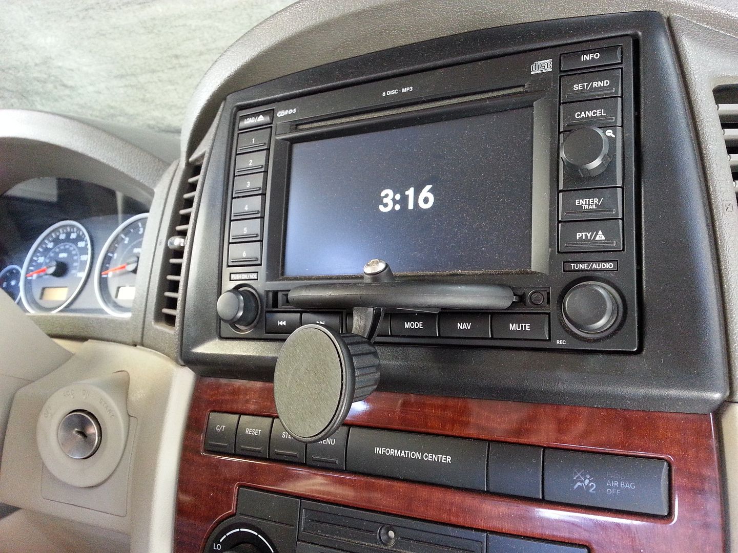

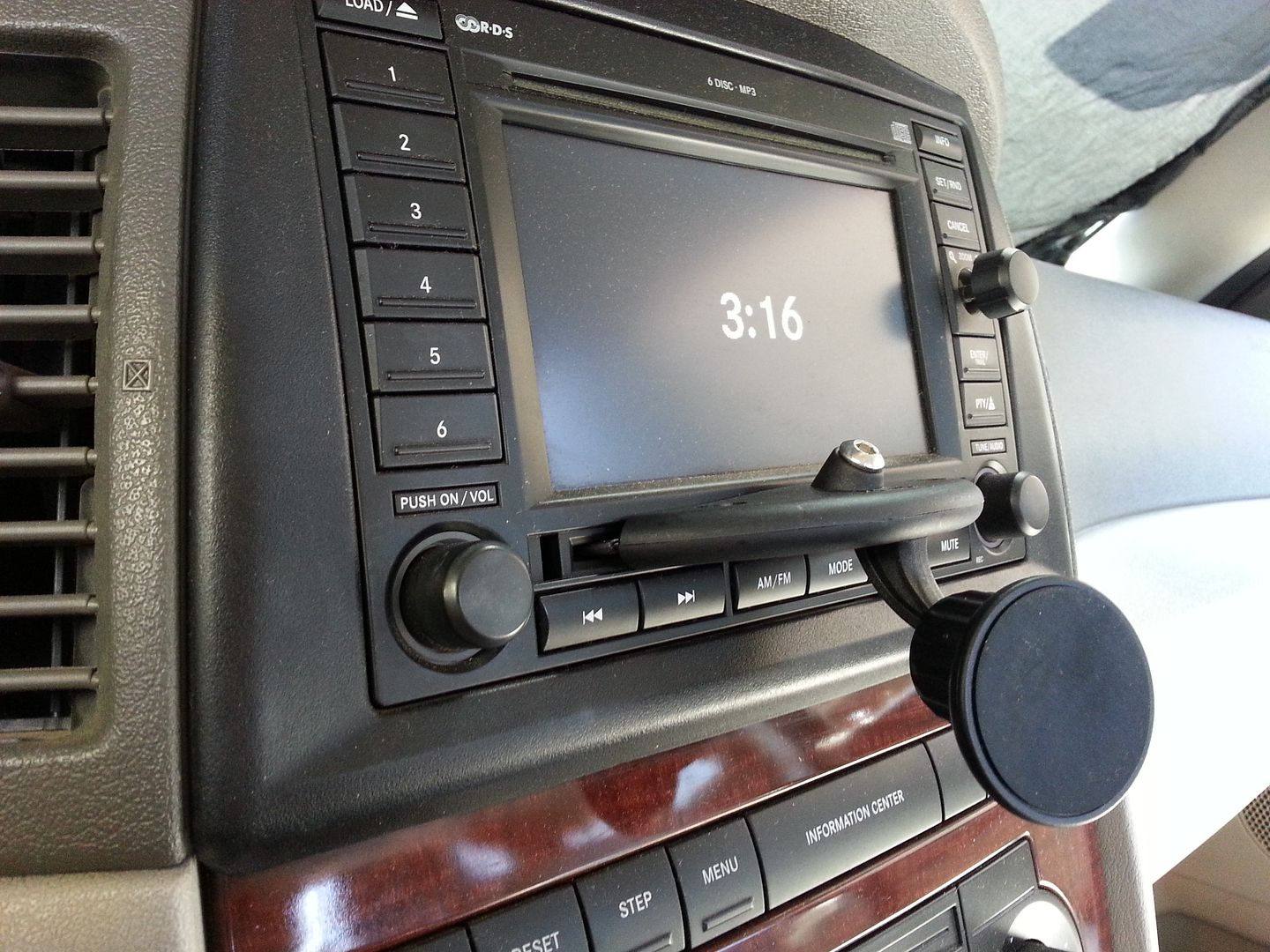

You might have noticed this in the last photos but I have been using a magnetic phone mount for a little while now which attaches to the CD slot or in this case the NAV disc slot. It came with a knob to tighten it into place, but since I mounted it up side down I didn't want to see it. So I bought a stainless allen screw to use instead. It works great and makes it very easy to mount and unmount the phone. Plus as long as you aren't using a case on your phone it holds really strong. If you have a case then depending on the thickness it might not work too well. It comes with thin steel plate to either stick on the back of your phone or slide into the back cover. With both my Note 2 and Note Edge I simply have the plate resting inside the back cover of the phone. With my wife's iPhone I removed the rear cover and the thin plate just fits inside. So on the outside both of our phone look like any other phone of it's model, but they hold firmly to the magnet with easy and without any degrading side affects.
Oh I got them from Amazon for about $15!
