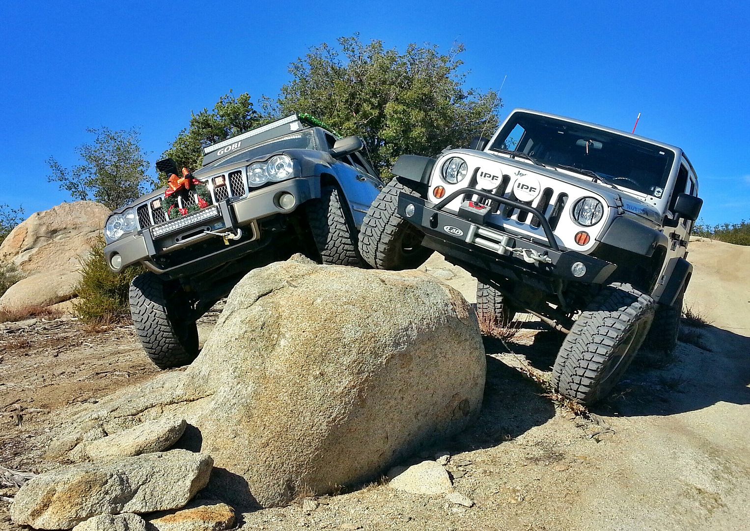

Here are some shots from the past couple month that I never posted.

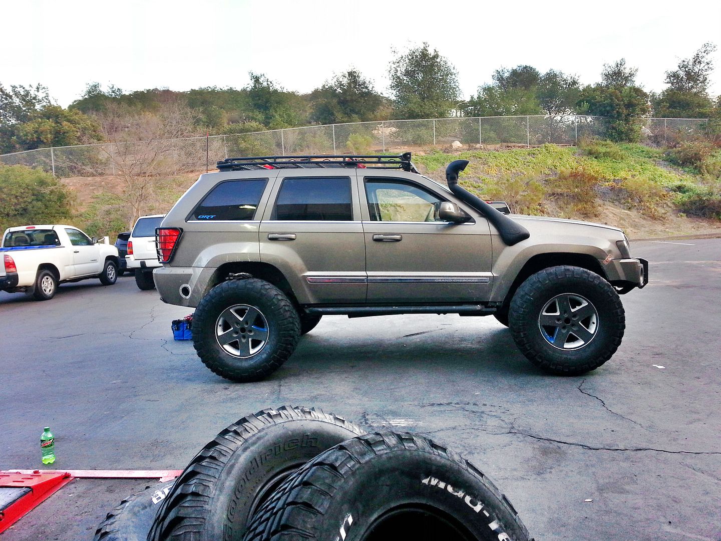

Trying to mount the 37s. The last pic I'm sitting on the 295s with the 37s rolled in front of them.

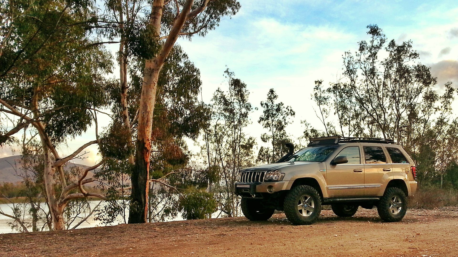

Here's a couple while spending some time out by the lake. I'll tell you what, these SoCal winter are brutal
And a couple beach side shots.

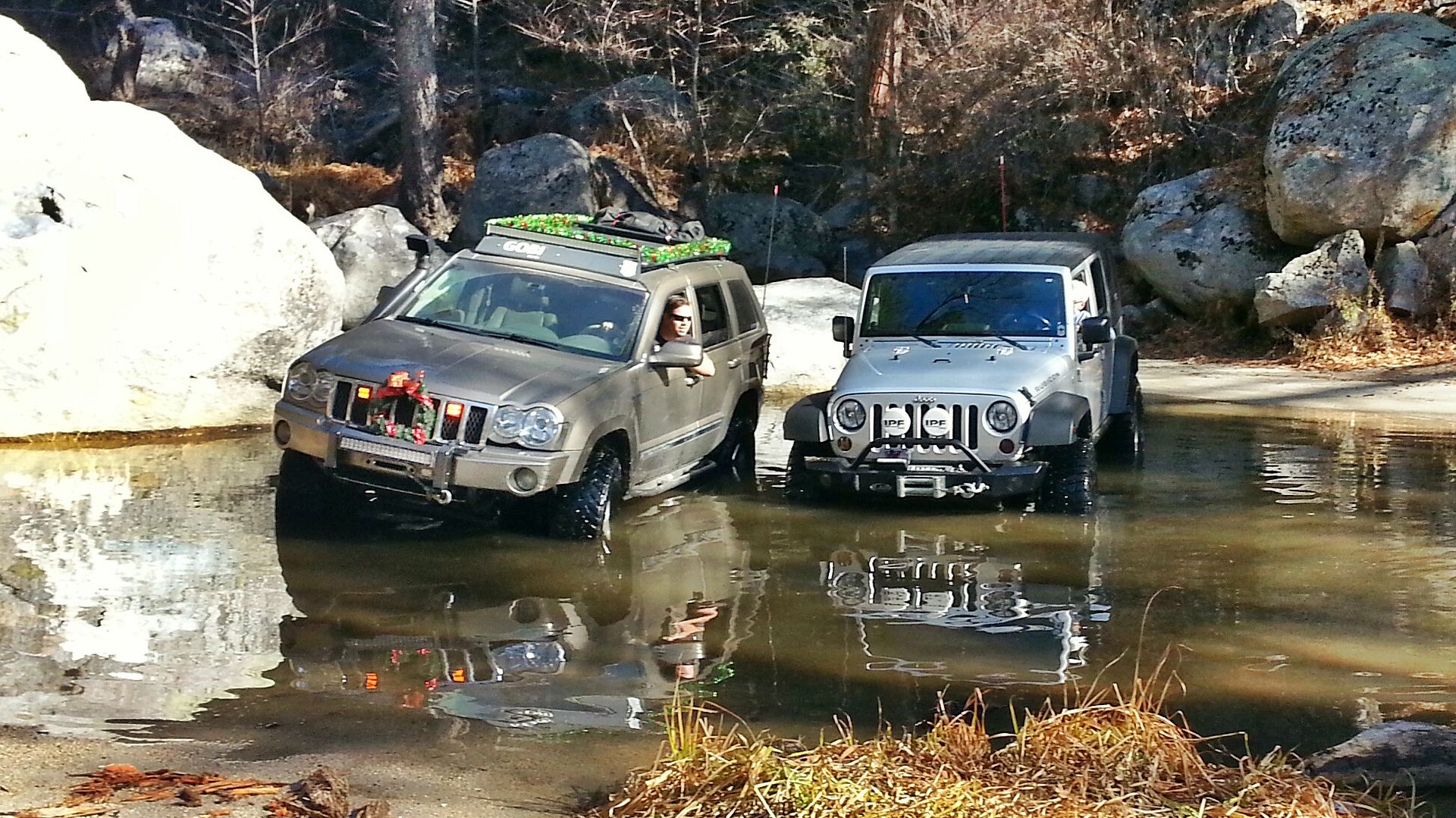

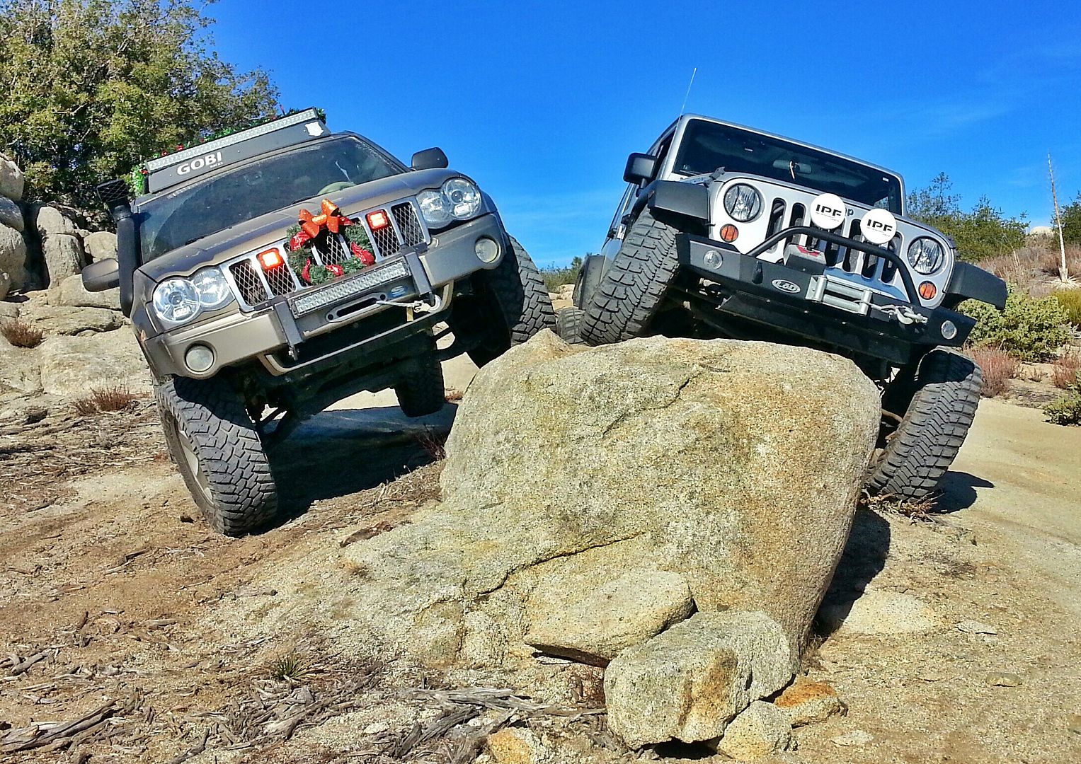

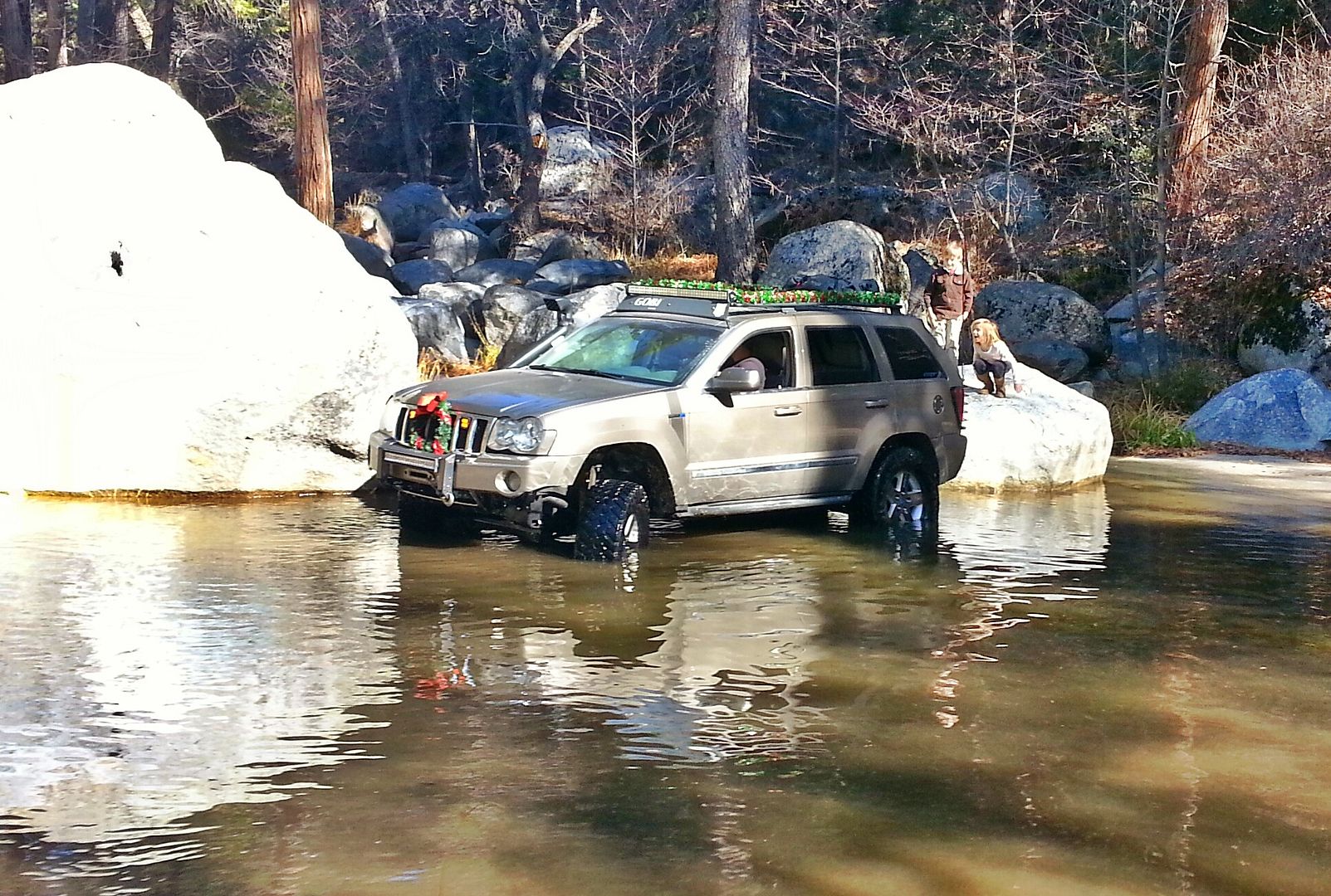

During Christmas My Dad and I got out and did some easy scenic wheeling outside of Idyllwild.
Omelet is offline

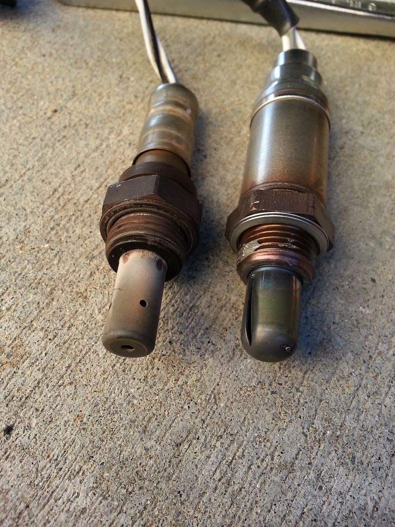

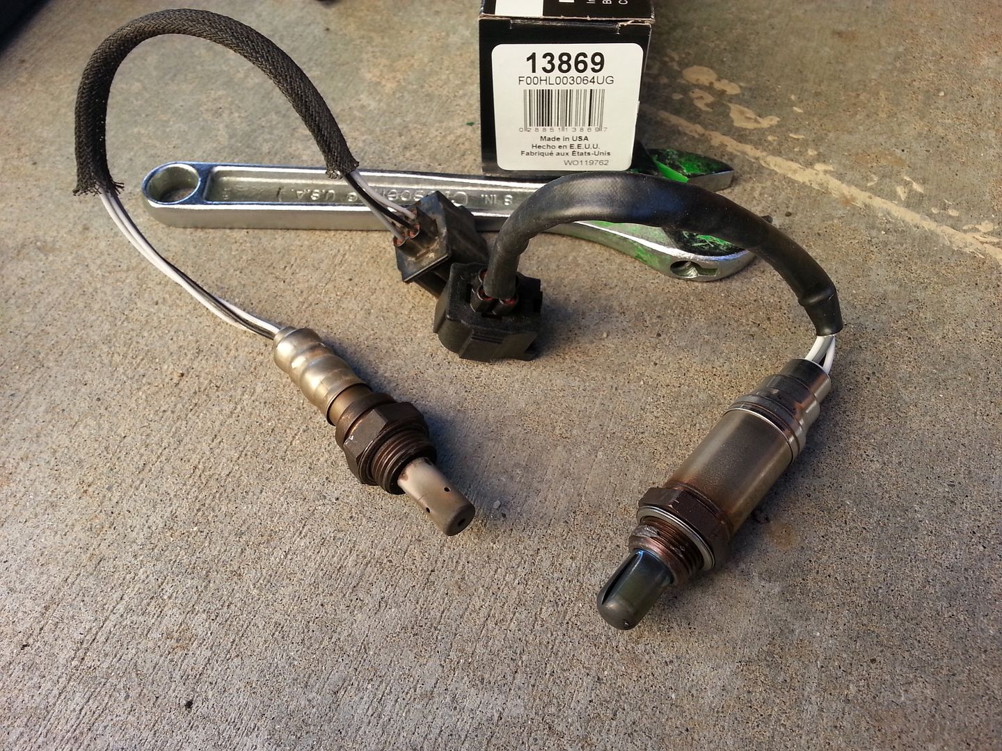

So the other day the engine light came on while we were sitting in the In-N-Out drive through. I got home and pulled the code which was P0032 (O2 Sensor 1/1 Heater Circuit High). I ended up finding a Bosch at Auto Zone for $25 and swapped it in. I'd prefer OEM but this was easier to get and half the price. I might order a Mopar one off Amazon to have on hand for next time. I had to disconnect the battery before it would run properly again, but now we are back in business!
