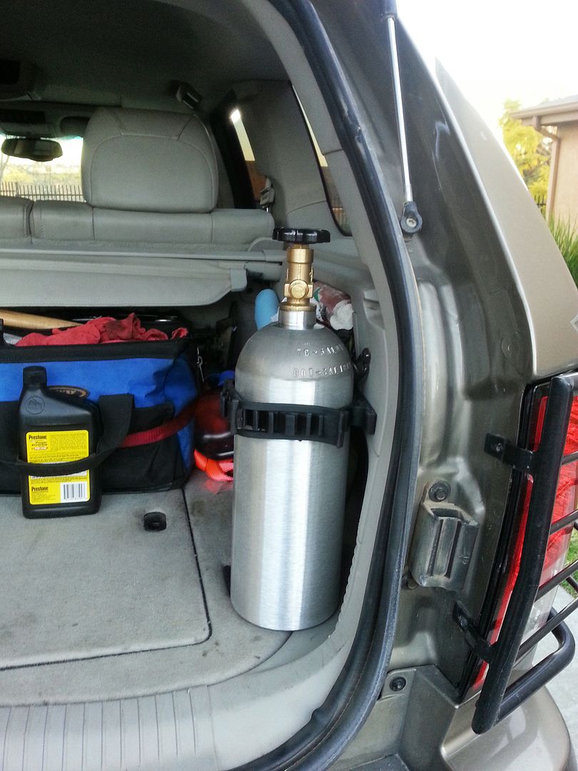

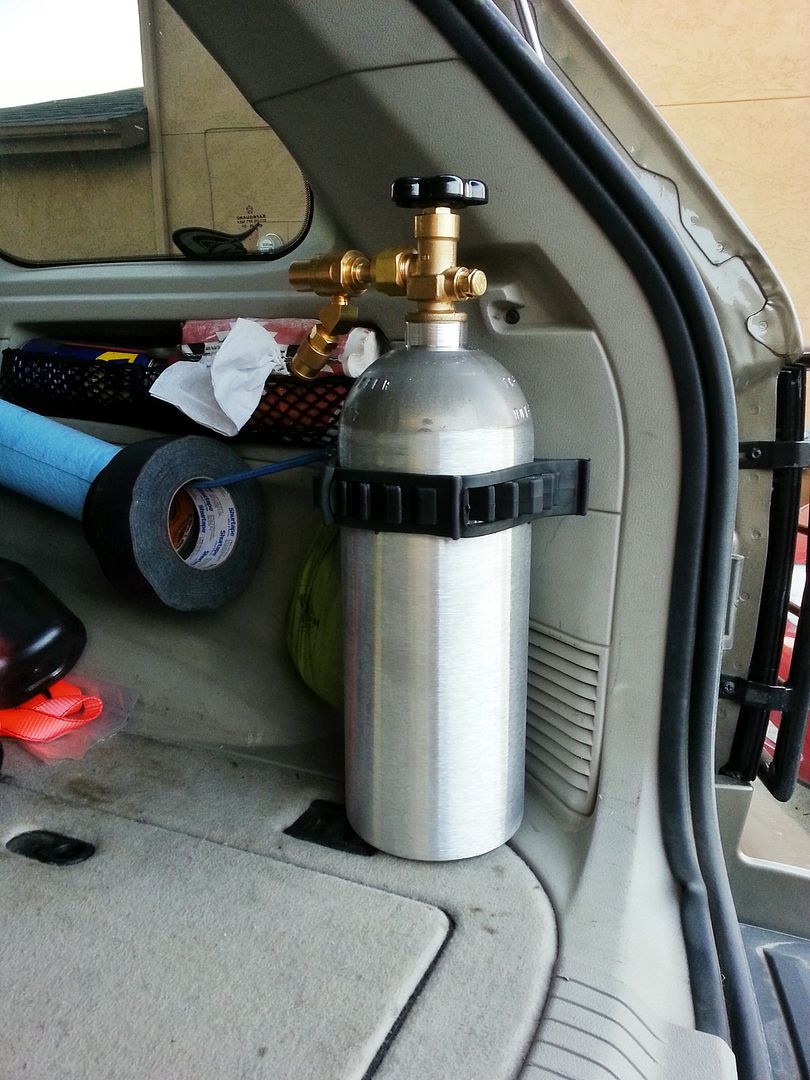

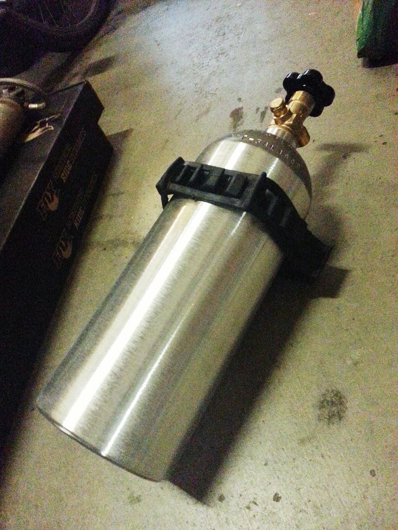

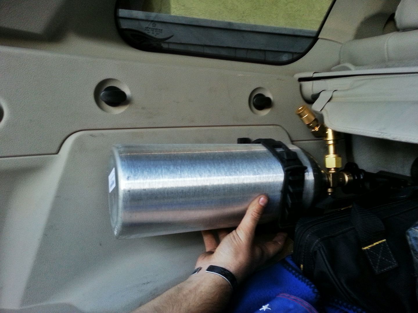

So another mod I'm working on is a CO2 tank! Yes I know I already have OBA, but I don't always like or have time to air up after wheeling especially when I'm with other guys who don't have any air source. So I finally decided to give CO2 a go. I didn't want to spend a fortune on any of those over priced name brand systems, but I didn't want something that was going to crap out on me either. So after some research and reading a lot of user reviews I decided to build my own. Since I already have a quality hose and air chucks all I needed was the tank, regulator, and a mount. I snagged a Quick Fist mount ($12) and a brand new 5lb aluminum tank ($50) off eBay.
Then grabbed a fixed 150psi regulator ($55) from The Source.
I still need to get it filled, but in the mean time I need to mount it. Now I am not planning on leaving it in the Jeep at all times, so at this point I am leaning towards mounting it on the passenger side standing up right. This way I don't HAVE to remove it to use it and it's in a good out of the way place.
However I am also thinking of mounting it on it's side against the driver side. It would still be mostly out of the way, but I would HAVE to remove it when I needed to us it and grab another $12 mount. The up side to this spot is I can still use the cargo cover (without modifying it)

Also why would you have to remove it to use it? Is it Because the valve?
