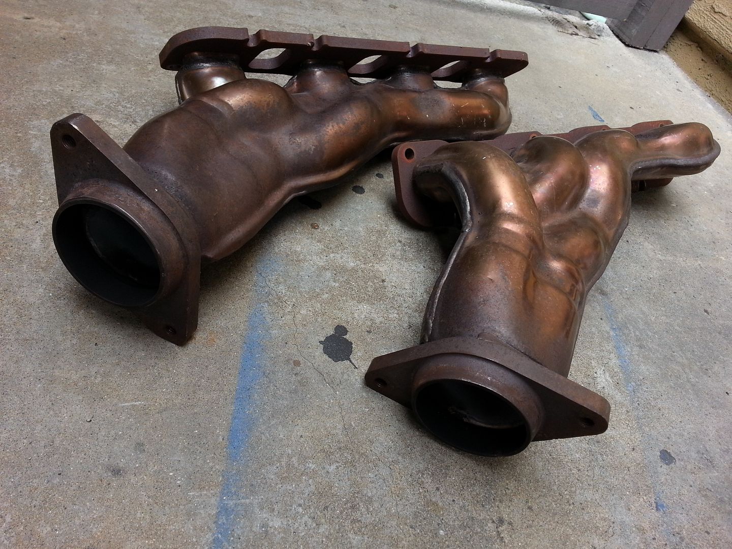

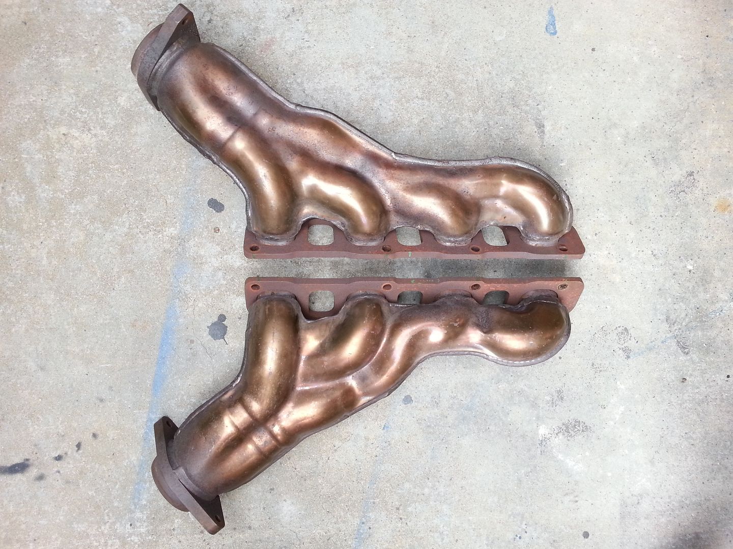

Well here they are! I scored a set of SRT8 exhaust manifolds from a member on another forum. I thought they were a steal of a deal at $130 shipped from the east coast!
I wont be messing with these right away, but it will be sometime this spring. I will be sure to keep the thread updated as I go. As of now I plan to use the stock mid pipes and have a shop change out the collector to properly mate to the much larger SRT manifold. Living here in Cali I need the Jeep to still pass smog, so I will be messing with the different EGR options. I will explain more on that later though. In the mean time live in suspense

Do you think you''l loose or gain power with those?

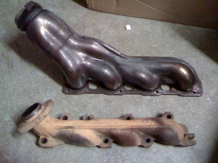

Oh it will definitely be an improvement! The stock manifolds are the biggest restriction in our intake or exhaust systems. Adding a CAI and/or throttle body will help improve your throttle response, adding a cat-back exhaust system will give you a better sounding Jeep, adding a programmer will enable everything to work together to give you a little more power and efficiency, but the manifolds are still going to be a bottle neck in the system. Even the stock cats are actually high flow units. I will post a pick of what the stock Jeep 5.7L logs look like compared to these 6.1L manifolds in a sec so you can see the difference.

Here you go! This is a WK 5.7L manifold next to a 6.1L:

Does the 6.1 bolt up to the 5.7?

Yes, the ports are slightly different shapes, but using a 6.1L gasket will work fine and create a good seal.
