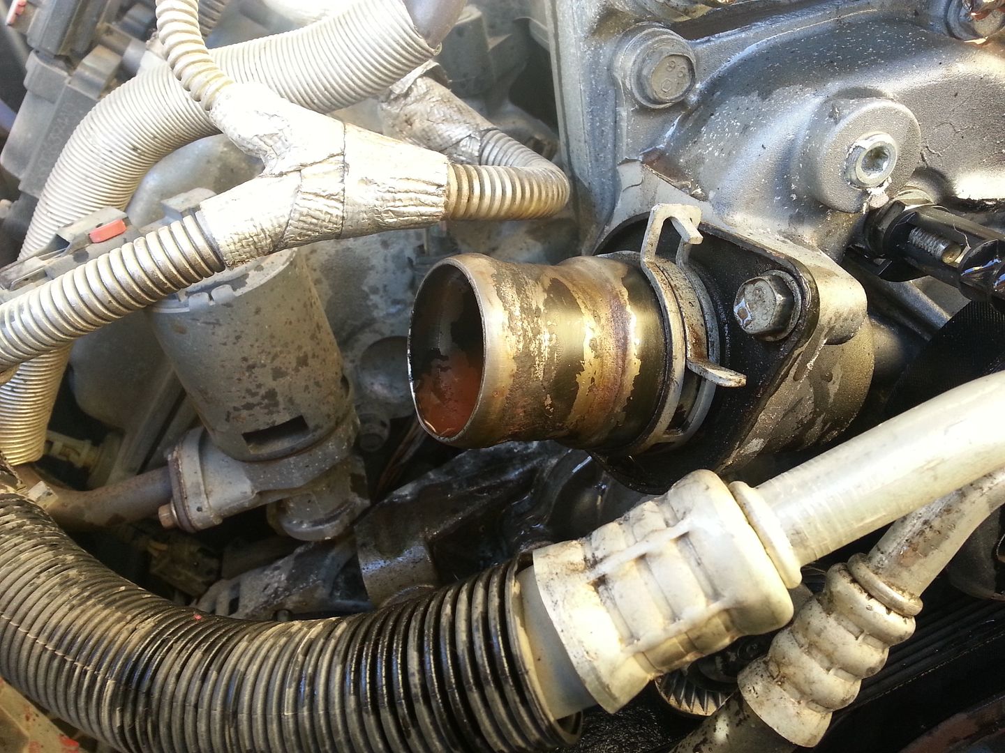

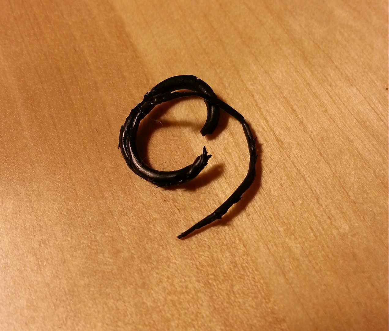

Well today I finally got around to replacing the O-ring in my power steering line that failed a couple months ago. This was what was left of the old one:
I will have to keep an eye on it to make sure there are no more leaks.

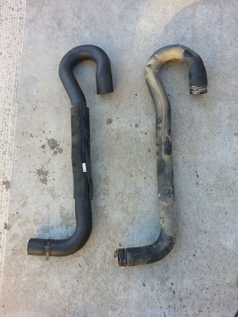

I also replaced my upper radiator hose. It has had a slow leak for a little while now. I scrubbed the thermostat housing because it was looking pretty crappy. I think next time I swap thermostats I will also install a new housing.
I also went through my suspension and re-torqued everything. My last outing wasn't exactly one with difficult off road challenges, but it sure did rattle the crap out of the Bison. Everything feels much better now! Though I still need to replace one of my uniballs. I did the driver side a while back and knew the passenger side wouldn't be too far behind.

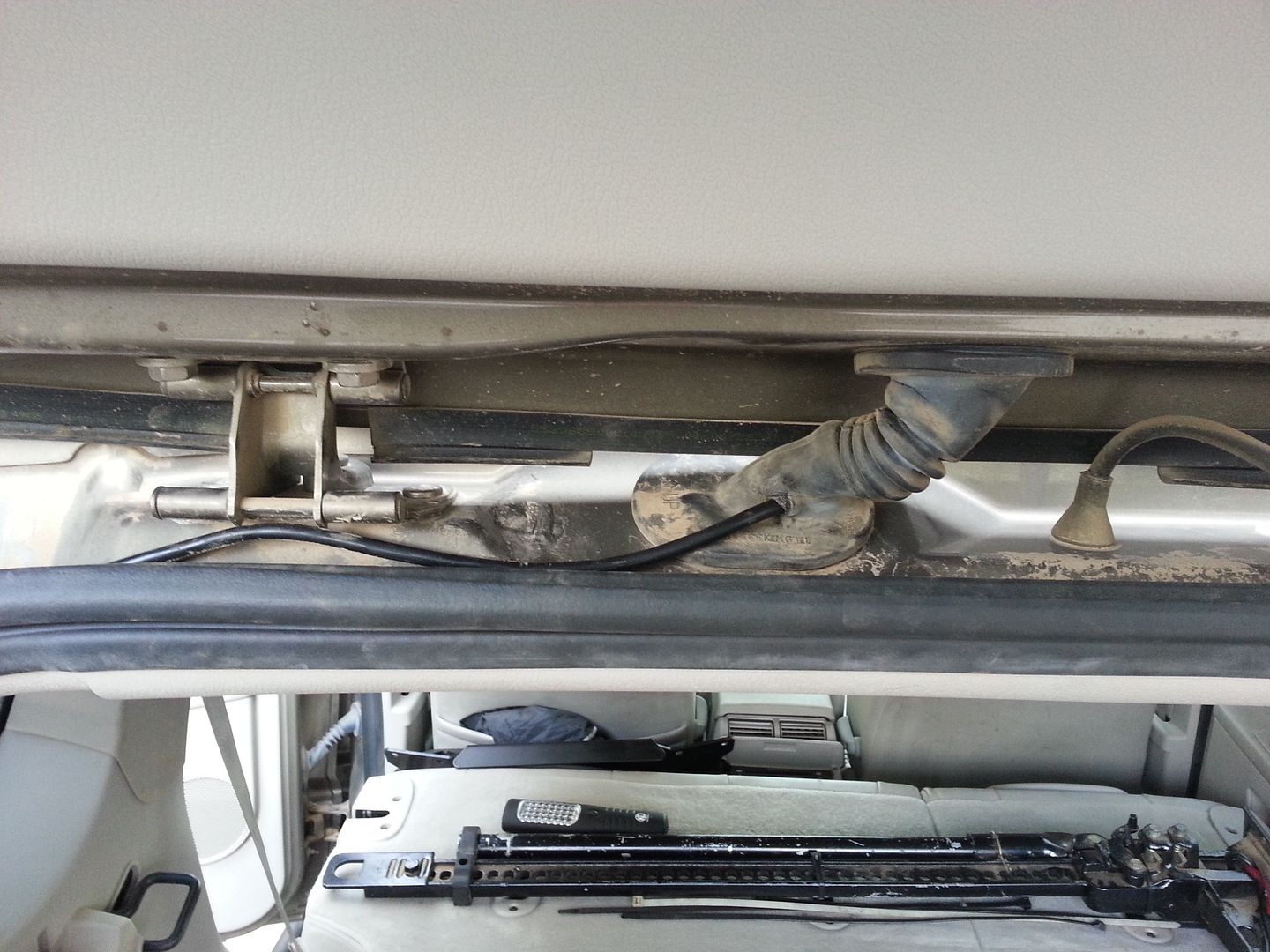

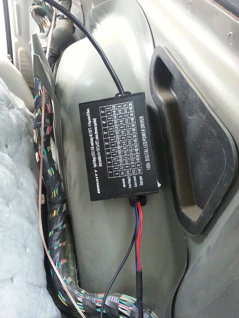

I finished up the wiring the other day, but never posted my last couple pics and info. I contemplated the wiring route for a while and finally decided to come down the back and enter the cabin with the hatch wiring.
From there it drops down the driver side behind the paneling which is where I mounted the power driver:
From the power driver the wires go straight to the front of the Jeep behind all the paneling. It all pops up behind the dash where I have the rest of my wiring. Right now the "Rear Light" switch I was using before in my switch panel is still used to turn the light on and off. Then there are two small switches in the cubby for "Intensity" and "Strobe" functions. Those are just temporary so I have full function of the light while I weigh my options.
This thing makes a HUGE difference while backing up at night in a dark area! With the tinted windows it is often difficult to see. The Cree reverse bulbs helped out a lot, but when you need more light this bar just blows the Hellas out of the water I need to do a good head to head comparison between the 40" and the new 19", but first impression, I think they are very close! I'm hoping to get some better night shots this weekend before I have to leave again...

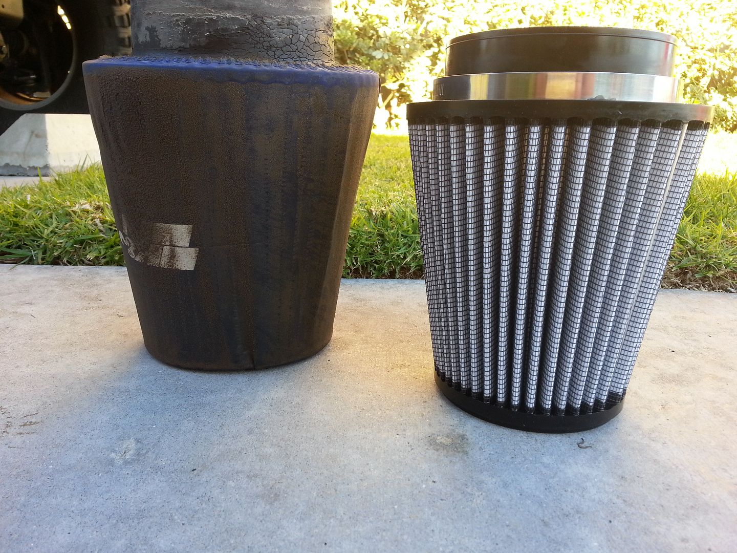

Today I got an unexpected package! I had ordered a new air filter off eBay. I bought it from Summit Racing, but off their eBay store where it was the cheapest price with free shipping. I wasn't expecting it until next week, but it apparently shipped out of their LA warehouse. Anyways, I have had my Volant for almost 4 years now, I have refreshed the filter a few times and it is now looking a little too weathered. Instead of picking up another Volant filter I decided to get an AFE Pro Dry filter.
The Volant with the K&N DryCharger on it caked in dirt from my last outing:
You can see here how weathered the Volant filter has become:
The new AFE Pro Dry filter. I searched through all their dry filter they make and this was the closest one that would fit. Turned out to be the one in the Hemi WK kit they sell PN: 21-45003
As you can see the AFE is just slightly smaller than the Volant, plus the end is capped unlike the Volant. Considering the Volant was actually designed for the 6.1L Hemi it way over flows the 5.7L, so the slightly smaller AFE will do fine:
Once I thoroughly cleaned the K&N DryCharger and let it dry I wrapped it around the new AFE filter and installed it into the Volant intake:
Now as you can see my intake is very confused Volant, AFE, and K&N all in one!!!

You need a snorkel my friend That K&N is doing a lot of work!

I know! I want one but either some one else needs to make one or I need to find an AirFlow snorkel for dirt cheap. I'm not too keen on the AirFlow and my wife refuses to allow it on the Jeep I have thought about making my own out of fiberglass, but it's not high on the list of things to do.
