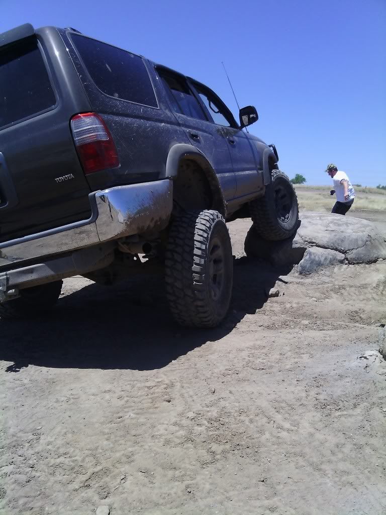

Has anybody seen this front "leveling kit"? It's states as a 2.5" kit but doesn't look close to that at all. Thinking about this kit for my modified OME.
My buddy has tundra struts on his 4runner which is basically similar to our OME and has a 1.5" strut spacer on top and has about 4-4.5" lift. His CV angles are a little extreme but it works and does pretty well.
I know everyone advises against it but I kind of wanna try a similar setup and see what happens.

You have to remember that the front strut spacers adds about double its thickness. .25" adds about .5" and so on.

Totally aware. I meant they label it as a 2.5. It only looks about .5" thick.
^^^ Your cv's and rack will be screaming if not fail.
