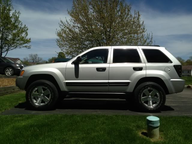

CCUMP
Join Date: Jun 2013
Location: Morgantown
Posts: 24
This is my 3.7L with the MLL, RC, and Blisten HDs
