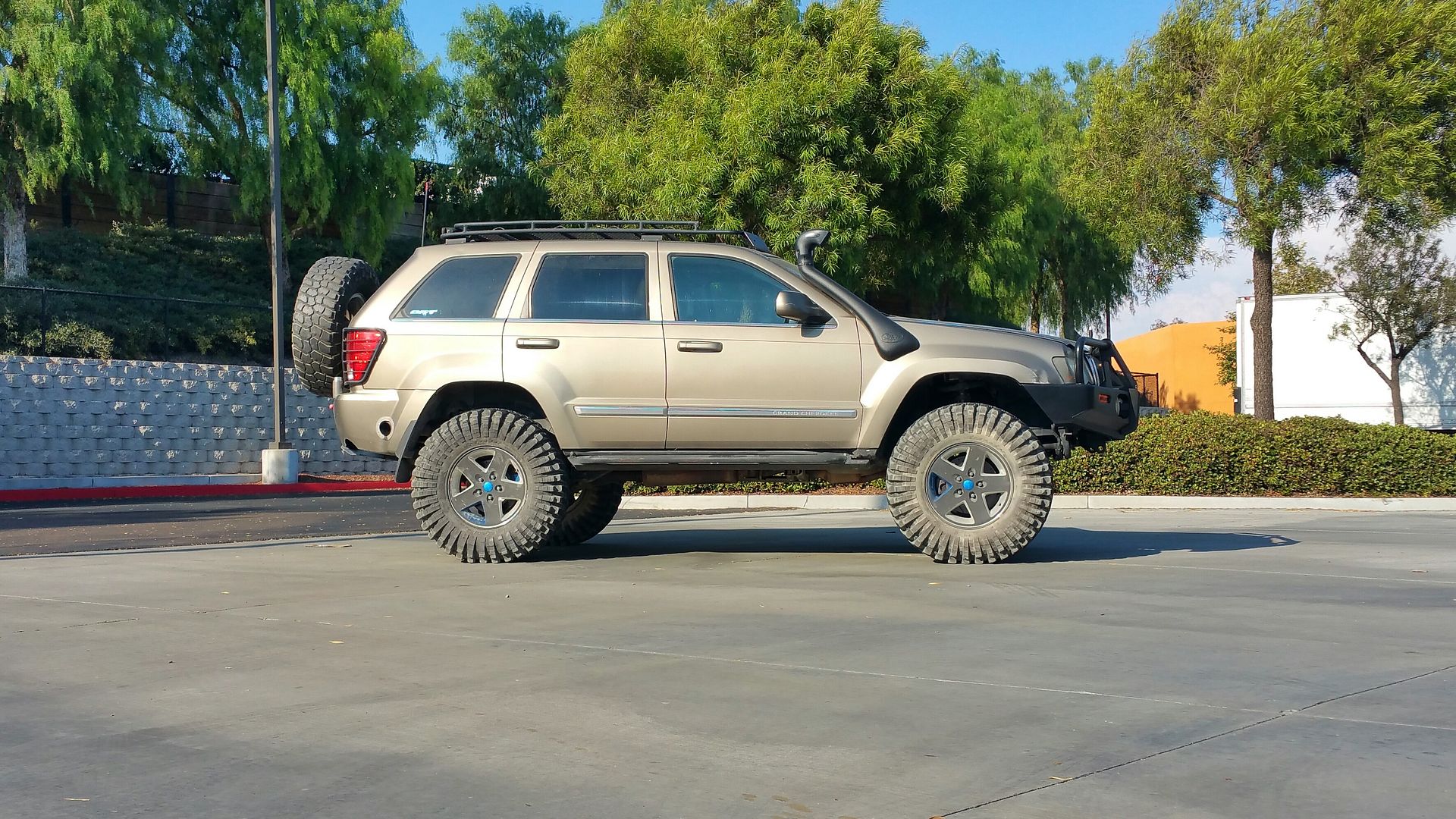

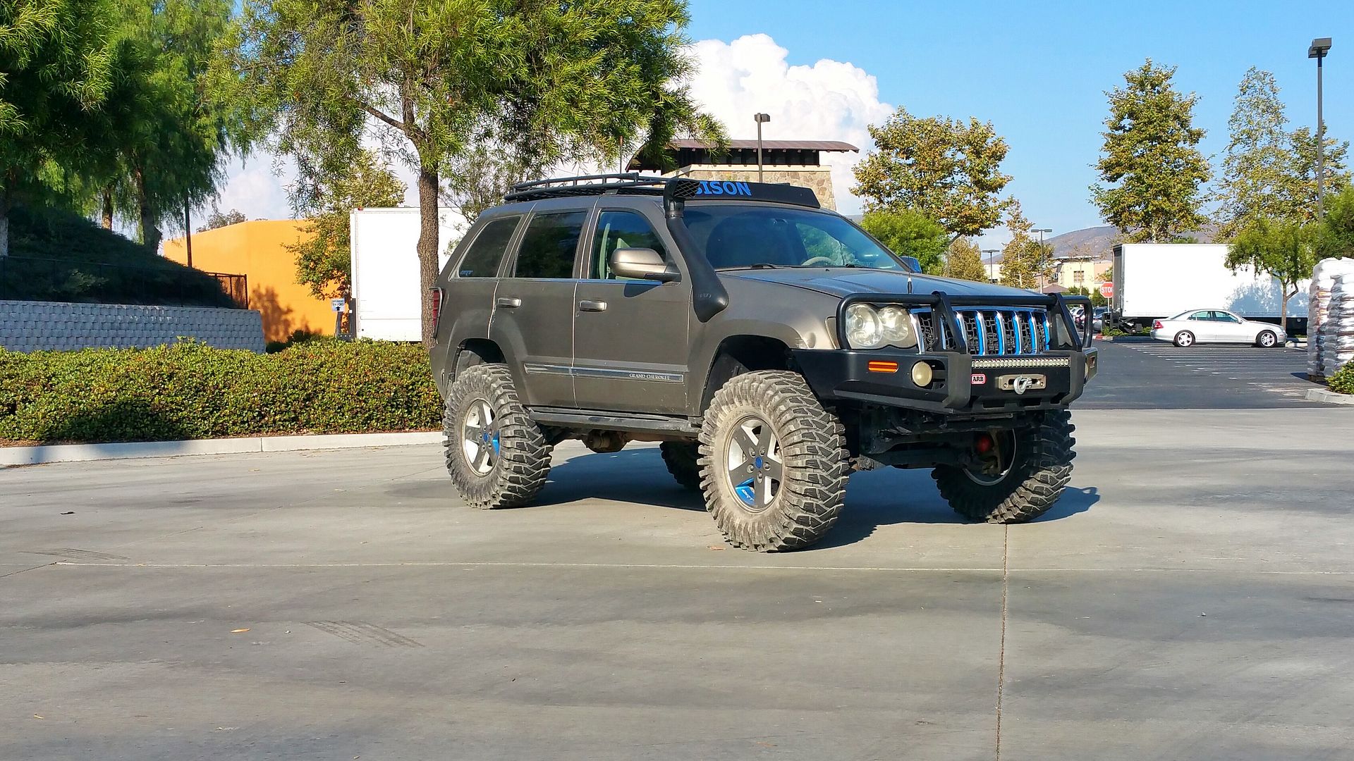

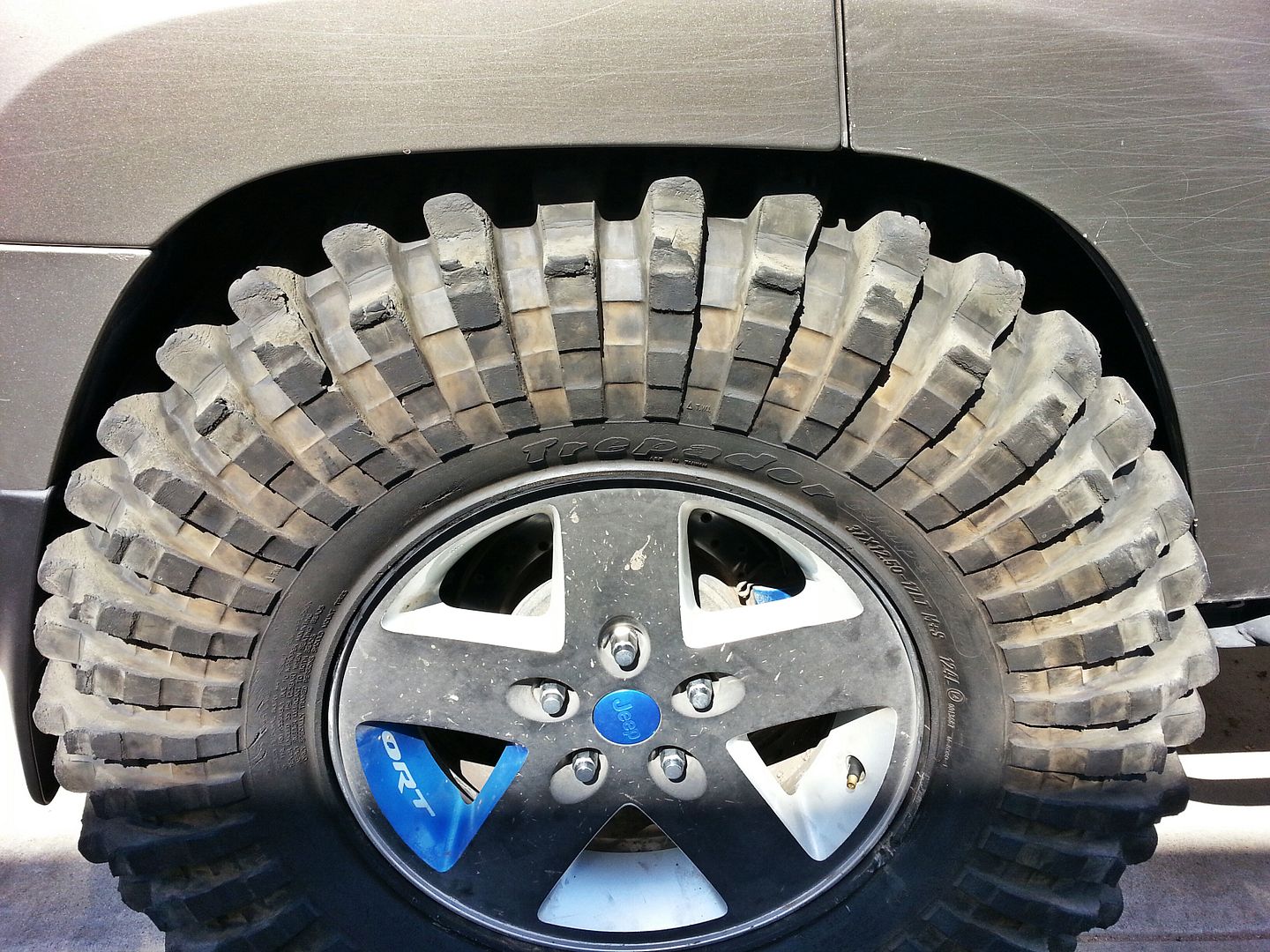

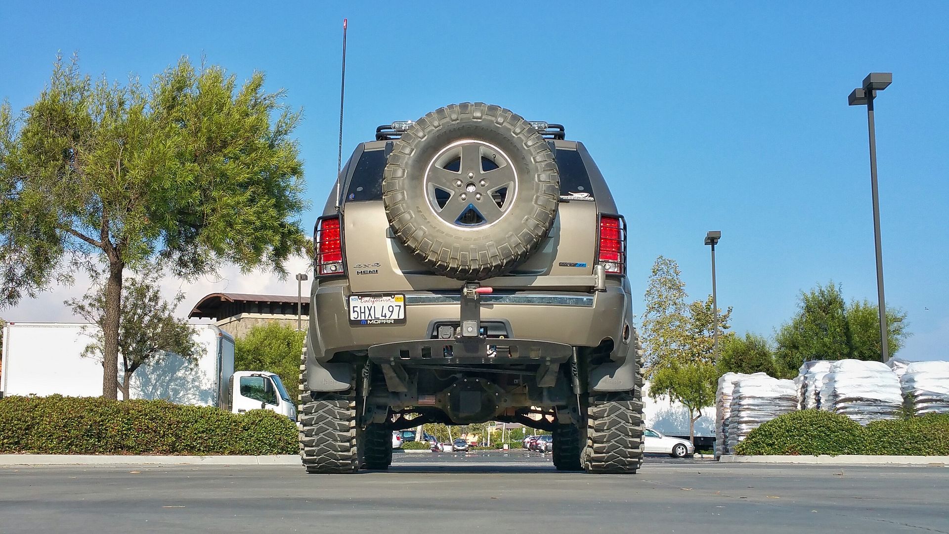

35's without the superlift is really asking for trouble honestly. Omelet ran his that way IIRC and blew cv's and his steering rack atleast.

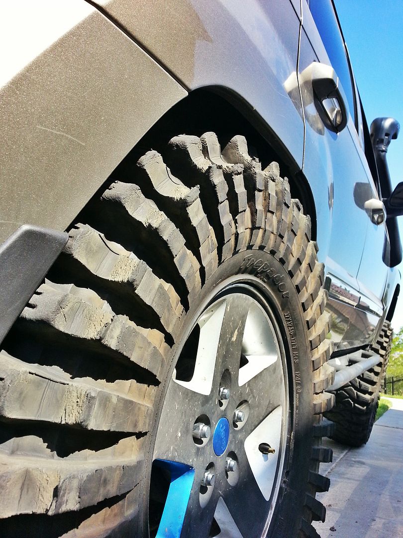

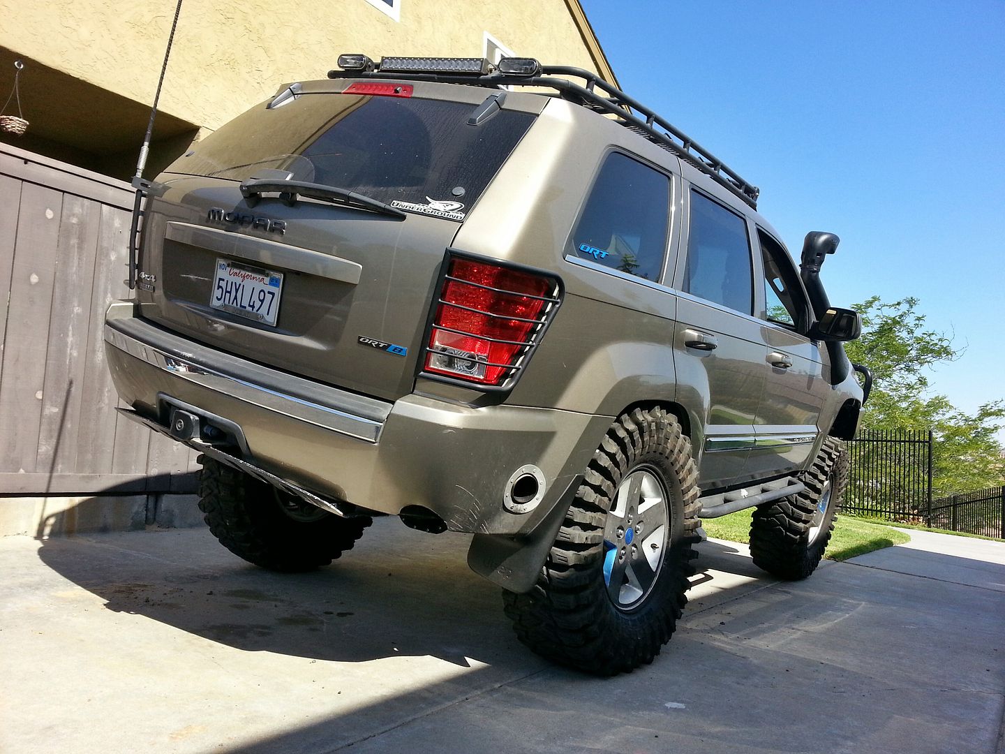

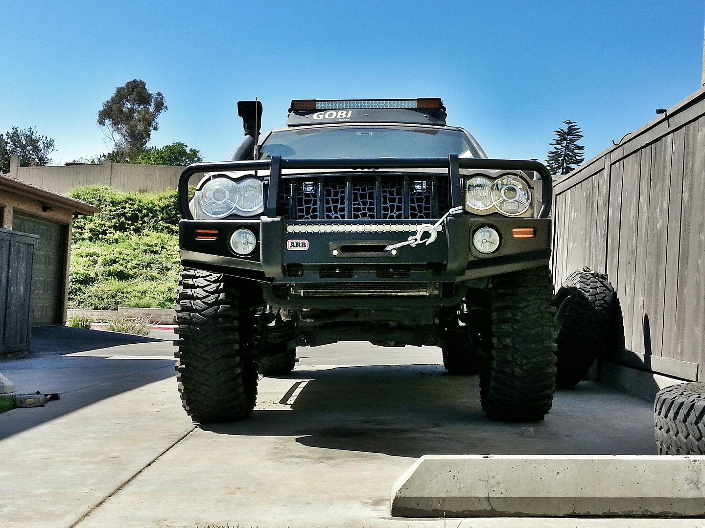

Omelet on 37" trepadors:
http://www.jeepforum.com/forum/f67/o...l#post32061794

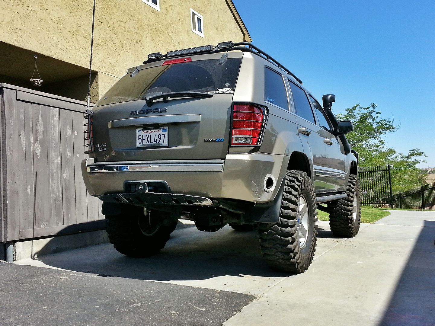

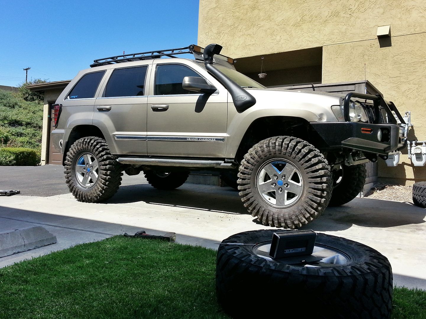

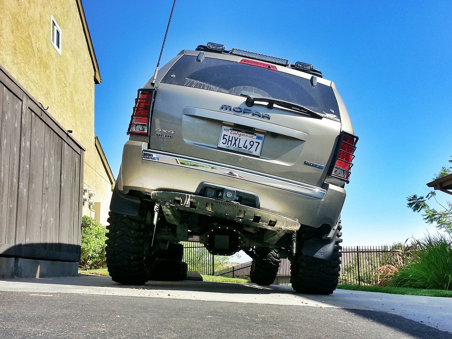

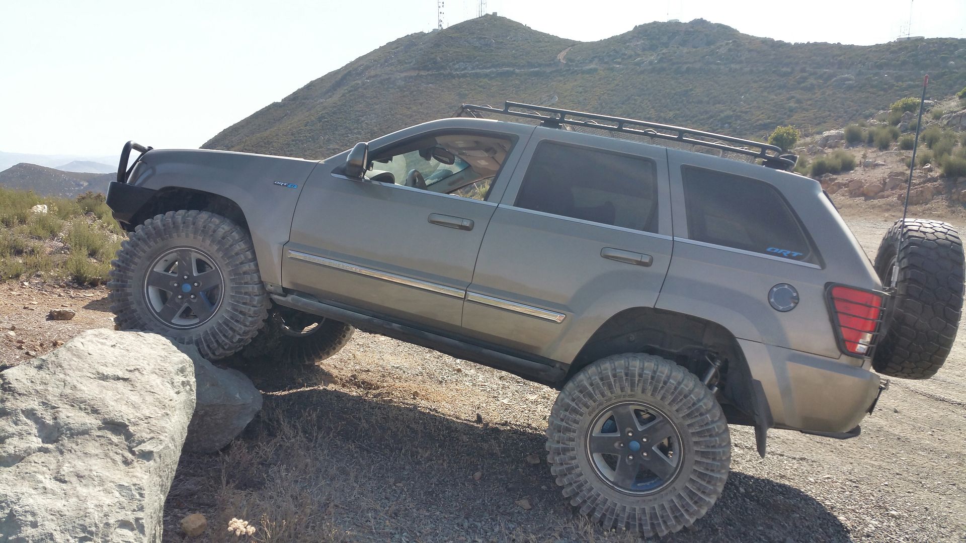

Originally Posted by Omelet View Post
I swapped out tires a few weeks ago and went on a quick drive up Otay Mtn to test flex the 37s. Unfortunately I got up there and everything but the main road was blocked off So the only thing I found was a large rock on the side of the road. I was able to flex it enough to see that even though the rear bumpstops were engaging, they needed to be slightly longer. That way if the tire had a lot of weight on it the tire wouldn't smash into the fender causing unneeded resistance and possibly damage something.
And then just some scenic shots on the way back down. It was really hot that day so I didn't really want to be out there any longer than necessary.
Some glamour shots! Enjoy!!!
(yes I know the headlamps need some TLC)

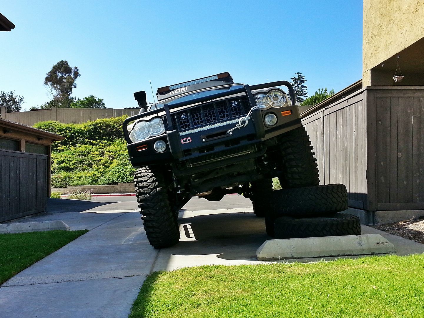

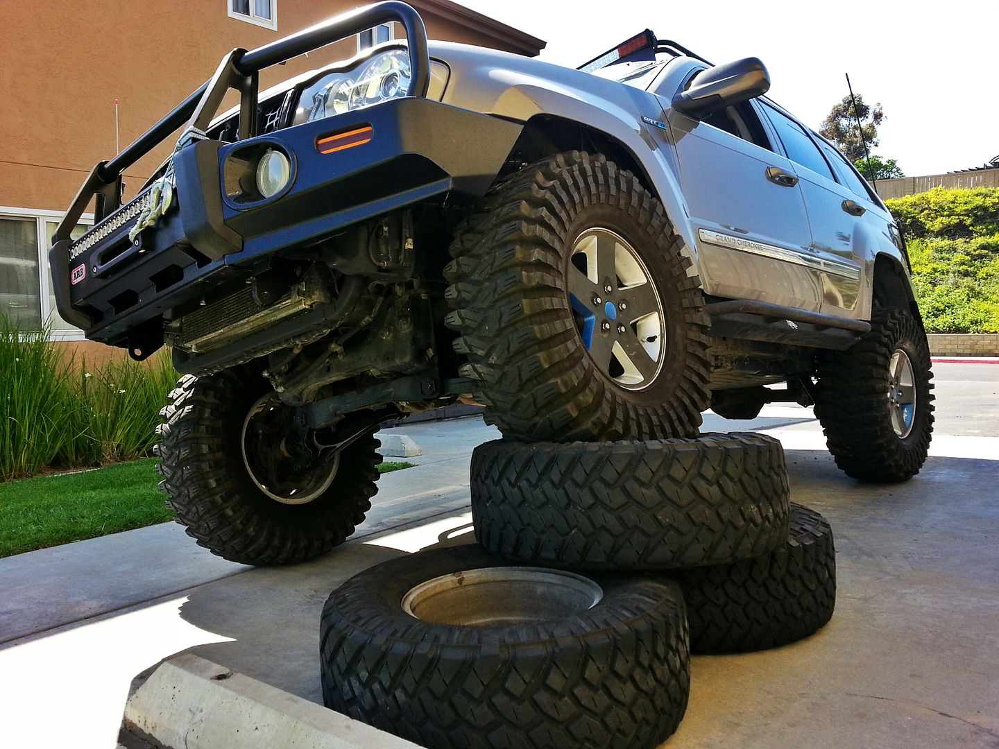

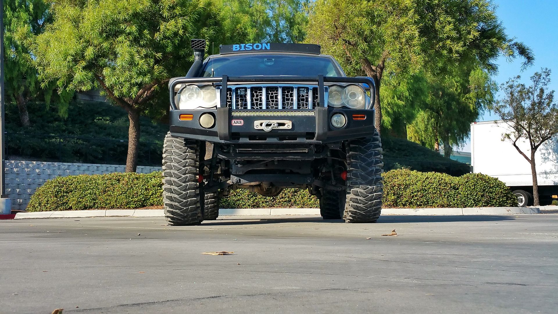

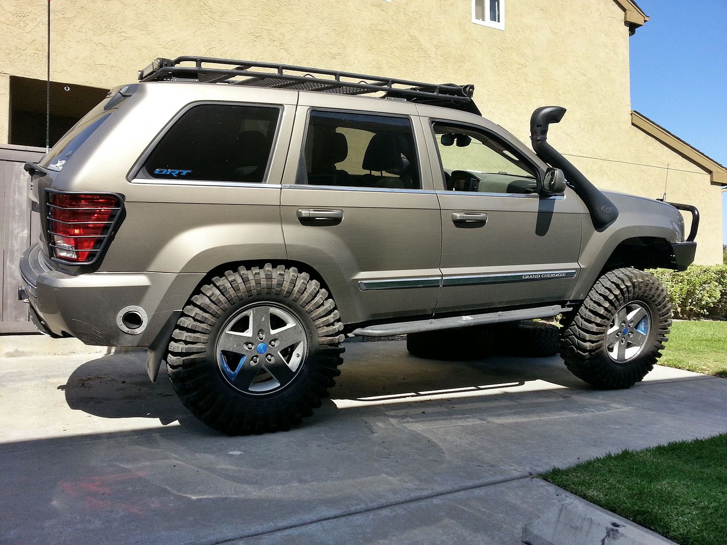

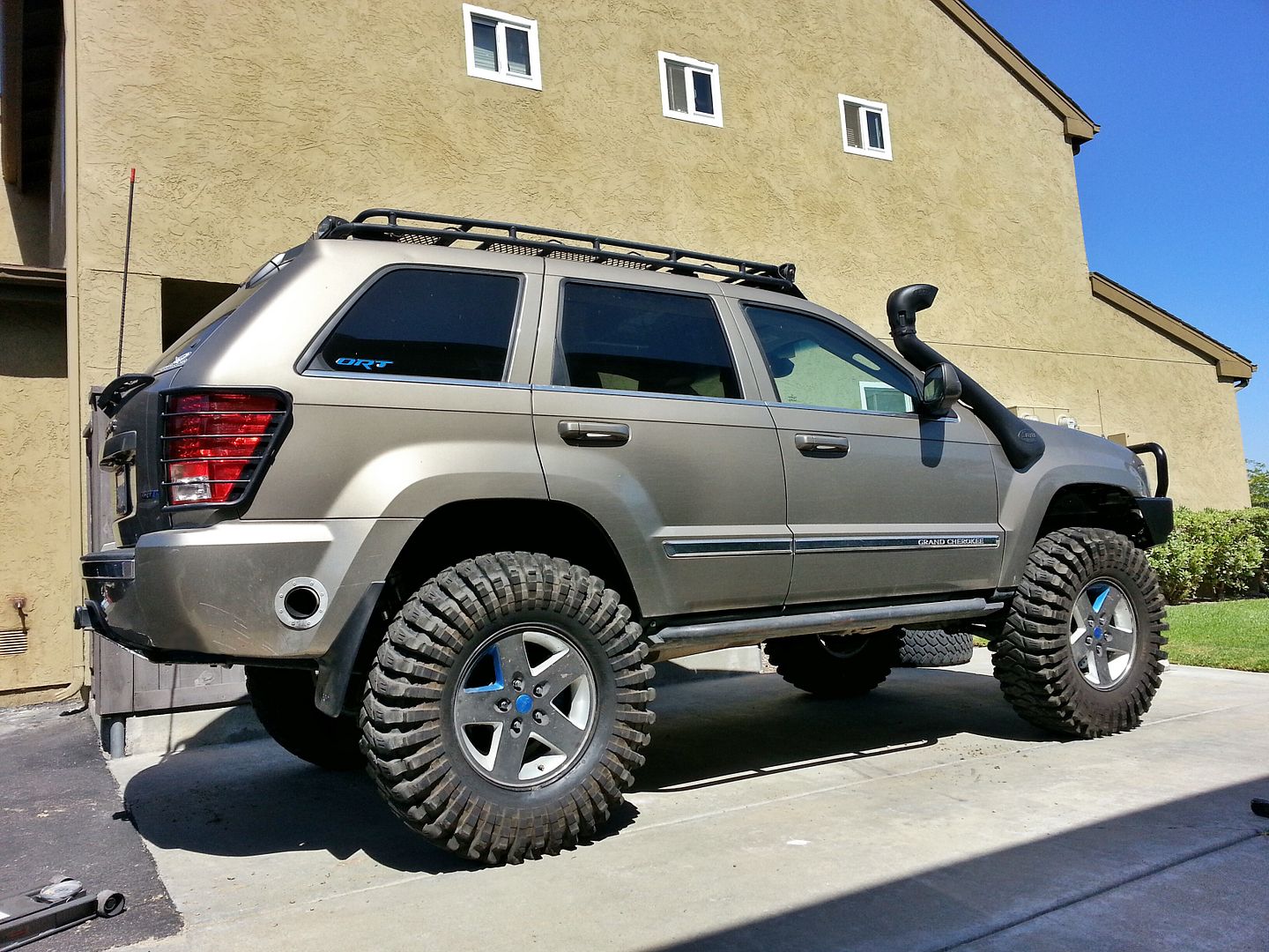

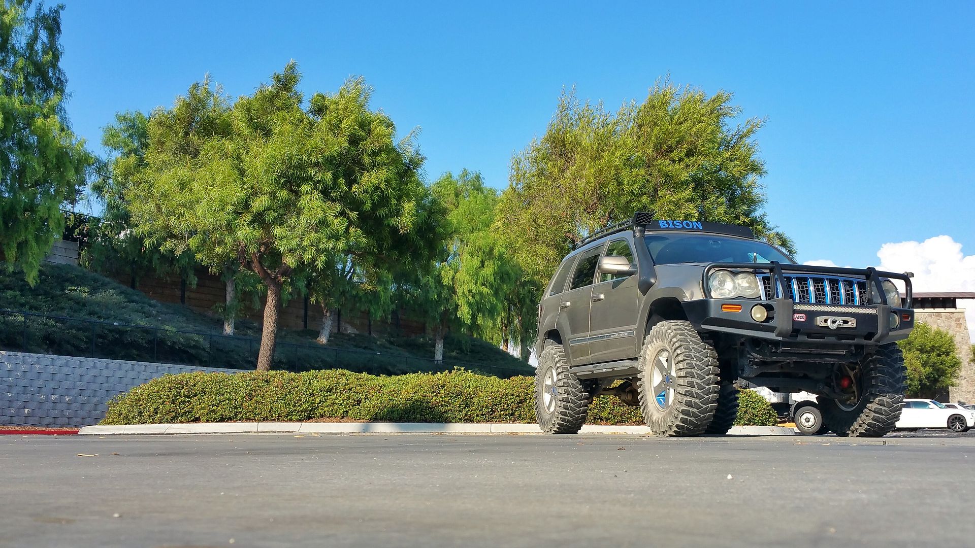

The Bison slipped on her new 37s the other day! These make the Jeep look huge!!!
Then I wanted to flex it out to see how they fit and what massaging and/or bumpstop work I needed to do before hitting the trail. All I had to use were my street tires It didn't completely max either end, but I was at least able to see what I needed to do.
The rear was quite tight. No surprise there!
Have fun reading through omelets crazy long build thread.
