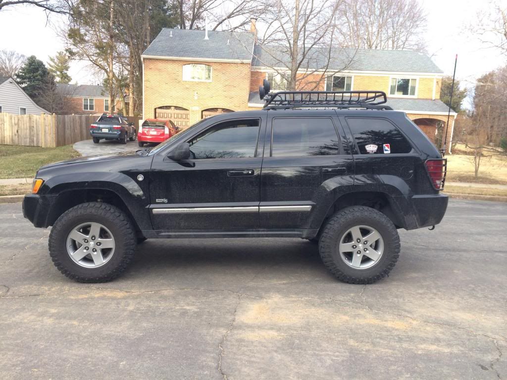

OME HD coils
Rusty's rear spacer
5100 rear shocks
Stock front struts
23" rear, just under 23" front
285 Duratracs
It's not difficult to get the rear spacer in since the coils aren't longer than stock. I don't think a compressor is even needed for the rear, just drop the axle.

Was hoping you were going to chime in! Looks great. Do the rustys spacers go below or above the rear coils?
Seeing your Jeep, and being just under 23", makes me think that the adj 5100's up front will push me over that 23" mark

Thanks man! My Rusty's spacers are above the coil, but I think you can put them below if you want to. It shouldn't matter. Also, if you add front armor or a matrix, then it should weigh it down enough with the 5100's, HD coils, armor, and that big Hemi. If you don't plan on adding much to the front then I'd say go MD coils.
