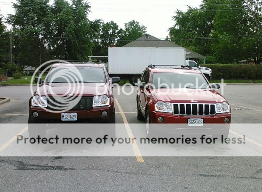

Couldn't resist a little stocker stalking in the parking lot:
